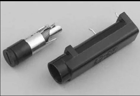

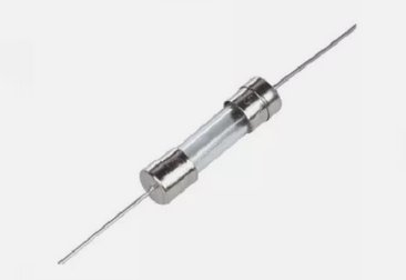

Analyze the potential path of any shorted component. Does it have a direct path to ground? Tube rectifier, or SS bridge? Parts can fail without generating excess current. Just depends on the circuit type. Use components that have some ratings headroom and it will be reliable and simple.

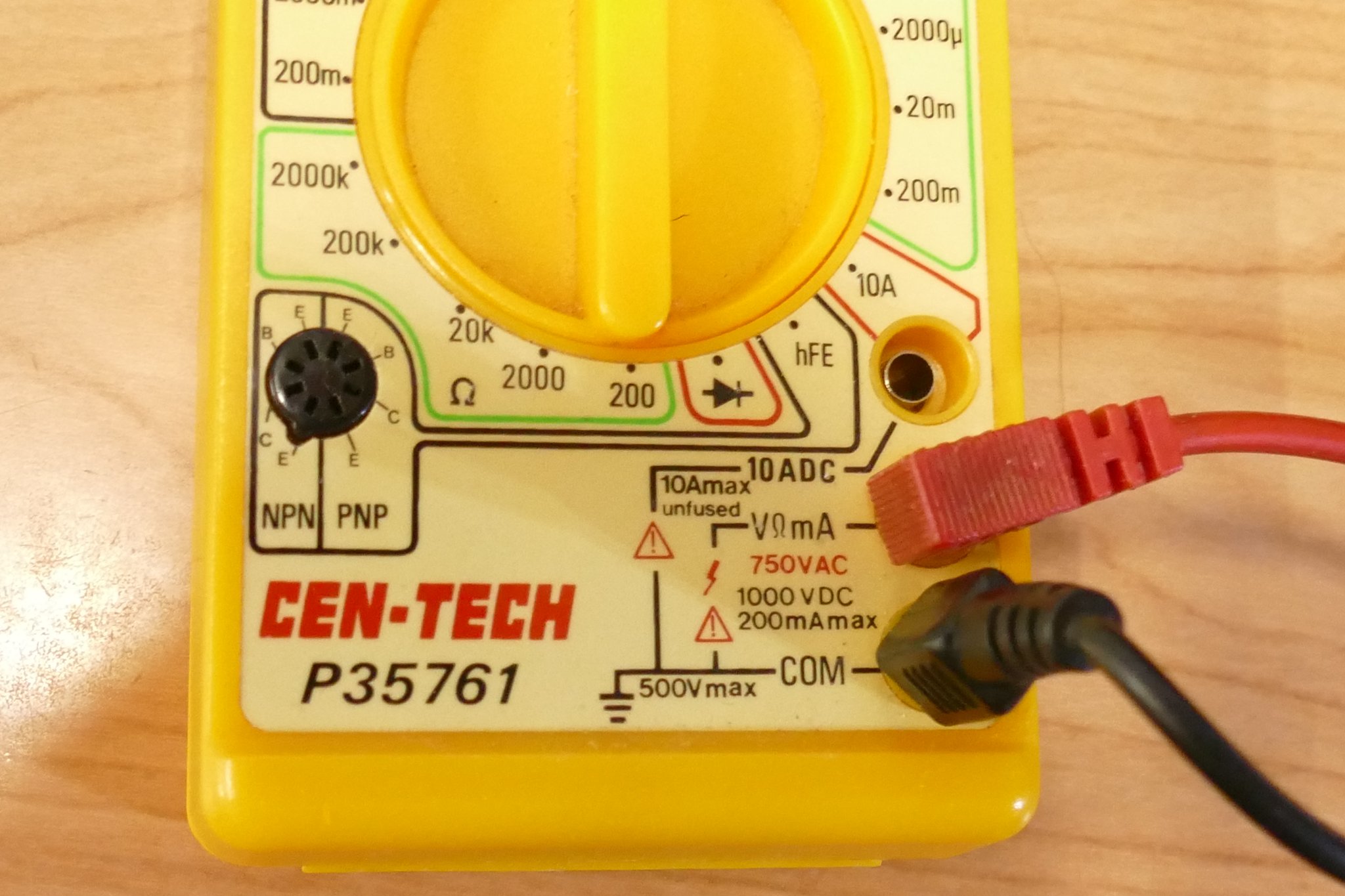

I have seen the typical 250 volt 3AG fuse explode rather violently when exposed to a direct short on the secondary side of a 375-0-375 volt power transformer. This was provoked by a dumm blonde poking around with a cheap meter that had the red lead accidentally plugged into the 10 Amp jack (top) rather than the V-ohms-mA jack(middle). The fuse was wired in series with the CT on the HV winding. After that experience, I no longer fuse the secondary side of the transformer.
I have never seen a plate to plate short happen in a rectifier tube that had not been physically damaged. Plate to cathode shorts in a 5AR4 are rare but can happen. Plate to filament shorts in a DH rectifier like a 5U4, 5Y3, or 5R4 are NOT uncommon. The filament eventually goes open, usually at the turnround point leaving an unsupported end free to touch the plate. This will feed raw AC into the input filter cam making it rather unhappy. In a properly fused tube amp this SHOULD blow the primary fuse with no collateral damage. Often the filter cap will survive.
My exploding fuse and other experiments were done on a Tubelab SSE. I determined that a 1.6 amp slow blow fuse in the primary circuit was the bare minimum that would live on my 125 volt AC line in Florida. It was so close to the edge that an ocasional nearby lighning strike to the power lines would blow the fuse. I usually recommend a 2 amp fuse in 120 volt countries and a 1 amp fuse for 230 / 240 volt countries.
NEVER use an AC rated fuse on DC. They WILL violently explode and sometimes create a large fireball when they go due to a continuous arc that does not extinguish 100 or 120 times per second.

Then use enclosed fuse holders
or
simple pig tail fuse holders and heat shrink tubing
But if there's enough energy to rupture the glass or ceramic casing of the fuse, why would the fuse holder do much more than provide a bit more mass flying around inside the amp enclosure (or the room if the enclosure doesn't have a bottom panel)?

I used the meter in the picture to measure the DCR of one half of the secondary winding of the power transformer I commonly use at 62 ohms. The 115 volt primary winding is about 2 ohms, probably a bit less due to the resistance in the cheap meter leads. This puts the short circuit current in the 6 amp range for the few milliseconds it takes to vaporize the thin metal strip inside the glass fuse. This can create a very short pulse containing about 2 KILOWATTS of energy, quite a bit more if the short happened to occur at the peak of the AC half cycle. Odds are that the short occurred at a lower power point in the AC cycle, which is why sometimes things explode, sometimes they don't. DC is constant and once the short vaporizes the thin strip an arc can start through the cloud of vaporized metal. With no zero crossing to quench the arc, an explosion is likely. There are some sand filled fuses that do not explode unless subjected to something extreme like being zapped with a cardiac defibrillator, in which case you get a real big bang!
I tend to use generic fuses obtained from surplus houses with unknown specs. As mentioned, the bang created by an exploding fuse can usually be contained in a piece of heat shrink, but powdered glass can still be dispersed.
I did find some 500 mA fuses with ratings that would indicate that they are suitable for use on 500+ VAC at hundreds of amps, but they are several dollars each. I have never tried any of these.
