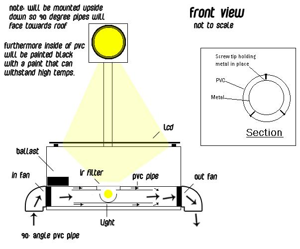

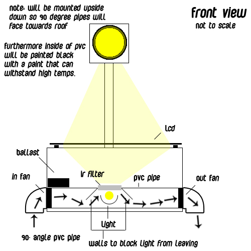

Yea it would be bulky but it would be more vertical and lighter to I can mount it to the roof in my room. I dont agree with mirrors as they can easily degrade quality even with a Front surface mirrow as it has to be exactly at 90 degrees. and I had some ideas for the heat. I was thinking about putting the halide infront of a reflector and then mount it in a large pvc pipe and then cutting a hole with a hole saw in the pipe then cover the hole with pelxiglass and put a fan and both ends and maybe painting the inside of the tube black.
Heres the idea I was planning on using.

Sorry I shouldn’t just slam an idea without giving a suggestion. Painting the PVC with black heat proof paint wont protect the plastic. Infact black will make the plastic absorb even more heat. I’m not against plastic, I’m using it in my projector but it has to be isolated from most of the light. Use a metal sleeve to encase the lamp, something like a piece of round metal down-pipe, 20-30mm smaller in diameter than the PVC. You could hold it in position using some wood screws. This would isolate the heat to the metal jacket and allow you fan to remove the heat.
