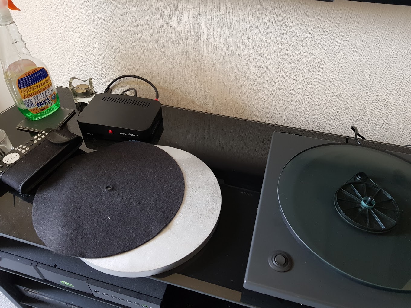

I took it home and cleaned it up, I happen to have a Planar glass platter here so popped that on top.
The "Goldring" MDF platter is silver but not to my taste so I will paint that matte black and swap between the Glass/MDF depending on how they sound.

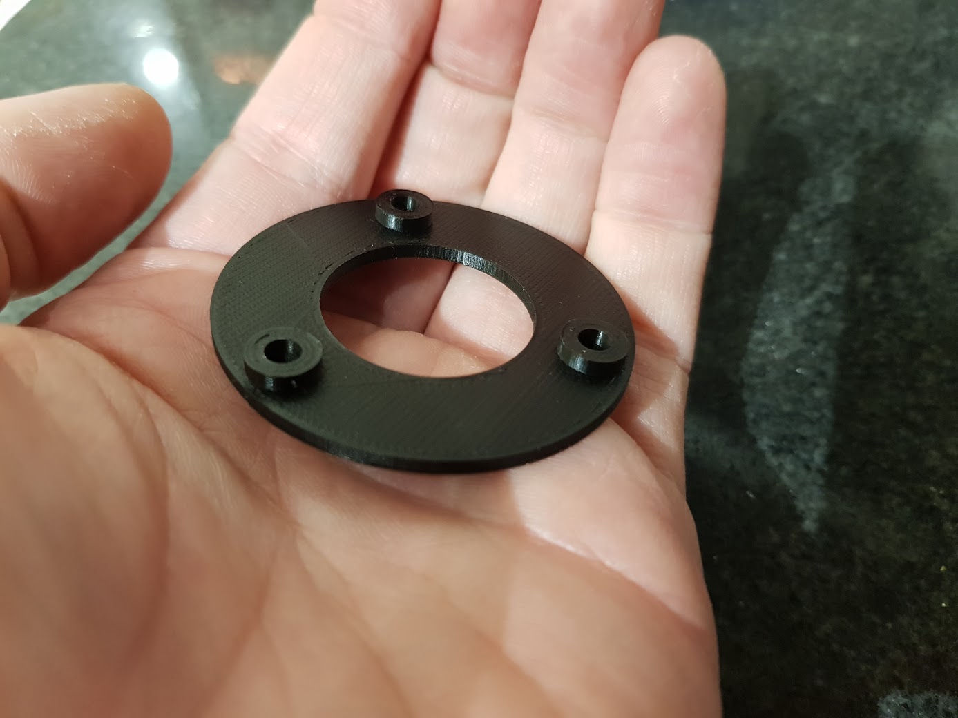

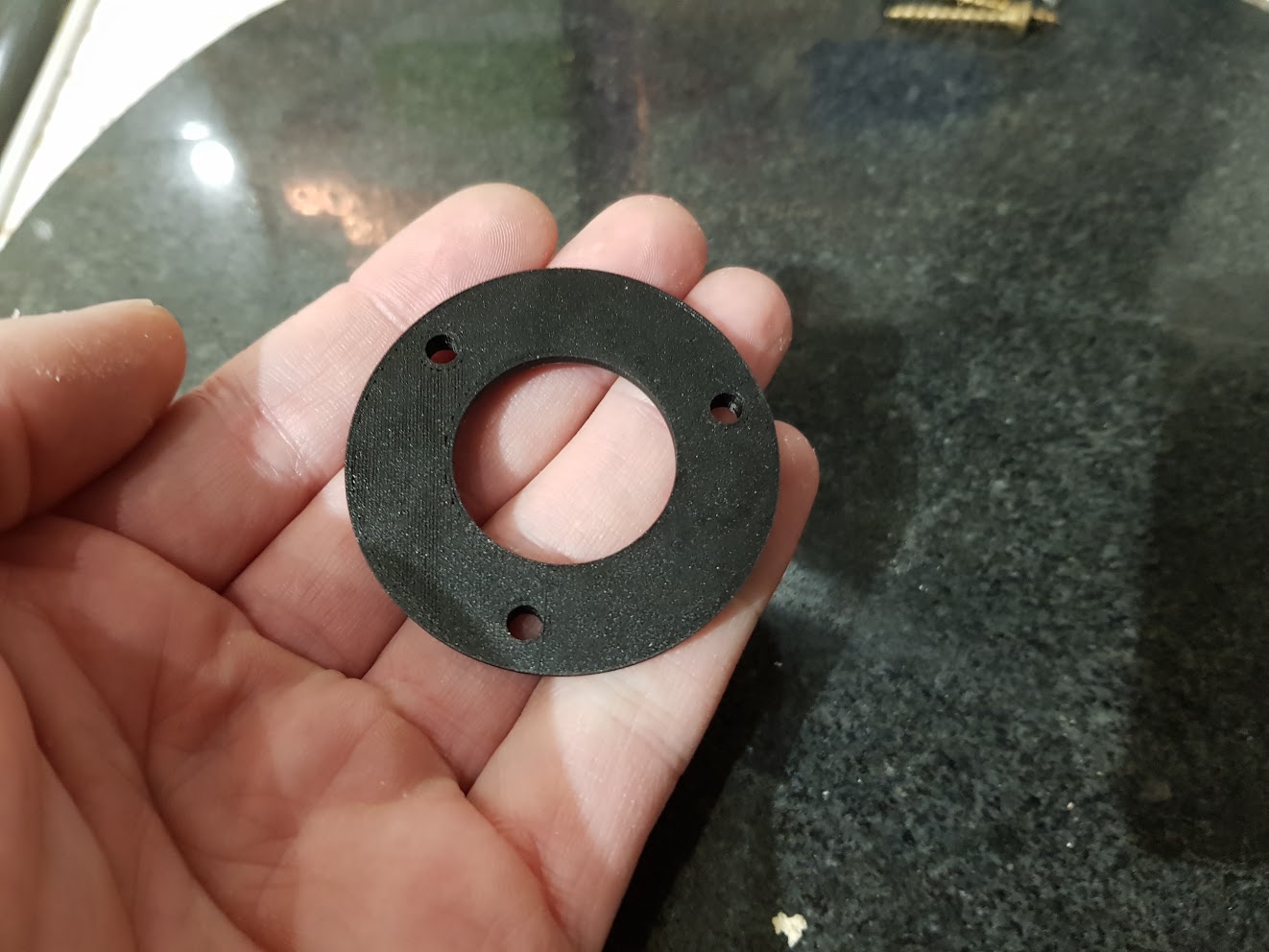

To fit the Planar 3 glass platter I need to adjust the VTA of the tonearm, this is easily solved so I 3D printed a spacer.

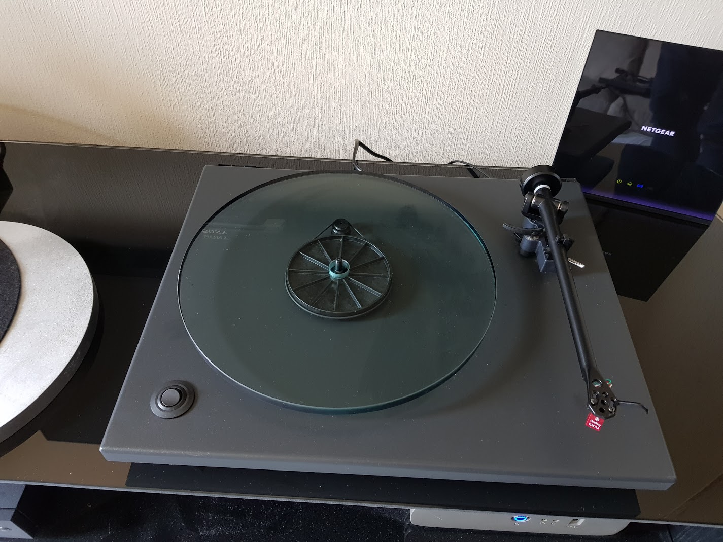

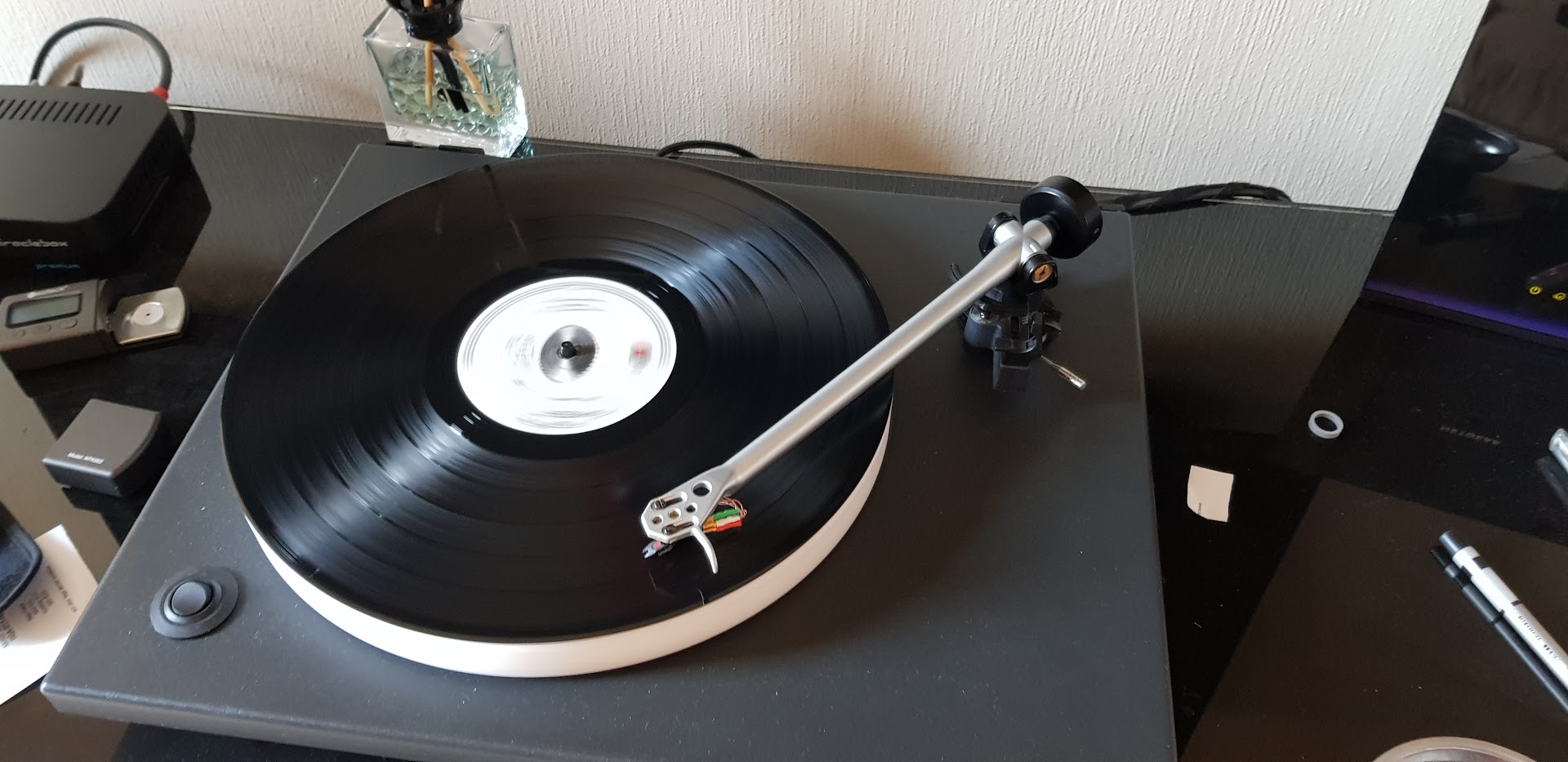

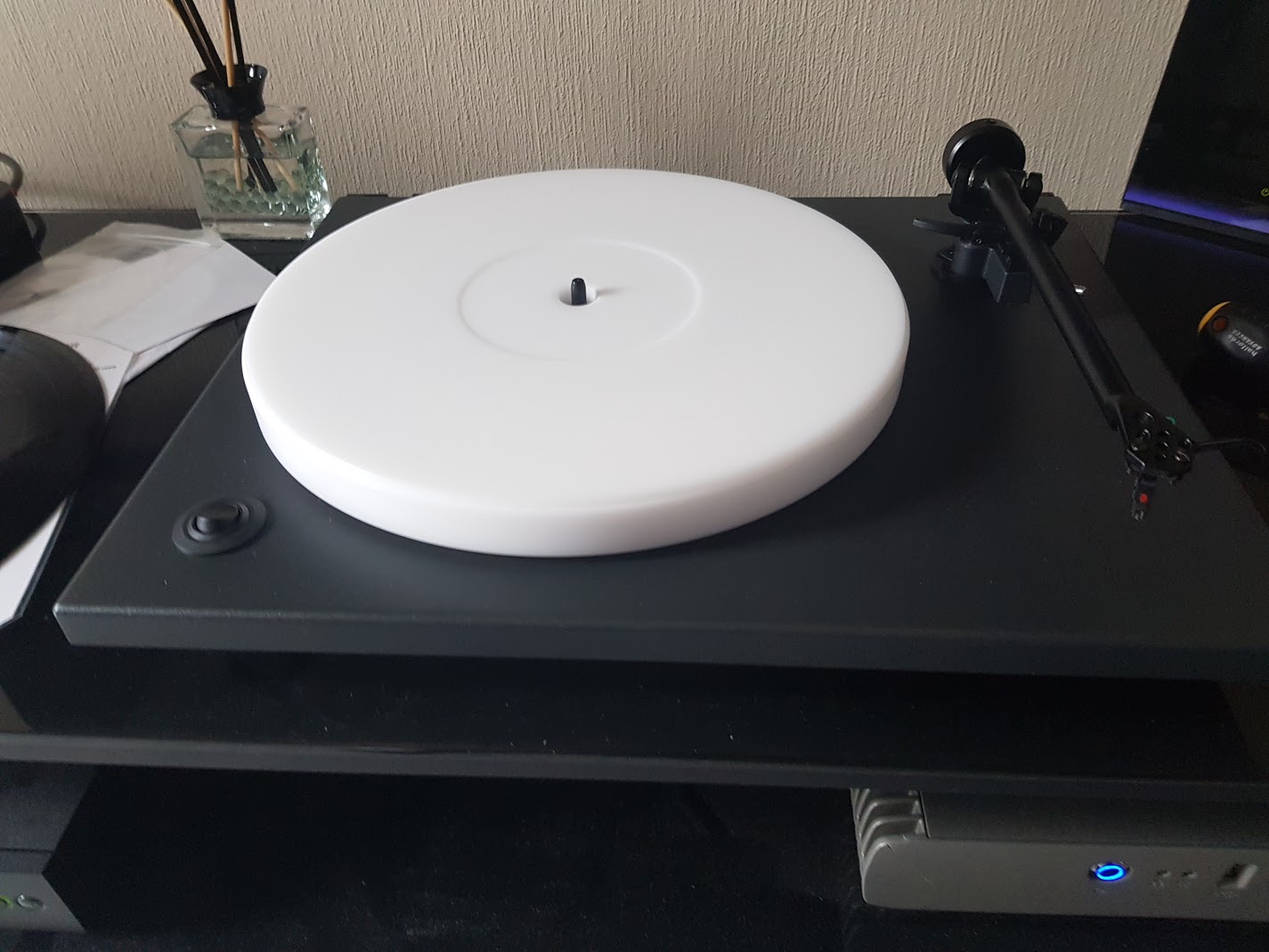

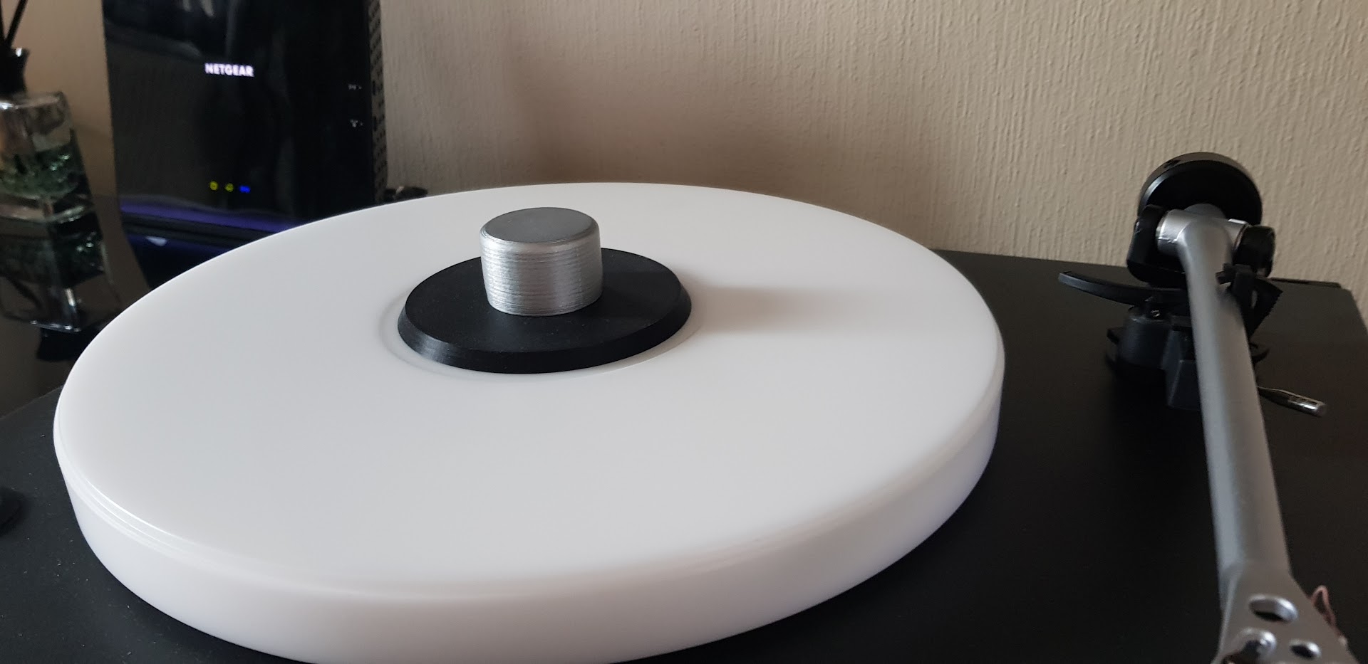

Ordered a replacement belt and everything seems to be working okay with this turntable, so decided to start some mods.
Not really a fan of the glass platter, although an improvement I wanted to upgrade to something else.
So I ordered a "Delrin" platter from Ben @ Fidelity Designs LTD fidelitydesignsltd.co.uk - Home, nice chap and great service.
I opted for the 26mm White "Delrin" platter and absolutely blown away with the quality of this, you cannot see it moving when the platter is spinning.
As you can see in this picture I have Ortofon OM Series Cartridge on there, the Stylus on the Goldring Elektra is worn, so put this OM series on there to use it for
now until I decide what cartridge to order for it.

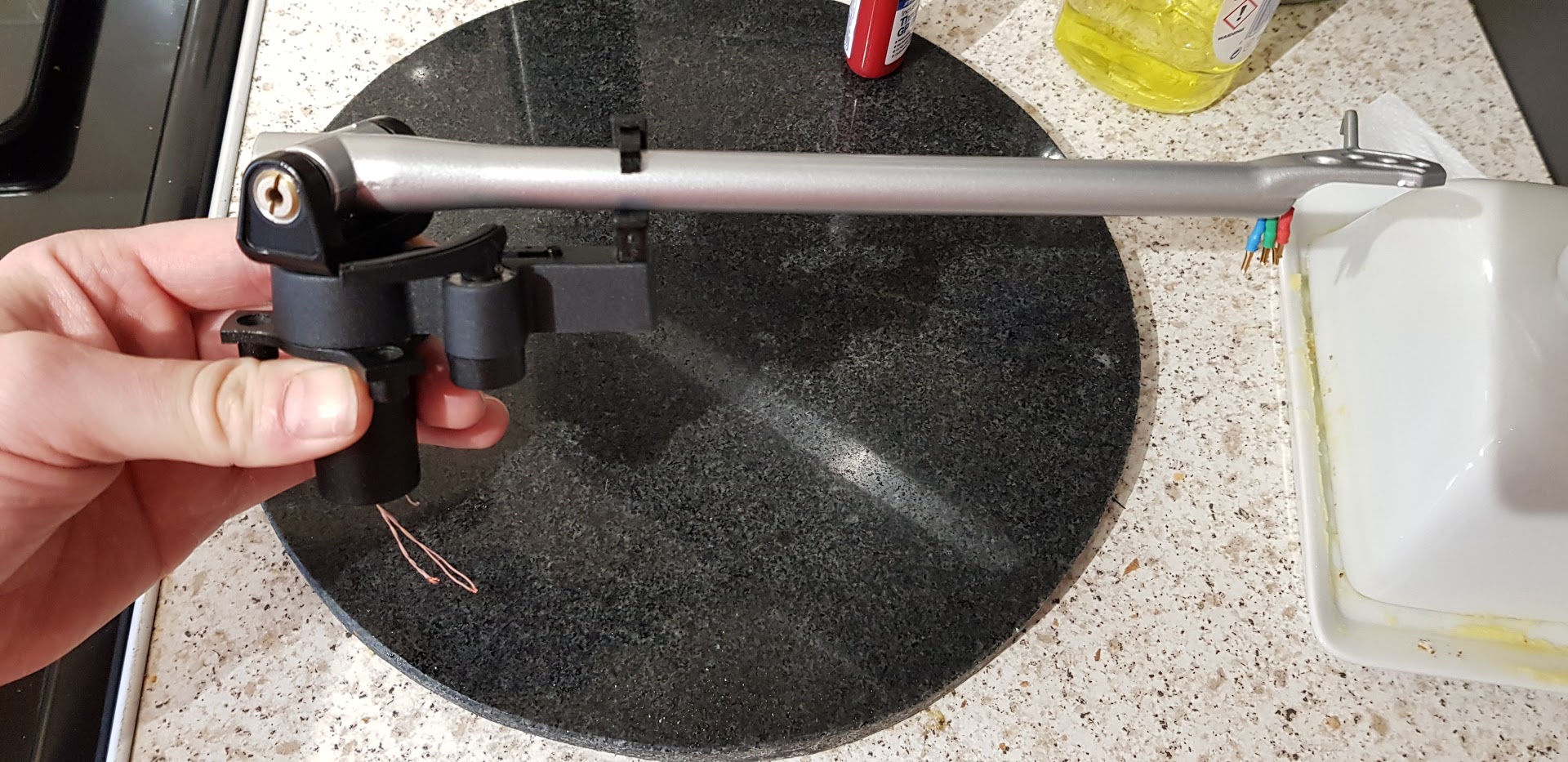

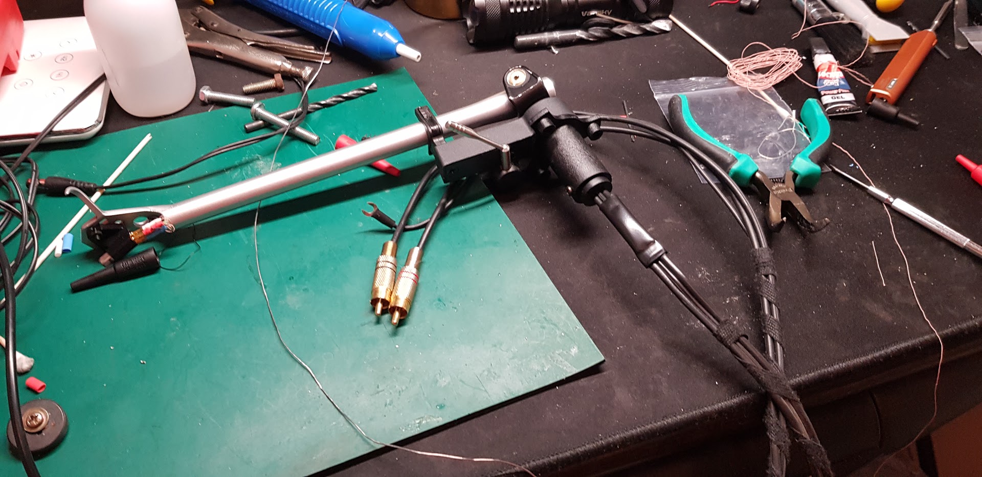

After fitting the Delrin Platter I thought i'd treat it to some other bits and overhauled the tonearm.

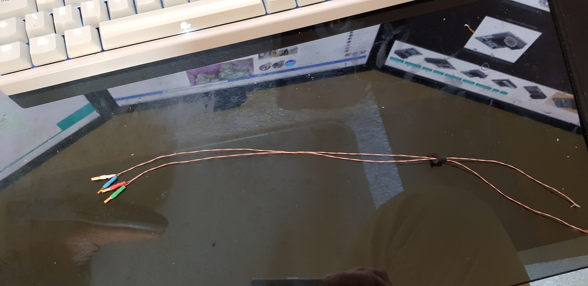

The original wire in the tonearm was looking a bit sorry for itself so I decided to replace it with some copper litz wire and fit some gold plated connections, I won't start a discussion about cables on here, I do not subscribe to "Audiophile" cable stuff personally, I look at things with my engineers head on so fit what I feel is suitable for me.

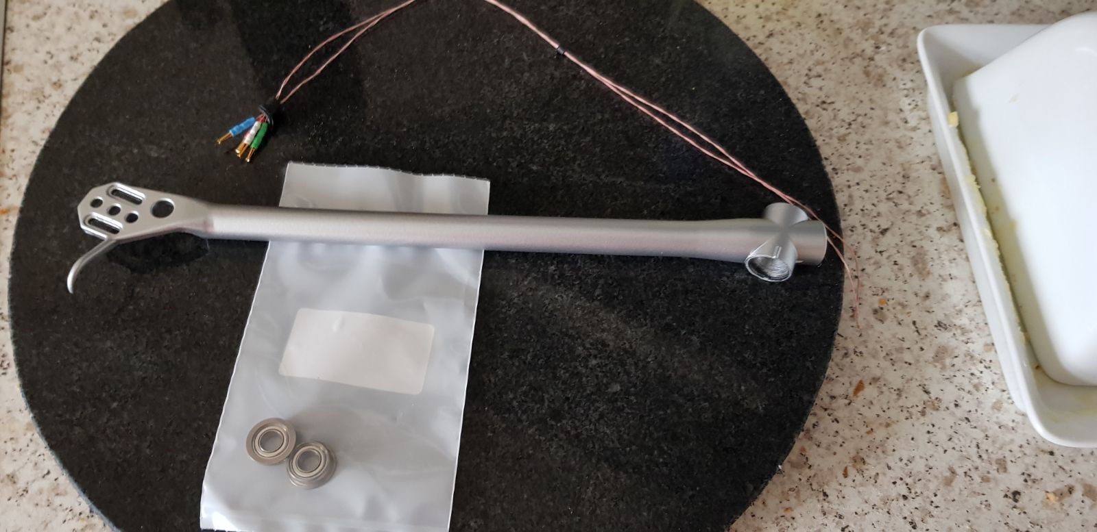

I checked the tonearm bearings, I wanted to see if it was true what others had reported about the Goldring RB251 having different bearings to the Rega counterpart, in this case they were identical to what Rega fit to their RB251. The only difference was the adjustment was a bit off! I think this could have been deliberate... Who knows...
So ordered up some NMB ABEC 5 bearings, while the tonearm was off I decided to clean it up, remove any casting marks and paint it. I used Lidl "Rim Paint" for this.

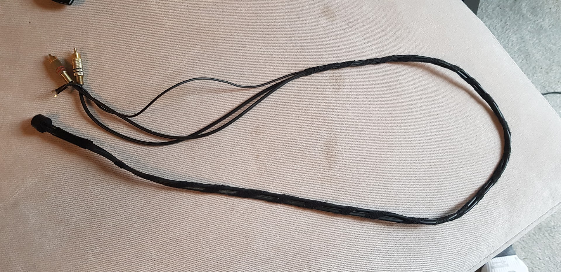

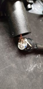

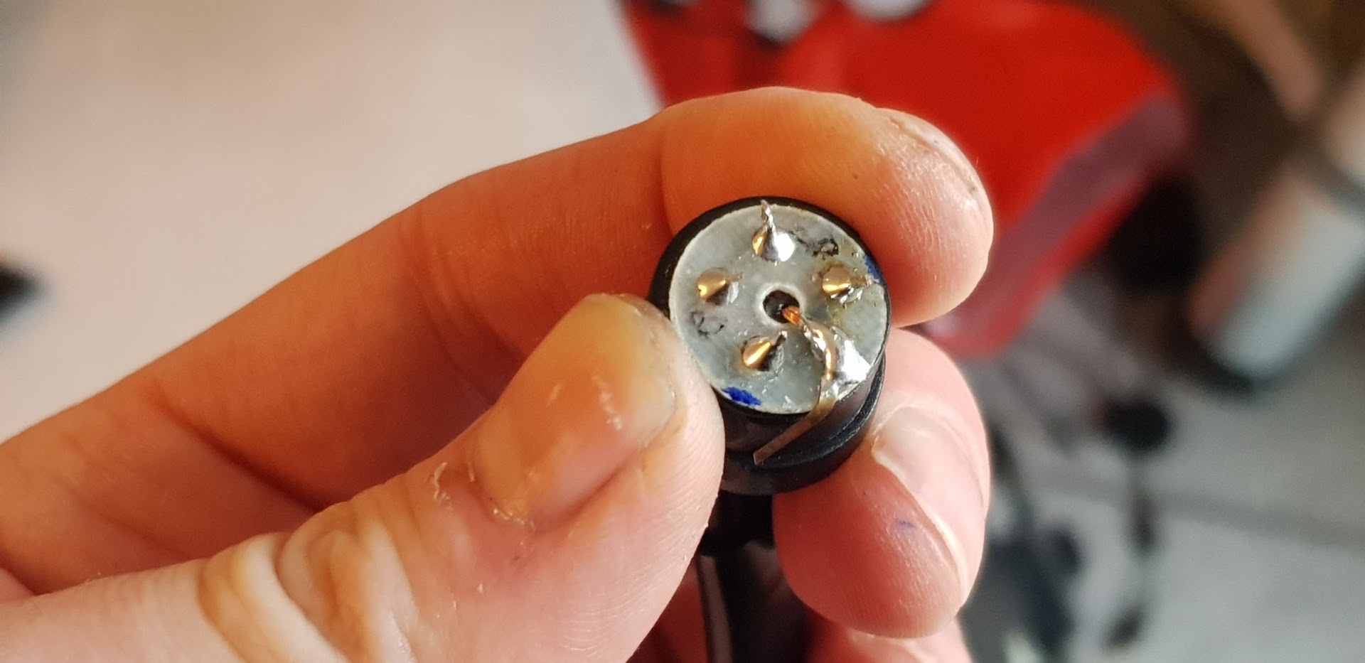

The Rega method of grounding isn't great, they just connect the cartridge grounds to the tonearm and not bother running a separate ground wire, the phono/rca cables it came with were pretty poor and were loose in the phono pre-amp I have so decided to replace them. And add a separate ground wire.

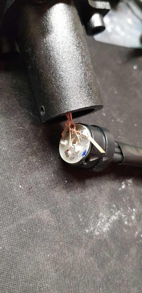

I found a lead off an old turntable here which I removed, Rega in their wisdom don't allow you to easily swap the phono leads, they terminate them in a molded plastic and then just solder the tonearm wire to it.
I removed the small PCB from that molded plastic, discarded the old leads and drilled a oval hole in the middle to pass the new leads through and re-used that small PCB.

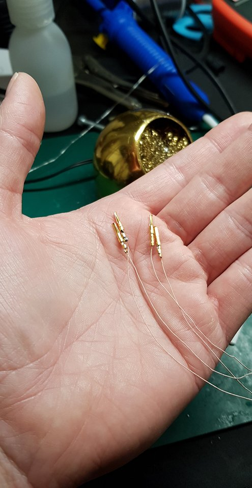

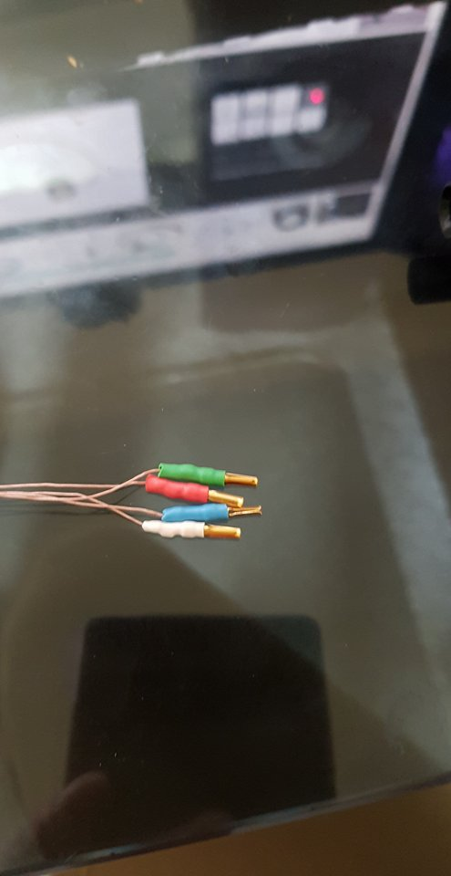

Fresh "Litz" wire that I terminated with gold connectors, a tip if anyone solders these, put a toothpick in a vice and push them on to solder
or snap a wooden cotton bud in half and cut in to a triangle with a knife.
Arm prepped and painted and ready for new wire and bearings, I twisted each channel in to a pair, no idea if it will help with interference etc (technically should do as they are crossing over out of phase with each other), but nothing to lose and makes terminating it to the phono lead pcb easier.
Arm assembled, bearings fitted with a tiny bit of "Loctite Blue" all adjusted and fitted.
Very happy with the outcome and looking forward to fitting a new Cartridge.
