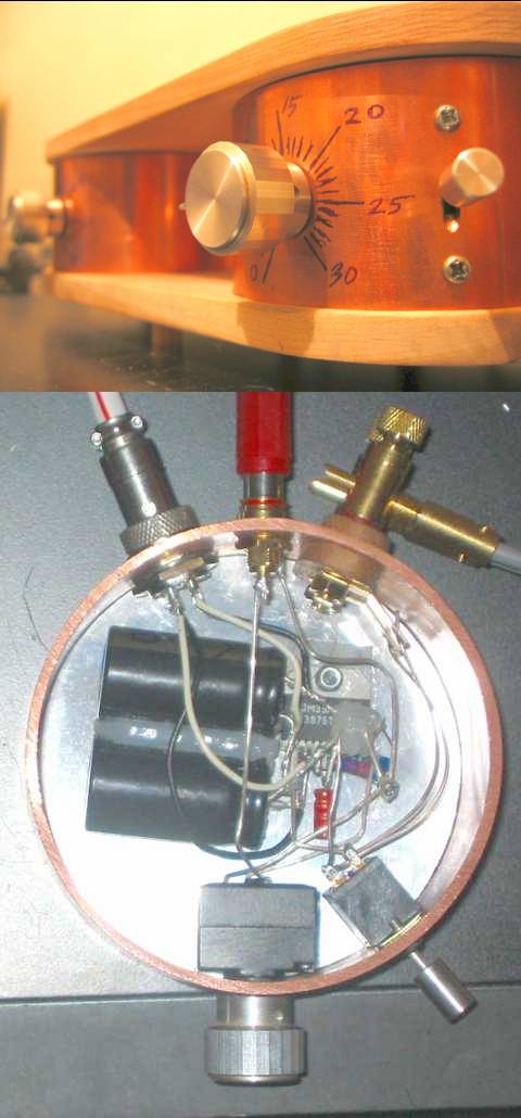

The first was built in a Radio Shack plastic case with Radio Shack parts less the chip and toroid. Initially it had hum which went away with time. It is now in amp heaven. This is my second with BG caps and Riken resistors. 50k Noble 31 step pot. The transformer is the 160va 15+15v (hammond) from Digi-Key & MUR860. Listening to it for about two weeks now and I have to part with it (gift). Which is a good reason to build a new one!!!
I posted the copper pipes a while back so I figured it only proper to follow through and pot the finished amp.
Are those pipes copper? They look like the stuff I used for my monoblocks with some copper paint on the outside and foil on the inside.
Yes 4" copper pipe cut to about 2 1/8" to 2 1/4" long. I took it to a local hardware store and the guy cut it on a miter saw with a huge (12" or so, round) abrasive blade ($6 for 3 cuts). The heatsink is a flat piece of aluminum, 1/4" thick, cut to fit snuggly into the inner diameter of the pipe. It is held in by nothing more than its tight fit. The copper and heat sink are then countersunk into the bottom piece of wood. I would've liked to countersink the top as well but it was such a pain to countersink the bottom with layman tools that I didn't bother.

- I can see you used liquid silicone to hold parts in place and dampen their vibrations. What if the chassis would go hot and the silicone will melt? Did you consider this situation? I have some silicone that looks just like that (used it to seal speaker cabs), do you know what kind of temperatures it can withstand and still be solid?

About the silicone it is GE Silicone II and the reverse reads:
NOT FOR: Surfaces that willl exceed 400´F (205´C)...
When the amp warms up it dosen't get close to this temp. I've had the amp on for periods of 2-3 days and it dosen't get warm at all if no signal is going through it. I run it between 10-15 (vol. pot) and it runs slightly warm. It is on practically all the time. Prehaps I am running a fire hazard or doing something wrong, but up until now it is ok.

I am 99.99% sure that the 3 to 8 (22k) resistor is a 1/4w Riken. I wish it was shorter that would have made me much happier with the construction. Also I should've added the zob. stuff at the output. Other than this it was a nice put-together experience. Everything seems easier the second time around.
No PCboard as hard wiring is very simple especially with solid silver wire. no stripping or twisting or anything but solder one end, find/bend the wires path, snip and solder.
Those are actually mute switches.
