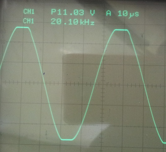

After playing with changing Q3 with no improvement, I looked elsewhere.
I was using a KSE350 for Q12, since its all all plastic body and easy to mount to heatsink.
I replaced it with a OnSemi MJE350 and sticking was still there but with max output moving from 107Vp-p to 110Vp-p, so I left it in.
This morning I removed the RC network C2/R17, sticking was completly gone but with instability, oscillation appearing as ringing, even at low levels.
I then replaced C2 with a 22pf and instability wasnt visible and sticking was very minor,
I felt uneasy about the oscillation and replaced C2/R17 with just one 100pf.
Sticking is more than with 22pf and I hope the amp will remain stable.
Attached it screenshot of clipping with 100pf in circuit.
Regards.

Since my previous amp is working fine now, I want to make some changes.
Here is the next revision of the amp, still pretty standard design.
Again thanks for all the help so far,
I'd like to know about R17 that was suggested,
- I'm not sure about calculating is optimal value and power rating,
- at first glance I thought a nominal value of 470R to 2k should work,
I'd like to know what low power and med power transistors I could use for the VAS stage,
- If tried 2SC3953 and 2SC3788 but I can't source reputable pieces of these here.
- I also buy for RS but they don't seen to stock them,
- I've used MJE340 and they worked for me, but heard they not optimal.
