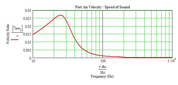

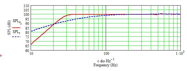

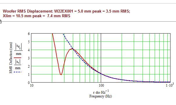

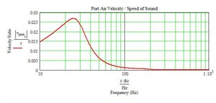

I tried a MLTL using Martin King's Mathcad worksheets. I made these assumptions:
- Use the original width, depth and material dimensions. This gives an internal width and depth of 9” and 11.5” respectively.
- The spacing of the drivers remains the same including the distance of the tweeter from the top. This also fixes the distance of the woofer from the top, one of the MLTL variables.
- The tweeter height will be 35” from floor; this fixes the internal height to about 38” (37.9”).
With those assumptions the gross volume would be 64 L and I subtracted 0.5L for the speaker and bracing. I ended up with 0.5 lb/ft3 stuffing density in the top 24". The port, 3” diameter and 8” long, is placed 5” above the internal bottom.
Here’s what I got with a 18 W input signal (anechoic response, no room or boundary effects) for SPL, excursion and port velocity. Note that the excursion is RMS, not peak or peak to peak.

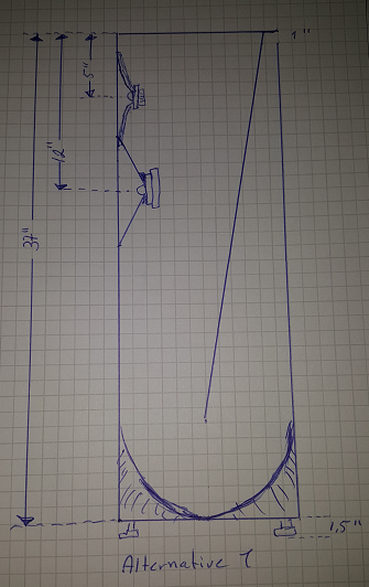

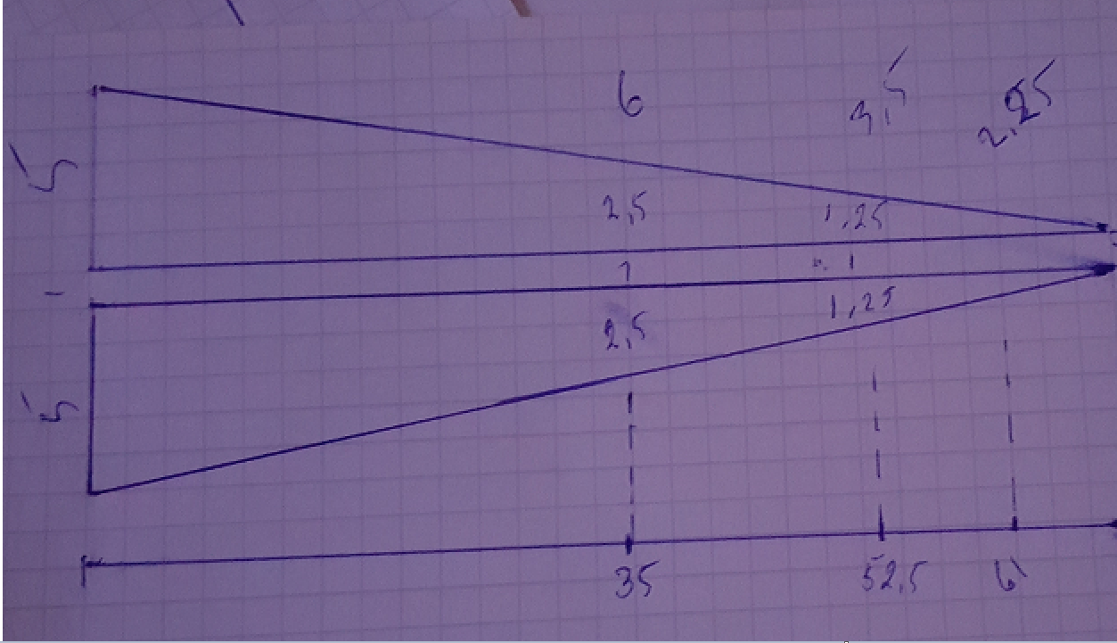

So, I went shopping wood for the new cabinets today.
Since this is also a case study before my next set of DIY speakers, I decided to go with the conventional line.
For my next project MLTL is an option due to cabinet shape.
It should be noted that I have decided to deviate somewhat from the original Trym layout. I believe the Trym is an early design and I will eventually attempt an XO redesign. This change of layout has the effect of putting the bass element in a slightly different location compared to pkitt's modelling. I don't think this is as critical for a conventional TL as it is for an MLTL?
Before I start cutting I hope someone verify my understanding of pkitt's modelling.
Attached images show two alternative boxes. I believe box #1 should be very close that proposed by pkitt. Alternative #2 has a slightly longer line, but if necessary, I can shorten it further by lifting the start of the line by making a false bottom.
So my questions before I make final decition towards alternative 1 or 2 are:
- How critical is the line lengths
- How important is the radius fillets, and what do you propose to make them from?
- Do the start of the line have to be level, or is it OK if it is slanted (I.e - do I have to make the cavity for the XO in alternative#2 or is it OK to simply attach the XO to the cabinet at the start of the line?
- Any other comment you may have

The driver location in the line is important but if it's within an inch of that modeled, negative effects will be very minor. If you want the performance that I modeled, you need to build it as I modeled, however. Those fillets around the corners are absolutely useless regarding the line's performance. They are the result of old and incorrect theories and all they do is consume some of the line volume. The line's beginning doesn't have to be exactly horizontal but the beginning of the line's length is measured from the middle of that angled member. You can definitely locate the crossover as shown; however, the crossover, the woofer and any braces you add, all consume volume which will affect the bass reach a bit. In order to compensate for consumed volumes, estimate their total amount and calculate what percentage that is of the total line volume, then simply increase the internal (and line) width of the cabinet by the same percentage when you build (the volume for the angled line divider is automatically compensated for in the modeling). For sketch 2, there will be reinforcement from the floor boundary of the terminus' output, which may be "too much of a good thing". You won't have that problem with that shown in sketch 1.
Paul

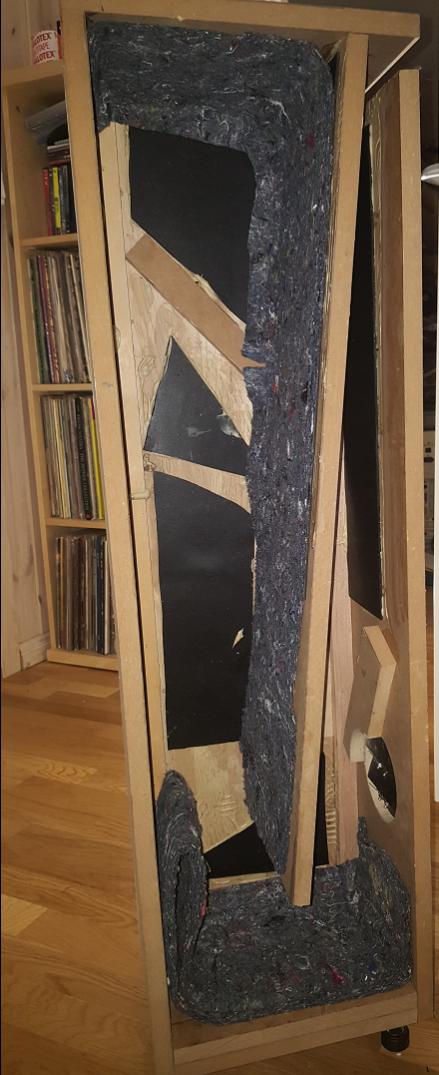

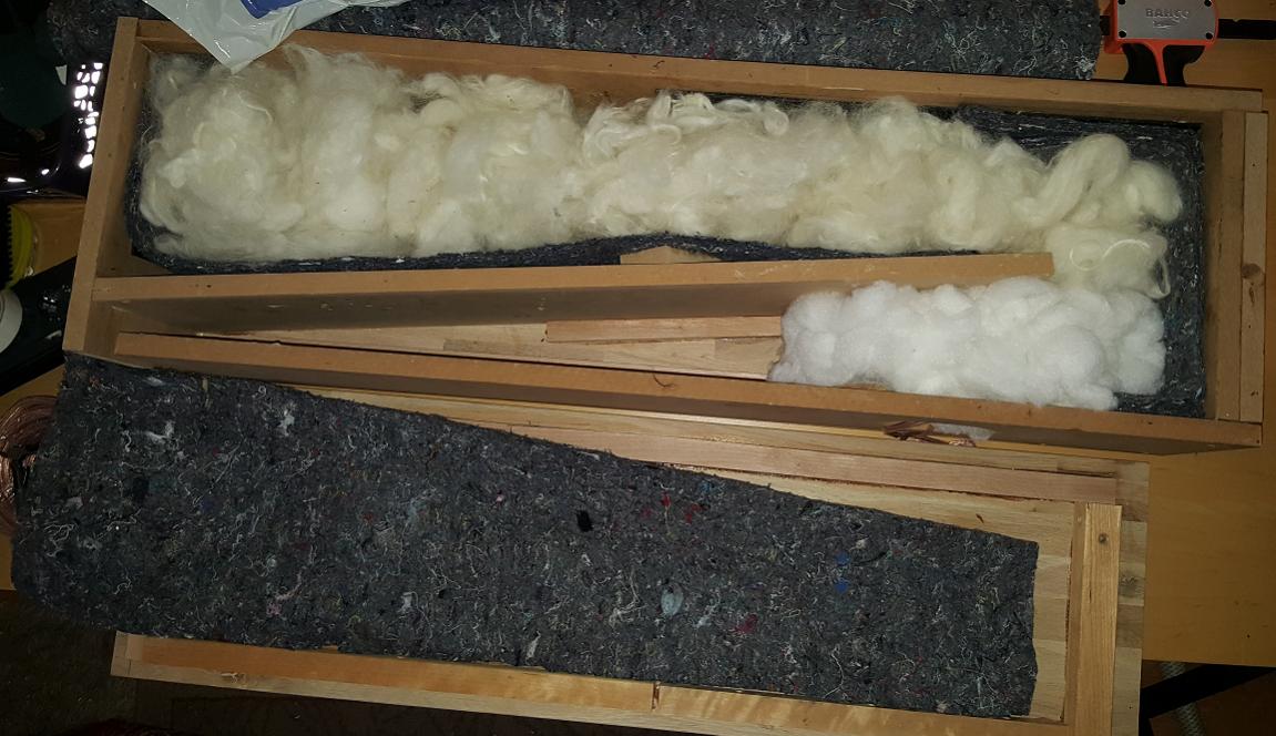

For a variety of reasons things are moving ahead slower than what I'd hoped for. I am planning to close the boxes later today. Before I do that I would like your advice on stuffing.
At the moment I have bitumen on every panel, and some lining on top and bottom of the cabinet, hoping to kill of some standing wave modes.
For stuffing I intend to use long fibre wool from my old Bailys, simply because that is what I have at hand right now.
I have four questions.
- Lining: Should I put more lining than what I already have (see picture)?
- Is recommended amount of line stuffing the same for polyester as for wool (0.75 lb/cu.ft. for the first 2/3 of the line).
- In terms of midrange quality, am I better of with a little less filer behind the mid-woofer or should I keep fill density constant
- Later, when doing impedance sweeps, what should I look for in terms of determining amount of stuffing? Will near-field SPL close to the line terminus be a better measure?
biteminum will do nothing to affect standing waves. It is intended to damp panel resonances (but can often backfire).
There will be a difference, even between different species of polyfluff. Wool is good for damping but not for stability and is a good moth food. i would mix with some poly to get stability with most of the dampin gof the poly.

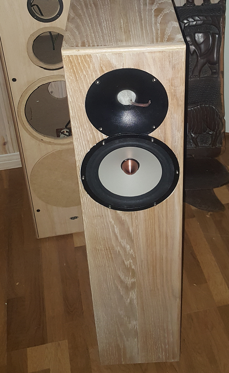

Still moving ahead at snail pace. As can be seen in the attached image, at least now the woodwork for the first cabinet is close to done. Some pigmented wax is on order for the finishing.

I guess I was not quite clear. I have mass loaded the cabinet with Bitumen, Then lined the walls in the first part of the line with 10mm lining. First half of divider (closer to woofer) and side walls lined, baffle is un-treated.
Top and bottom of cabinet has double lining.
Due to the lining I decided to start of with 0.5 lb/cu.ft. of stuffing for about 2/3 of the line length. If I were to re-do the stuffing I think I would have increased the amount slightly as I felt it was difficult to fluff it sufficiently to fill the full volume and to maintain an even density.
There will be a difference, even between different species of polyfluff. Wool is good for damping but not for stability and is a good moth food. i would mix with some poly to get stability with most of the damping of the poly.
dave
Following the idea of Planet-10's proposal and using what I had at hand I stuffed the line part of the line closest to the terminus with poly fill and the remaining part of the line with wool as per attached picture.
What remains now is to make a dummy plate to put in place of the waveguide so that I can actually start testing the T-line. All things going well, I hope to be able to post impedance plots and near-field SPL plots for woofer and line plots upcoming weekend.
