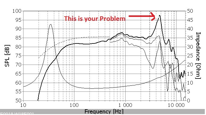

A notch filter is an LCR network applied to the 4.8kHz bass breakup peak. The Madisound design looks much simpler than the Troels Gravesen one.
https://www.madisound.com/library/w18e-001-r2904-7000-passive-crossover-design/
Here, 6uF, 0.22mH and 2R. Should be about right.
I would go with the madisound one initially, since it is simpler. Now you just need to allow for your 4.7R 90dB 2905/9300 tweeter as opposed the 94dB R2904-7000.
Less attenuation in the tweeter filter. The cabinet is somewhere around 20-25L reflex. Troels has some details.

Seas w18e, 4800hz rising is not good.
So I cant use a notch filter when using serial crossover?

System7 or anyone with appropriate software… please see if you can work up an 1800hz 4th order acoustic for the W18e001…I am wondering if a 2.5mH inductor with the Madisound notch filter discussed above might do the trick.

I remember a description of the crossover: it’s was low Q, but not high order, or steep notch. Fc was about 1/2 of that magnesium resonance peak.
If I remember correctly he used a 1600hz 3rd order design..not sure if there was a notch after that. I guess I am just trying to Thor light…ie do an MT trying a larger primary inductor followed by a notch filter.
