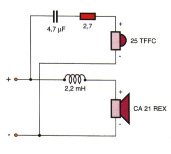

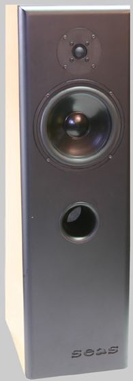

Joachim Gerhard's original Arkadia, using a 8" CA22RNX paper cone by the look of it, and a 104mm SEAS 1" soft-dome, maybe a 27TFFC:
626761d1500598935-classic-monitor-designs-sonics-arkadia-cabinet-jpg
The Arkadia had quite a sophisticated crossover.
SEAS U22, a reflex driver for sure: H1659-08 U22REX/P-SL
SEAS DXT, a waveguide tweeter that is very likeable: H1499-06 27TBCD/GB-DXT
Joachim Gerhard likes this Arkadia upgrade on a simple capacitor to the tweeter. Maybe 4.7uF. No resistors needed, he says, but I'd have to think about tweeter polarity:
https://www.diyaudio.com/forums/multi-way/147632-classic-monitor-designs-45.html#post5143737
And he's no mug.

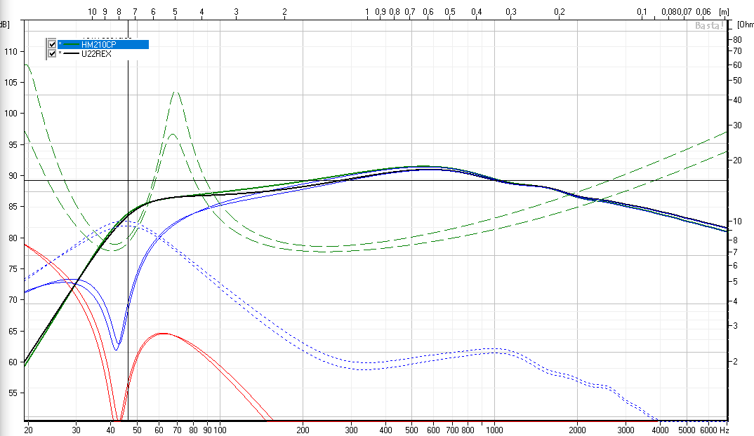

The driver models well in a 36 litres vented cabinet, Fb=40 Hz, vent 3" by 7" or smaller 2.5 by 4.7. Properly designed hifi loudspeaker would have included a waveguide tweeter crossed lower than you would like to. Still, proceeding your way the results should be rather ok, particularly employing measurement gear in the design process.

That Audax HM210CP looks alright. Though the peak at 4 kHz might be troublesome. The CSD or waterfall plot of stored energy shows the typical troublesome 3-4 kHz cone resonance, which IMO produces some 2nd harmonic nasties nearer 6kHz. You can always see this in the Phase plot too:

I would not compare hm210cp peak at 4k to seas alu resonances. Its amplitude a the rigde in waterfall are very mild. I think it will take only series RC in parallel to woofer coil to suppress it. Capacitor the tenths of uF and resistor.
Actually almost same peak is also in U22 response. In both cases, Though I would prefer it was not there, I think that peak would be hardly audible.

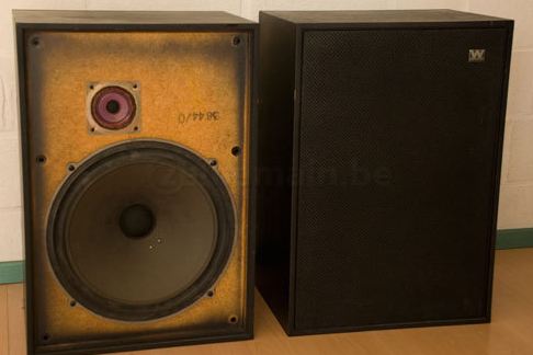

I had thought cone tweeters had gone away. I had some wharfedale melton 2's back in the day. 12" woofer and an odd purple ~2" tweeter much like that one in the linton. when i blew that up and couldn't find a replacement i made them into a 3 way with the 27TBC/G and L12RCY/p. It sounded fantastic, to my ears at the time anyway. more down to luck than anything else probably!
When these things are finished i'll be driving them with a custom amp i nearly have finished. 4 channels of ESP 101 mosfet amp kits (low power version) in the same box with an intel NUC motherboard, asus 'xonar' U5 soundcard and preamp/volume control. That pulse audio crossover will hopefully do an adequate job, it was a bit of a pain finding something that could cope with differing sample rate of source media/apps. maybe i should do a separate post about all that though, getting a bit OT for a speaker thread!
I used to have the Wharfedale Melton II as well.
687818d1529515288-passive-crossover-build-help-wharfedale_melton-jpg
An alarming tendency for the purple plastic tweeter to blow up, as you also found. 😱
The, er, "Raison d'Etre" for the Melton is it exploited a tax break for loudspeakers in the UK back in the 70's.
Anything with a 12" bass or a three-way like the Spendor BC1 was considered "professional audio" and hence avoided 25% luxury purchase tax.
Hence the 12" £38 Melton was scarcely more expensive than the 8" £35 Linton. But had thunderous bass.

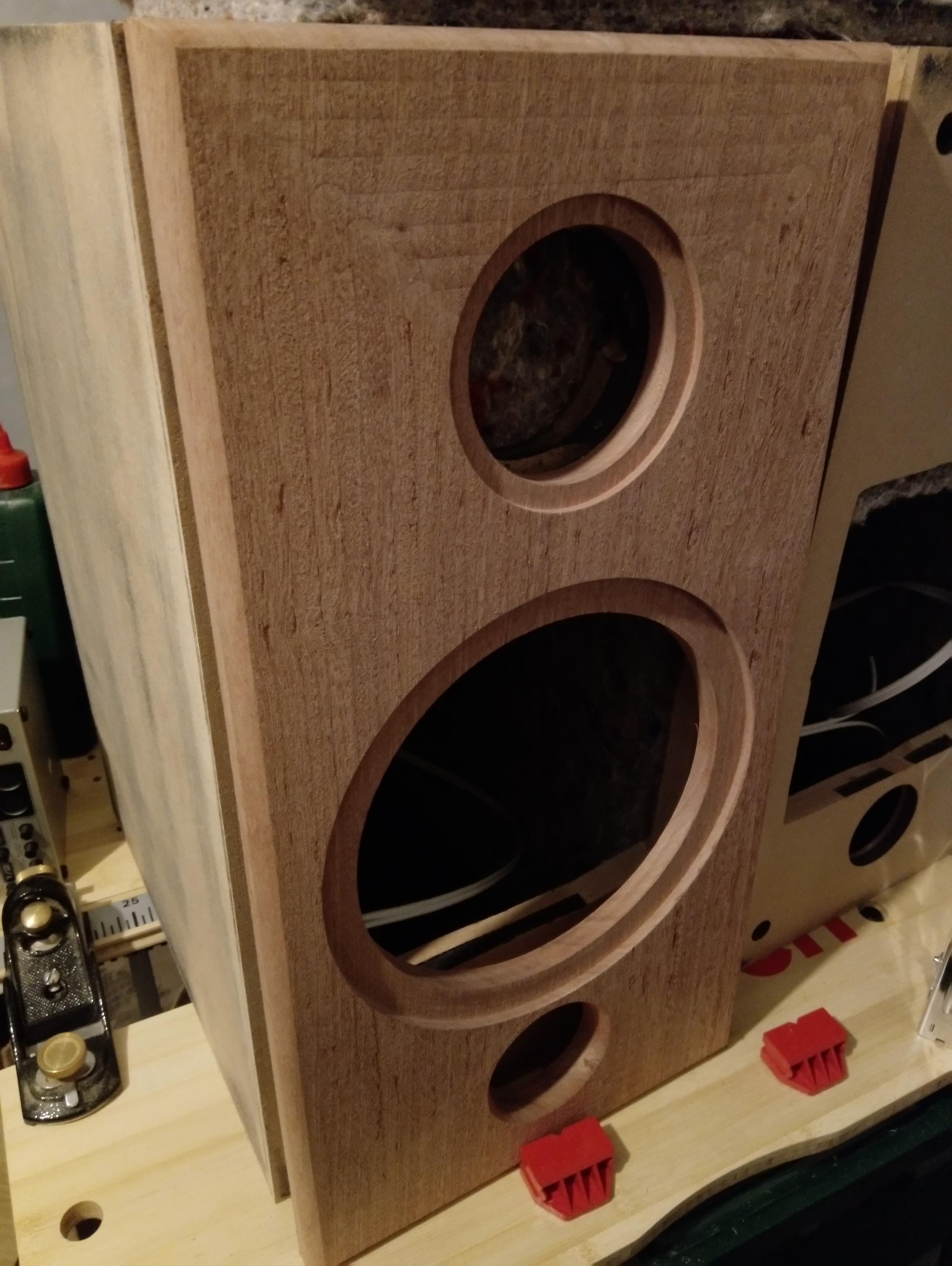

And after far too long waiting, the new front baffles have arrived!
attachment.php
Made from solid sapele to match the veneer that will be stuck to the sides while sporting a beveled edge. People get upset about using solid wood for speakers, bit they will be glued to the remains of the previous MDF baffle so I figure resonance wont be too much of a problem.
Now i have lots of gluing and veneering and sanding to do!
