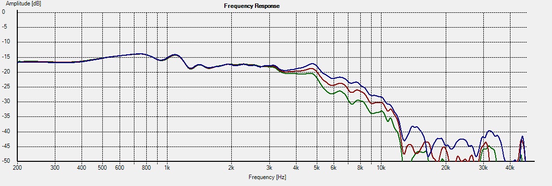

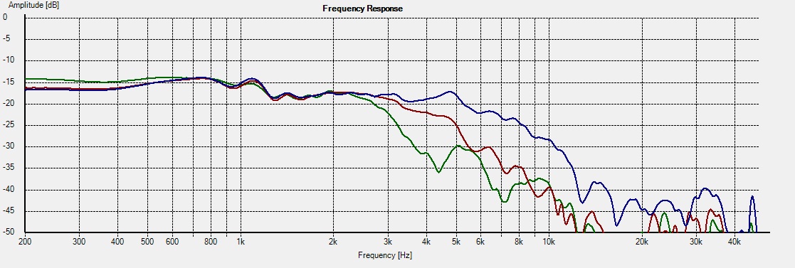

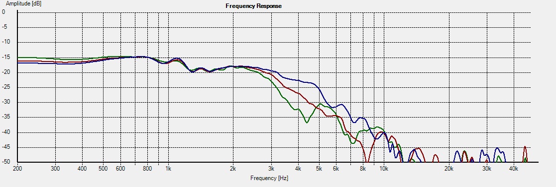

I’ve attached some pictures to show how the off-axis response looks like for the SEAS U16RCY/P (without cross-over).
All measurements are made at tweeter height @ 1m (13.5cm above mid-woofer center). The frequency plots a normalized and 1/24 octave smoothing is applied.
Picture1:
Blue = 0deg
Red = 15deg
Green = 22.5deg
Picture2:
Blue = 30deg
Red = 45deg
Green = 60deg
Picture3:
Blue = 0deg
Red = 30deg
Green = 60deg
At 2.8kHz @ 30deg the mid-woofer starts to roll-off, respectively 2.6kHz @ 45deg and 2.3kHz @ 60deg.
Regards
/Göran
