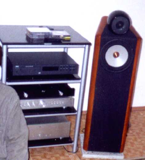

Hi!
I have had a discussion with petrh from czech diypage. His opinion is two smaller woofers(d´Appolito) are better then one bigger. e.g. : 2x CB17RCY/p in d´Appolito are better then 1x W22. What do you think? He says there is only little diference between Seas Excel and Seas Classic speakers!
I have built something like Seas Trym(W22 + T25 - 001). There is a photo!
Best Regards/ S pozdravom/ Üdvözlettel
Feri
