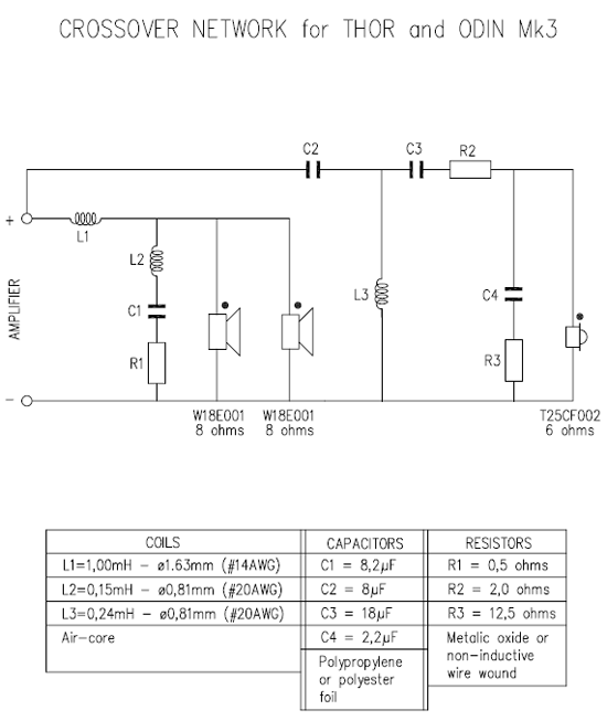

I have the schematic and 2 pics to upload.
If the Supreme Aluminum is in the sonic path, then its not what i requested.
I requested all tweeter caps to be Mundorf Silver/EFVO silvergold.

Yeah well C3 is made up of
1 Mundorf Silvergold Supreme 10uf + 1 Mundorf Supreme Aluminum ]
I would prefer that 18 uf made of
Supreme Silver Oil 10uf + EVO Oil SG.
So now i know the Supreme Aluminum(C3) has to go and be replaced with a EVO Oil SG.
I'll let the designer know he made a error in what i initally requested.
I went over the specs several times, and went with his advice,,
Seems best to get 2nd opinions on components relating to xovers.
great,
Then here is how it will eventually work out
C1 currently has a Bennic 8.2uf (exact same cap as original xover from 2004,,= no upgrade whatsoever..??)
C2 has Mundorf8.2uf SG EVO Oil (smaller version of the Supreme SG) = will remain
C3, has M10uf Supreme SG (stays) + M Supreme 8.2 aluminum, will replace with M SG EVO Oil 8.2uf
C4 has 2.2 Aluminum, will roll to 2.2 SG EVO Oil.

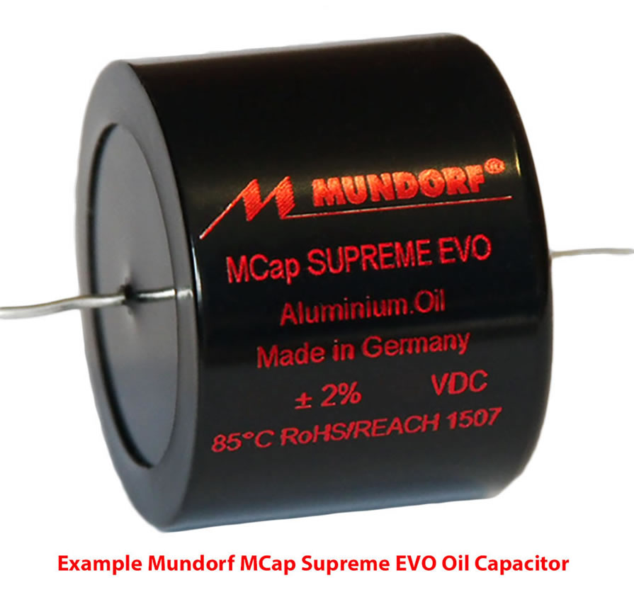

The Bennic 8.2 will get dumped for a M 8.2uf Mcap Supreme EVO Oil

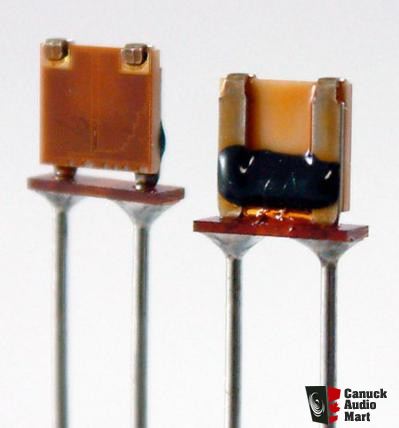

In 2 months all will be complete with new Zfoils going in DPL , later in Defy7.

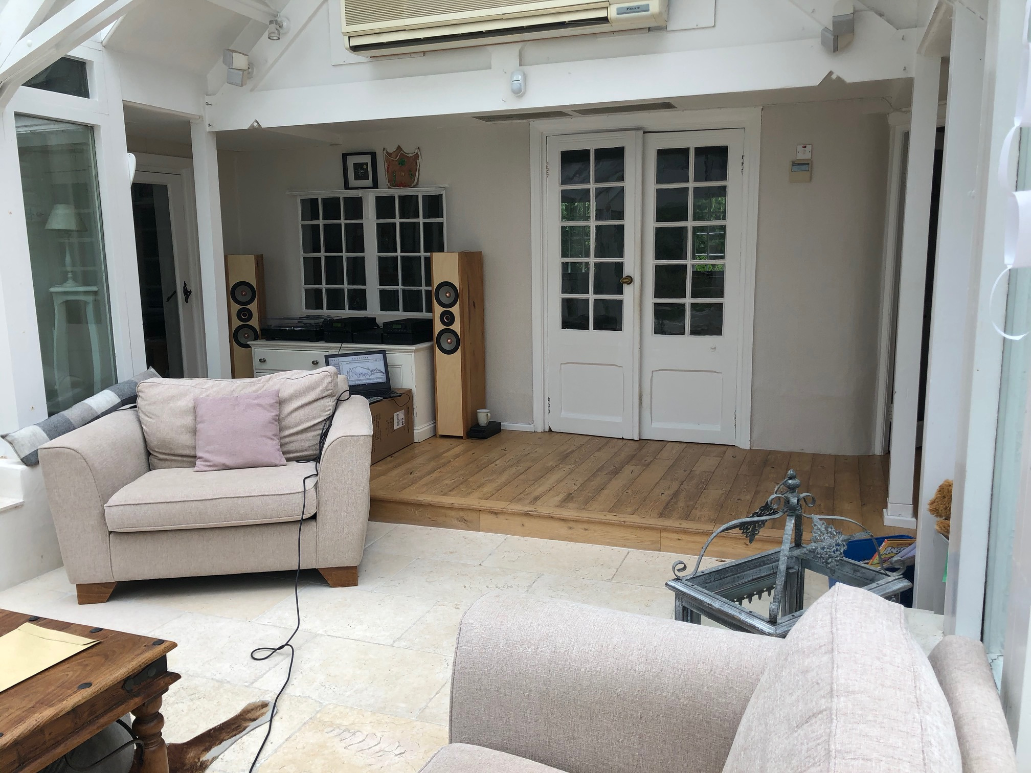

TBH, the best speaker in the World is going to sound terrible in an overly-lively room setup like that! 😀

Upgrading an 8.2uF C1 capacitor will add exactly NOTHING to bass response! It only works in the midrange.

Either way, as Steve said, C1 is part of the stopband notch, i.e. it operates above the frequency across which you are using the driver. Its purpose is to attenuate the bell mode resonance. Which it does. Although whether it does so sufficiently to suppress the resonance induced HD lower down, where the driver is being used, is another question. Some feel it doesn't; unfortunately, if that is the case (I'm not saying it is, just noting what happens if they are correct), the only way of fixing it is to redesign the crossover.

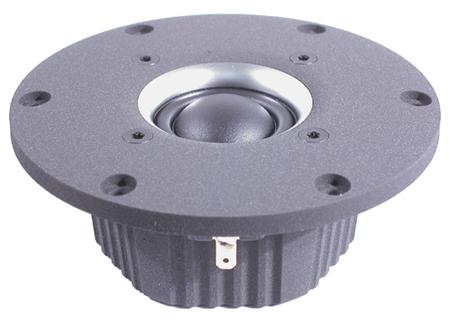

TBH, I get a bit vaguer on tweeters. I am not too sure that dome tweeters are exactly the best way to approach things.
Would I spend Money on this tweeter?
872282d1598901114-seas-thor-xover-t29cf-002-jpg
Probably not. 😀
