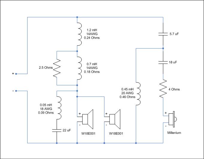

I'm sure there's a lot of confusion with all the different revisions of my crossover. Attached is the final version. Please use this one if you're not going with the stock crossover.

Thanx Jim... i'll update the 1st XO in the above doc to 4 ohms from 8||9. (there are some other cosmetics need fixing too).
I will also make a further note in the 2nd XO that it has been superceeded and there for historical purposes or as a reference for the intrepid souls who wish to further explore XO modifications.
