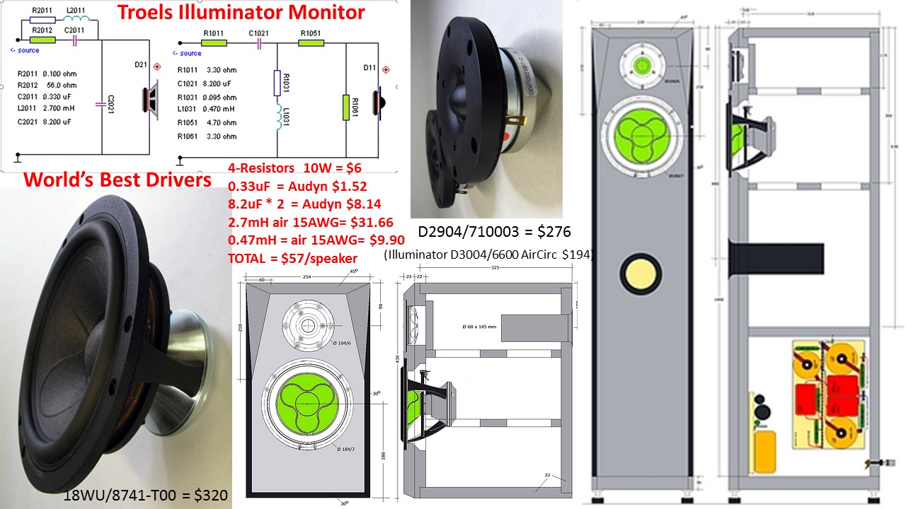

Troels Gravensen's ultimate ScanSpeak monitor is probably his
Illuminator Monitor
Copyright 2012-14 © Troels Gravesen
Which uses:
ScanSpeak 18WU/8741-T00
ScanSpeak Revelator D2904/7100-03 Wide Surround, Black Face Plate
Illuminator-Monitor
One option to put on top of your woofer cabinet.

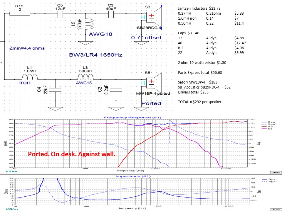

When I was building my MW19P-4 Satori computer desk monitors, I put together a cost comparison with ScanSpeak drivers which might interest you. 1-Speaker = SB+Satori $292 vs. ScanSpeak $653

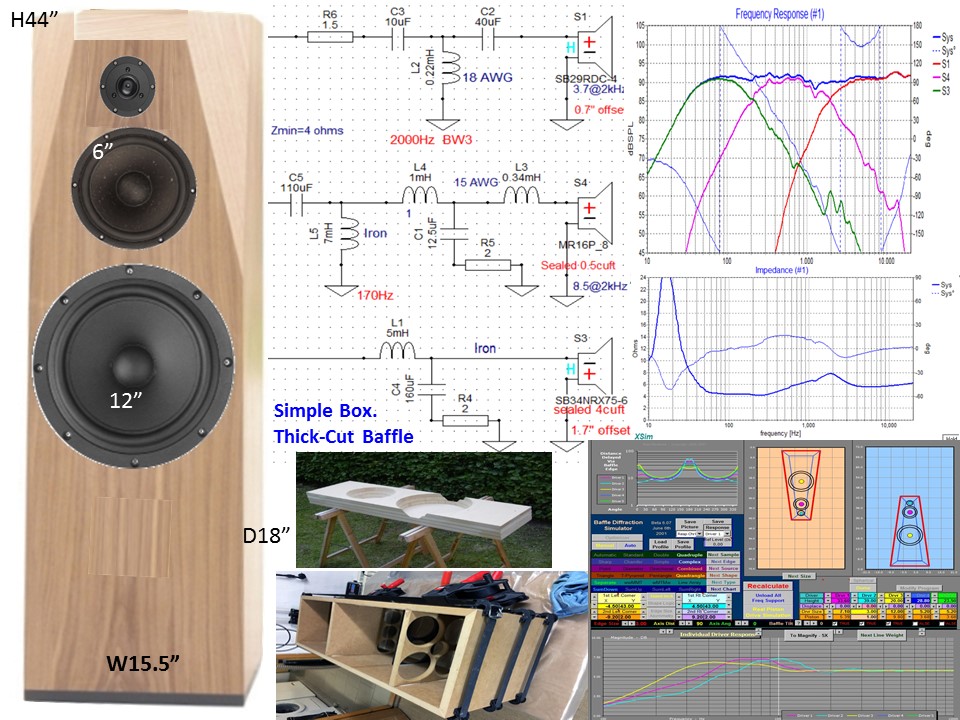

If you decide to use a sealed 12" woofer, study this SB_Acoustics design using the SB34NRX75-2 woofer which has T/S parameters well suited for sealed alignments. Modest Efficiency
The capabilities of the woodshop often determine the design selection.
Is there a well reviewed production speaker with a cabinet shape you like and can build?

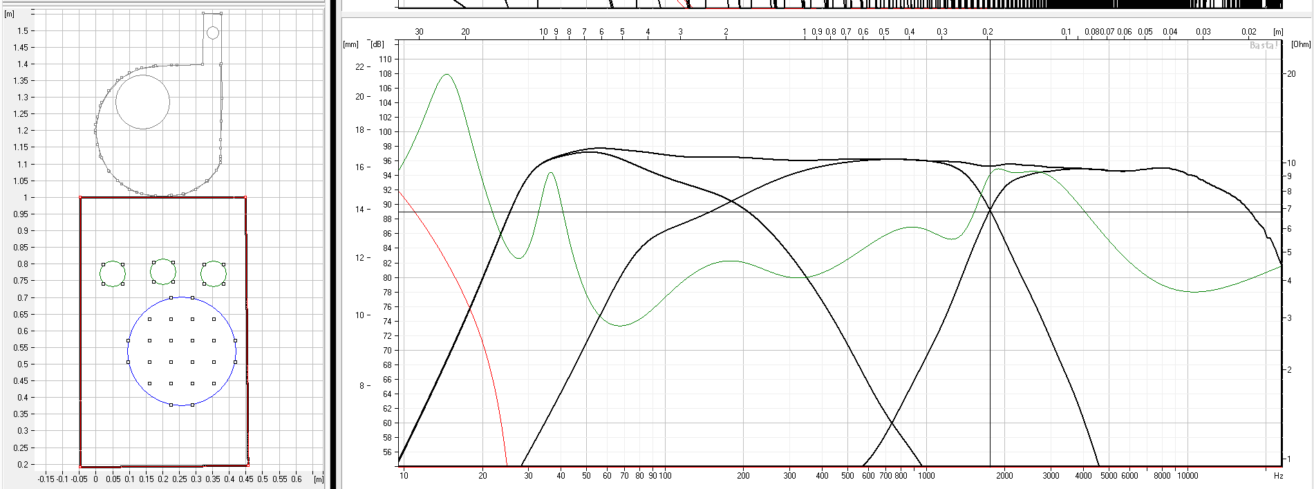

This is a preleminary XO possibility 12db per octave from the datasheets, just an idea...
625 hz and 2500hz XO:
