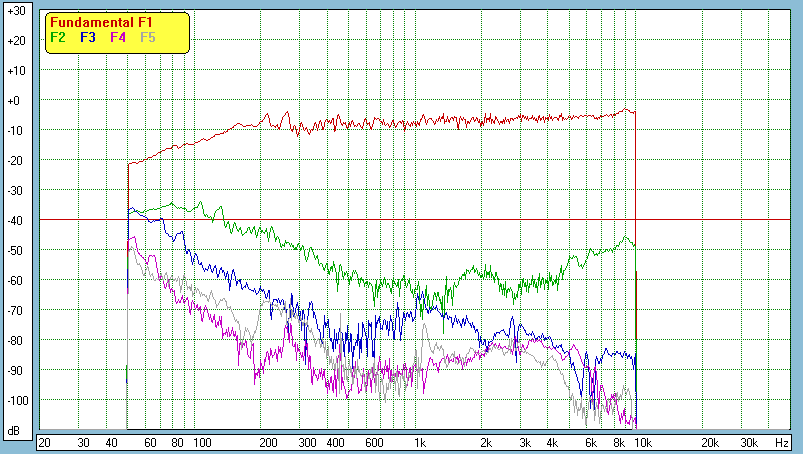

Where these 4" drivers will fail as a "tweeter" are distortion and stored energy. Just like any other full range of similar size.
Looks pretty good to 400hz?
Plenty of tweeters look worse higher up
That looks more like a pass than a fail to me. 😉 Perhaps "average" at 1 watt over a normal tweeter's passband (..neither good or bad).
The stored energy (seen in the CSD) is *better* than average:

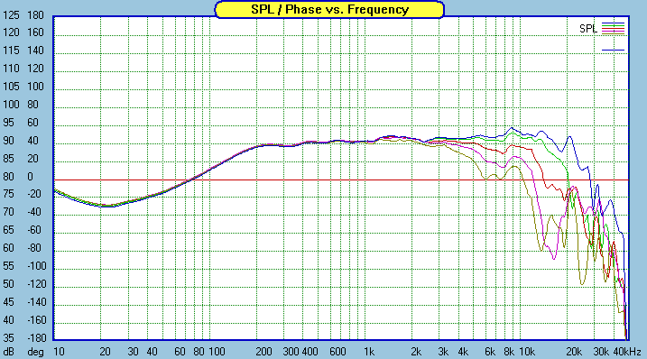

An important item that *isn't* shown is its linear and non-linear operation at higher power inputs vs. that of typical tweeter. Of course the crossover implementation will factor-in heavily for the tweeter under such a comparison. (..btw, this is also very important when comparing these small "mid" drivers to one another. Most are not as sensitive as the 10f, often by as much as 6db.)
Another interesting item with measurements is freq. response with respect to distance. These mid drivers are not terribly linear at closer range - and this does seem to factor-in with respect to the pressure gradient and apparent image localization/stability.
