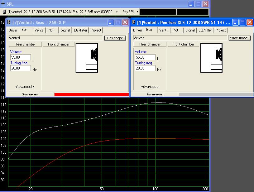

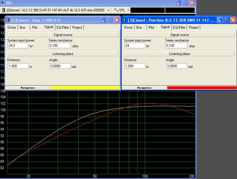

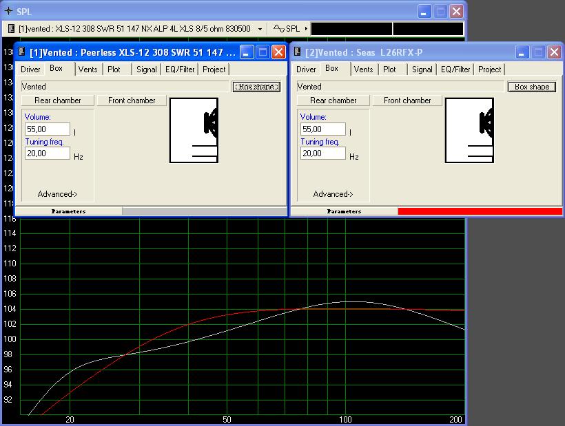

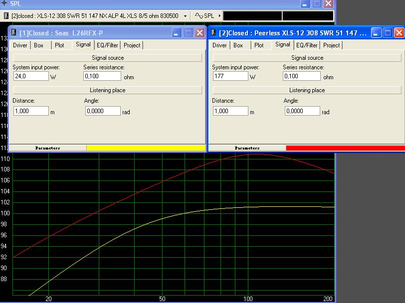

one thing about the L26 VS XLS though, the L26 goes flat down to 20Hz, but the XLS rolls off at 26Hz, this is what points me towards the L26, exept for the fact that the seas alu elements kick *** offcource..
i dare put my mony on the L26 being a bit more musical, tight and detailed than the xls, but not being able to deliver the same power?

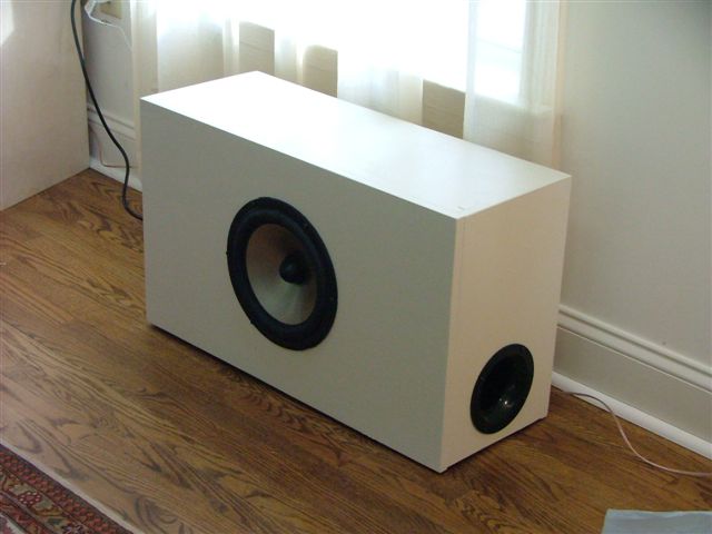

I ordered a Seas L26 and sub amplifier from Madisound today. I plan to build a vented sub over the next couple of weeks to augment my Fostex FE166ES-R back load horns which I recently completed.
