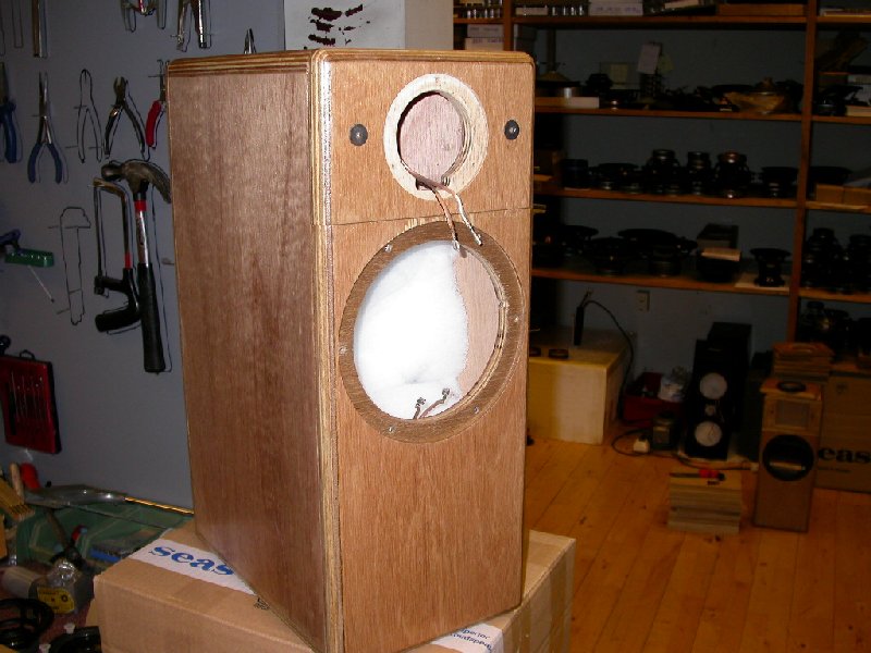

These used to be the measurement conditions. Note the date (2004) and take this with a grain of salt. It might be helpful or not. Attached is the picture of the test box in question at the time

These measurements are made in a box that can be used as a 2-way speaker. It is important that you note this difference if you compare these measurements to the datasheets for our drivers. The boundry conditions are different, especially on the tweeter measurements, so here you will see diffraction effects.
The object of this project is to give our customers access to measured data that can be used to simulate a crossover. While using LspCAD for some time I have found a very good correlation between simulated and measured end-result, so I hope this will make it easier for you to construct your own speaker.

Box
The box outside dimensions:
Front baffle: 20cm wide and 49.6cm high
Box depth: 29.6cm
Edges are trimmed with a roundover-bit r=12mm.
Driver placement:
Both drivers are centered on the vertical axis.
The distance between the drivers centers are 158.5mm
The distance from the top of the baffle to the tweeter centre: 65mm
The distance from the top of the baffle to the woofer centre: 223.5mm
The box has a removable tweeter baffle. This way we can measure all drivers flush mounted in the same box.
The box is approximately 18 liters and the port tuning is approximately 40Hz. All woofers are measured like this, regardless of what the T/S calculations suggest.
