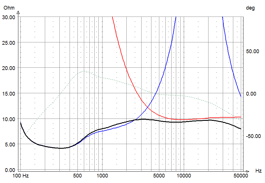

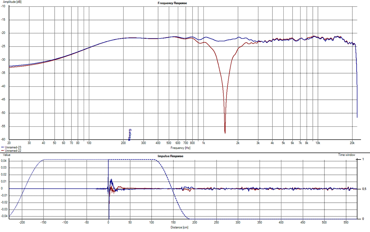

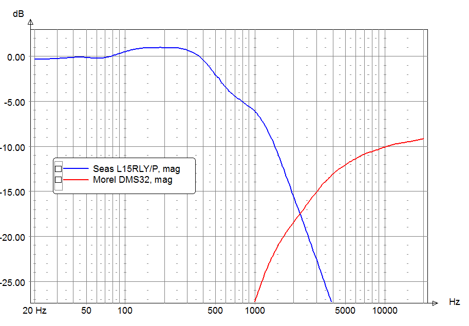

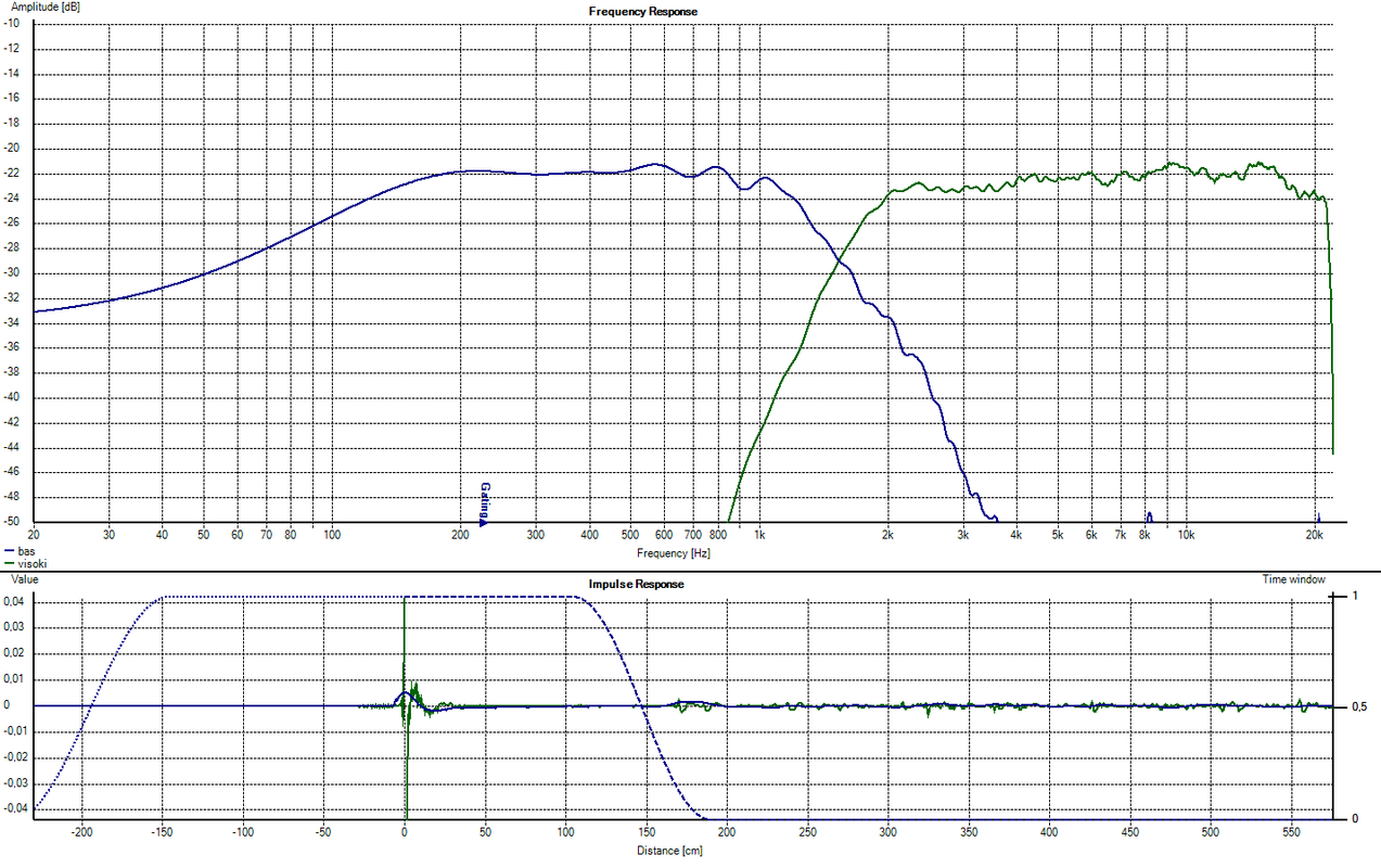

I'm afraid i don't fully understand the question, so i'll answer to the best of my understanding. My goal was to make bookshelf that has good power response, controlled directivity, good phase response, flat frequency response and pass-band free of resonances with as benign impedance as i can - and all that in a conventional packaging with passive crossover.
Visaton waveguide handles edge diffraction higher in frequency, it moves acoustic center of tweeter closer to the midwoofer, it boosts frequency response bellow 10KHz to enable lower crossover point than usual and by that makes power response better without dip at crossover frequency, it lowers distortion. Only thing i could do better than this (that i can remember at this moment) is to use coaxial driver and make vertical off-axis identical to the horizontal.

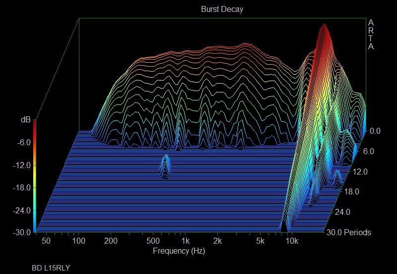

I took an ordinary metal cone driver and ordinary silk dome tweeter to achieve (what i believe is) extraordinary result. I believe that biggest mistake one could make is to buy some drivers and stop with the design when it is good enough. I've tried to make this as close to perfect as the drivers and my knowledge would let me to, regardless of number of crossover parts or similar mumbo-jumbo. The crossover needs to be as big and complex as it needs, to handle all of the problems on and off axis, in my opinion.
Now that the cone resonance, characteristic for metal cones, is under -45dB (which is domain of harmonic distortion so i would guess quite undetectable) - i think i fulfilled my goal.
...Also, what is that 0.25uF C/ 1 Ohm R doing??
0,25uF with 1 ohm across the midwoofer coil is tank filter - or "not quite bottomless notch" at around 8KHz and serves to suppress the resonance even more than slope would do on its own.

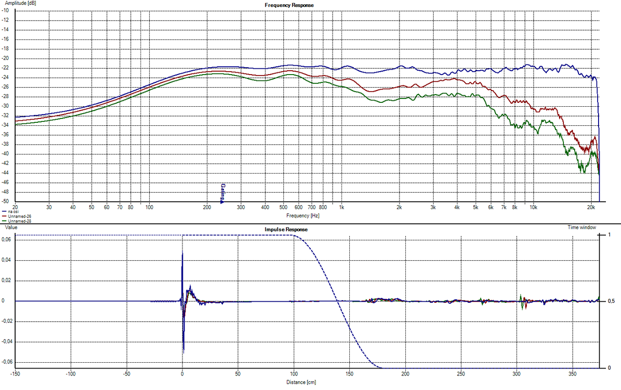

Sorry I wasn't more clear, but your response was still illuminating. I was thinking more about the bass response in the bookshelves. I'm thinking about how you measured them and accounted for boundary reinforcement in the bass so that when you put them in the bookshelves they would be properly balanced.

Bookshelf by size not by role. Maybe i should have wrote "standmount". Their place is on the bookshelf only when my little daughter is in the room.
This is a full baffle step design with F3=45Hz and it merges with the room quite nicely. I did recommend (maybe not on this forum) that their placement shouldn't be in the corners but they don't mind being close to rear wall.
