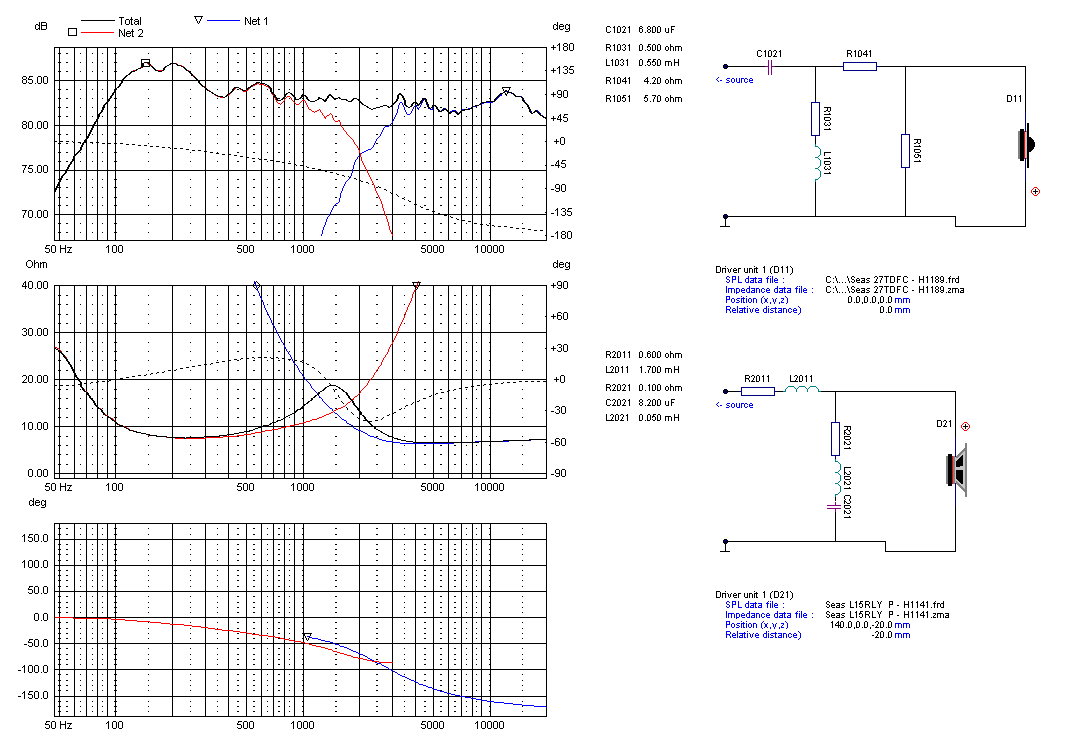

Here is xover for Zaph project 12 (Seas L15RLY/P and Seas 27TFFC). The guy who drawed it used TDFC but kept the original Zaphs xover.
The TDFC is essentially the same tweeter as the TFFC, but with a plastic surround, so should work just as well in this design.

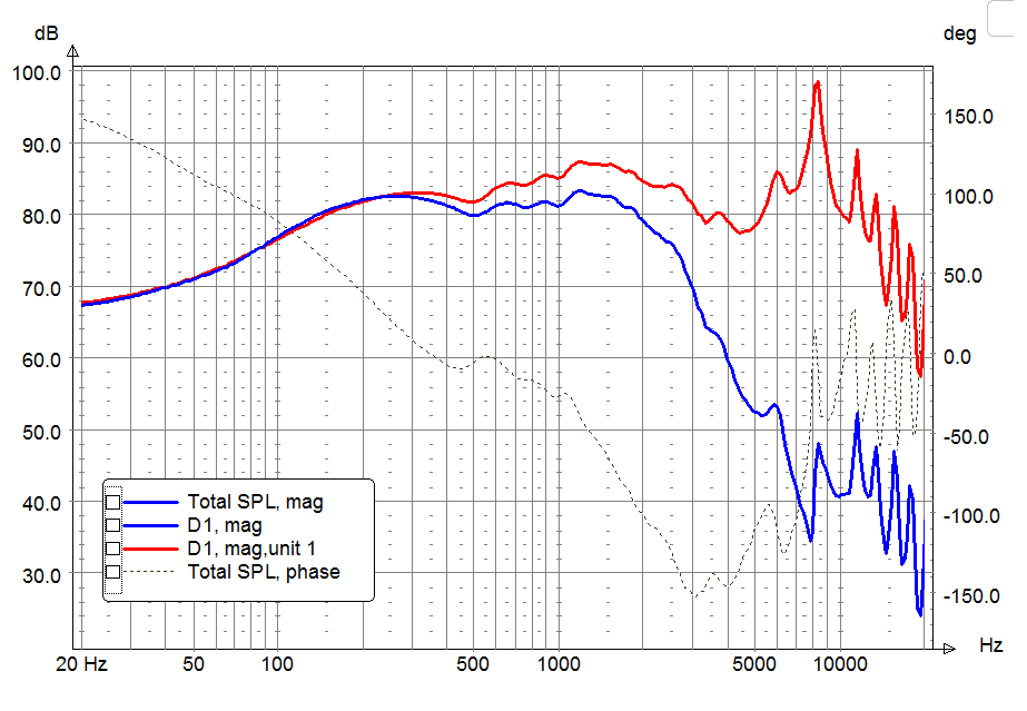

I don't know where you've "bought" this kit since it was free for quite some time and available on Zaphs website - but Zaph did decent job suffocating the resonance. This is measurement of my L15 in 17.6cm wide cabinet with Zaphs xover from your image. Resonance is not an issue here.

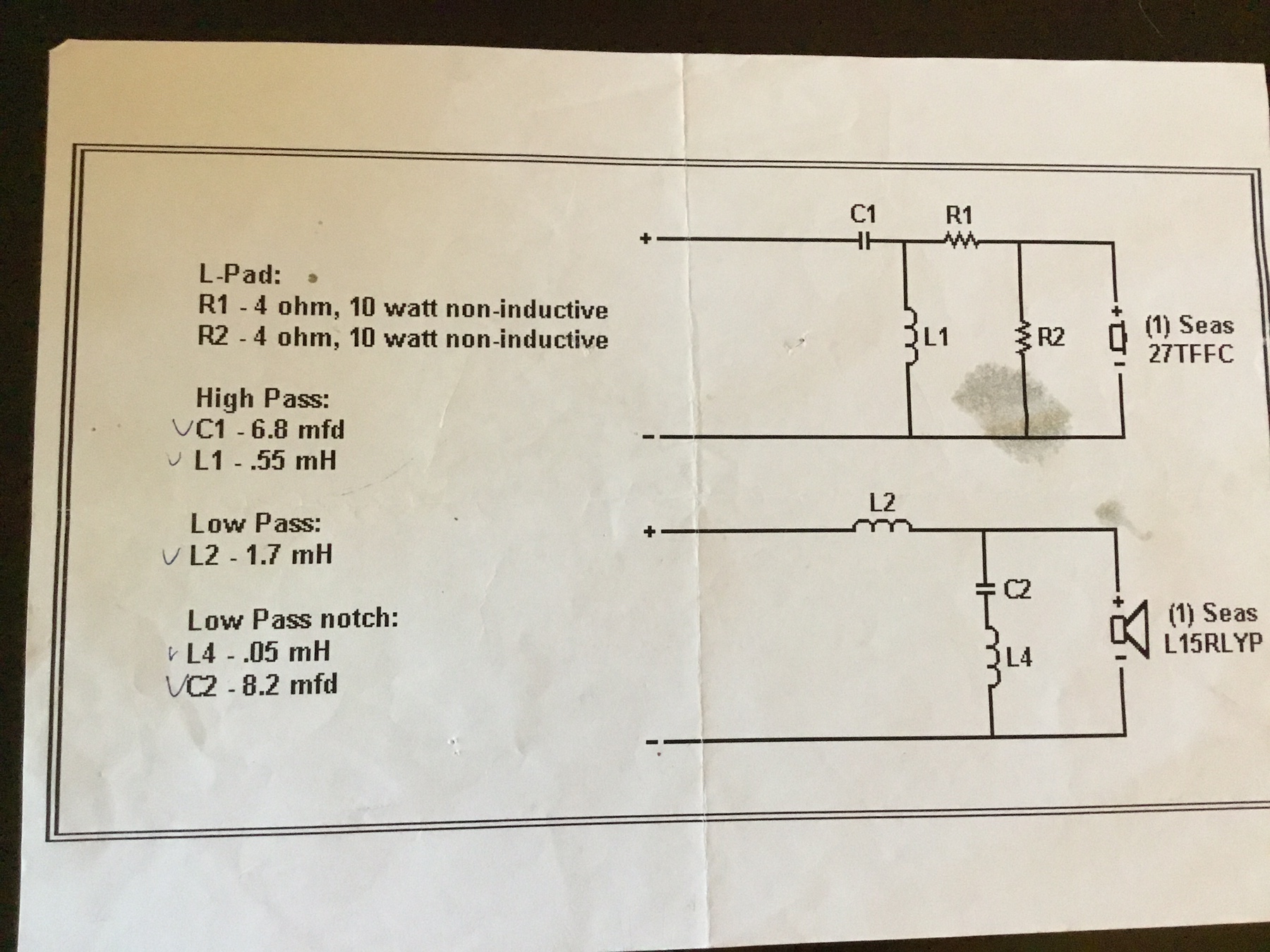

I bought this kit in a store
Is this a Zaphs crossover?
Yes this is Zaphs crossover. With mild change of values of resistor. Everything else is the same.
I have different crossover because i use different tweeter and approach but with the same goal - flat frequency response and as low resonance of aluminium cone achievable.
But i used my measurements to simulate your (Zaphs) crossover. And it works quite well. If something bothers you i believe it has more to do with the tweeter. I'd try with 5 ohm series and then listen.

Perhaps I made a mistake in the crossover construction. I remember that the coils were no identified.
Thanks for your help.

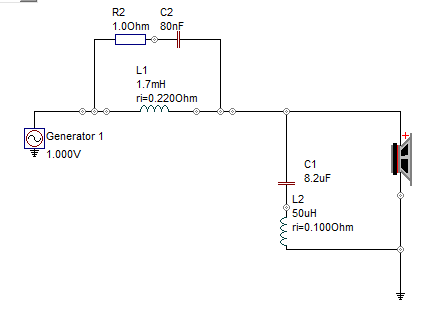

1.7mH can hardly be mistaken for 0.05mH coil. Biggest coil is the one in series with midwoofer, smallest coil goes in series with 8.2uF and then shunt with midwoofer.
The middle one is for tweeter.

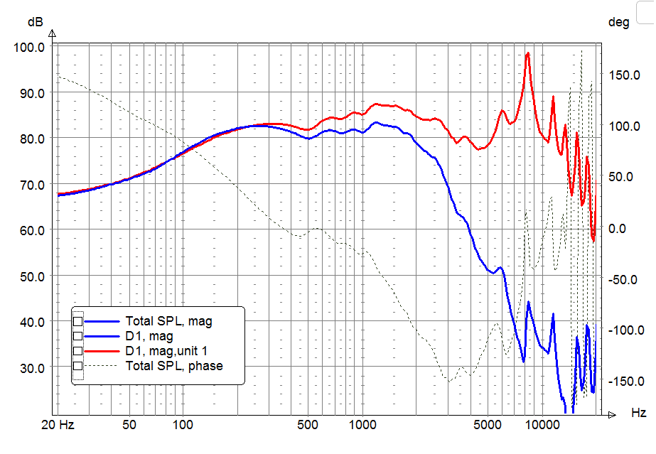

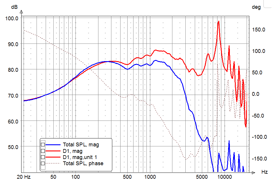

If you want to push the resonance even more, ad few components. R2 and C2 to be exact. C2 you can make by connecting 47nF and 33nF in parallel. It's quite cheap and brings improvements. It looks like this:
