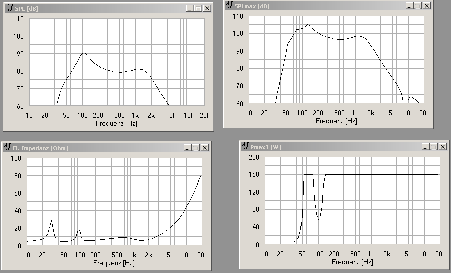

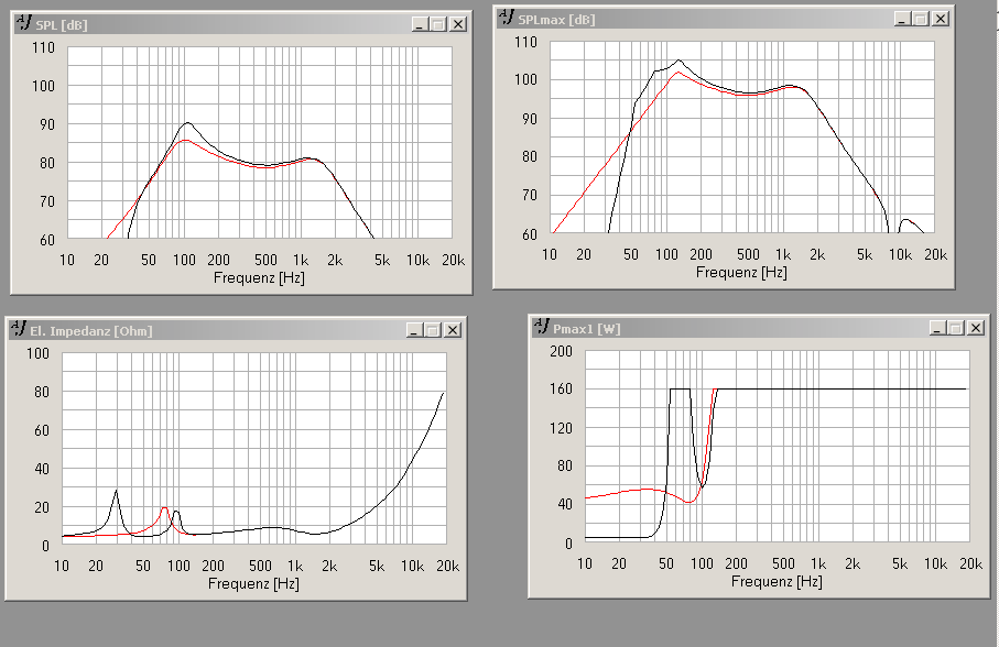

I think they are showing some wrong measurements of the low section or better they did not show the combind curve from the port and the woofer, just the woofers themselves...
Because if you model the speaker with the network and the portlength and size plus the volume (roughly 9 liters netto) you get something like this for the "bassresponse" (black curve)
But when you model the woofer with the network in a closed box by given size, (the red curve) than the curve goes a little more in the direction of the measurements shown in the file of the "assembled speaker" in the pdf.
But this is in both cases no bass at at...
Just to show that the woofers are capable of producing significant bass i simulated it with an other internal volume and a bigger port (the blue curve)
To put it simply the given box is way to small for the two woofers and should be rebuild to a bigger size which can be added juts by making it to a "small" floorstander without changing the width!!! because than you have to redo the network!
The simulation of the blue curve is for box with 32 liters and a port size (same port place) doubled the actual (2,6 cm instead of 1,3) and about 0,7 cm shorter than he original.
That should fix the problem of the lacking bass and for the lower middleband because now you just have a oversounding pseudo bass with a to reset lower middleband.
