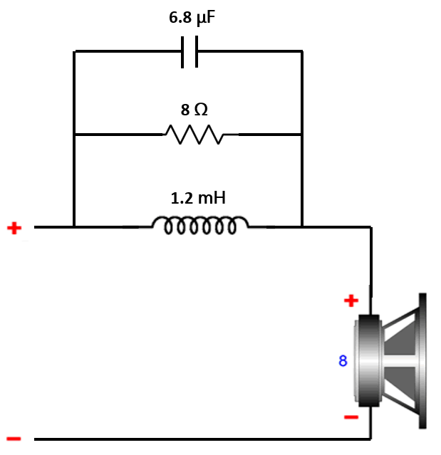

Finished a new FEA18RCZ build using the specs provided in the Seas Application Note exactly. Great sound except for the extremely bright top end. Not really listenable at higher volumes. Seas recommends to install an inductor/resistor circuit, and recommends using 1.2mH and 18 Ohms. I had a 15 Ohm, so I used it instead. Now the highs are severely attenuated, and not really listenable. Almost as if you removed the tweeter from a typical 2-way system. Do you think that using a 15 Ohm instead of the 18 Ohm made much of a difference? I wouldn't think so, and if anything it would have attenuated the higher frequencies less than an 18 Ohm resistor. Seas states that this design "offers the listener a loudspeaker system with a precise, coherent and engaging listening experience using this high quality driver." I attached a picture of the assembly I put together for testing. Thanks for the help!

You can of course play with the values and adjust to taste. Addition of a capacitor (in parallel with the R and the L) will bring the high treble back. Try some values between, let´s say 3,3uF and 6,8uF, and listen. Try cheaper film types first, before you invest in a decent cap.
Or get some measurement equipment, measure and correct the FR accordingly. A correction circuit for a fullrange driver might than in the end be much more complex than the SEAS´ suggestion, which nonetheless is nice for a start.
If you measure, a slight treble rise is nearly always wanted with a FR unit, to counter the directivity of the large cone and to remain a proper room response.

if you dont have any of equipment described above.. take a cheap way.. buy 5W resistors, 6.8R, 8.2R, 10R, 15R.. and try to put in parallel with the coil, one at a time and listen..bigger resistance - less top end.. lower resistance - more top end..

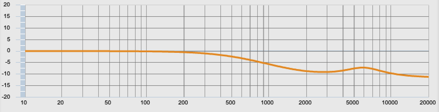

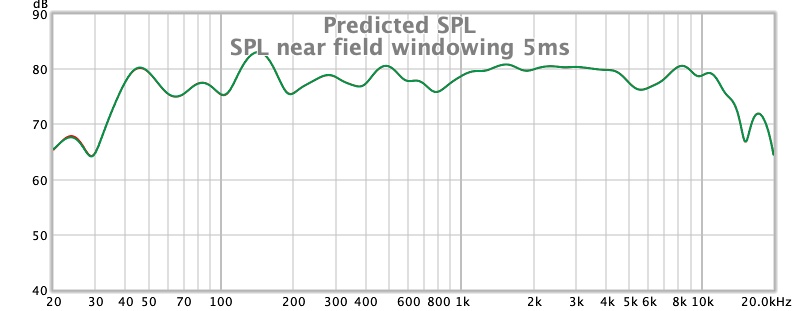

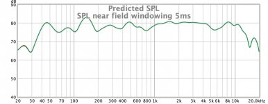

Hi-I used the 6,5" Seas driver in a project two years ago.
Now, I did build it as a sealed enclosure, I just like them better, and I use a MiniDSP to linearize the higher frequency area. In short, the speaker is very good, it makes my Alpair 7.3 bassreflex build sound like a toy.
I think, however, that the speaker is quite well suited for DSP adjustment. I have attached the adjustment file (graph) and a nearfield windowed measurement, not smoothed.
You're right. You can parallel 15 ohm resistors with each other to make a 7.5 ohm and try that, if you have more. The bsc calculated always has to be modified in the resistor by ear, even a couple tenths of an ohm seem to make a difference. Not sure what seas' selecton methodology is, but keep iterating different resistors until it's the best you can get it, like bepone suggested.

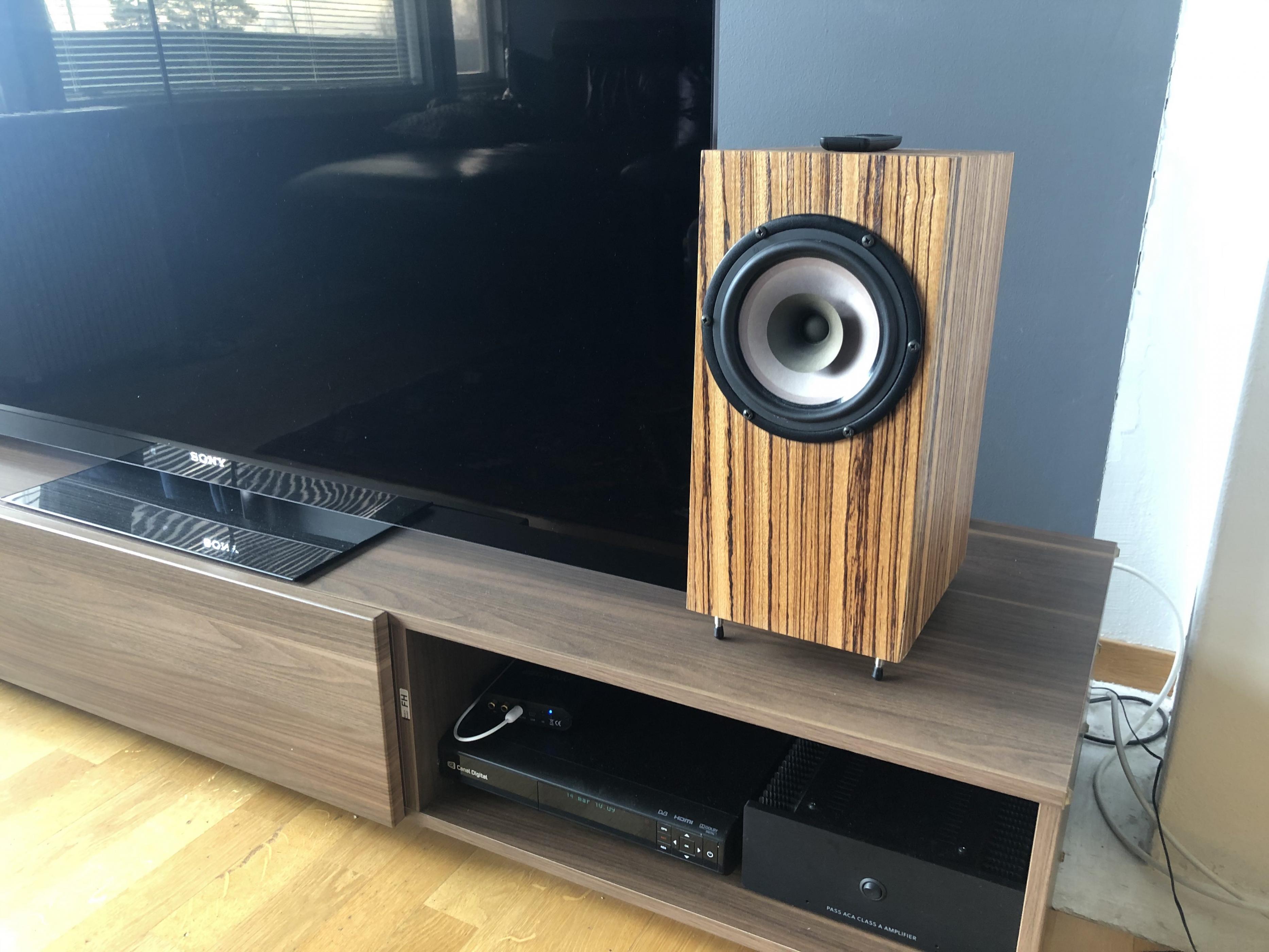

The loudspeaker measures better at home than the graphs produced by Seas suggests. So please don´t be discouraged, it will be good. I suggest using REW so you know the effect of your adjustments:
- Measure at different distances 50 cm, 1m, 3m etc.
- Use windowing function
This will help to understand the "bigger picture", what are diffraction issues (not adjustable), and what are driver deviations (you can adjust them). As you can see from the picture, I use the loudspeakers in a setup with my TV, which extends the baffle. This reduces baffle step issues, and results in a "fuller" sound.

Thank you all for the help. Through trial and error (using my ears) to find a suitable sound I like, I ended up with a 4 ohm resistor in parallel with the 1.2mH inductor. Much more efficient than my P17/D25 build from a few years back, and a bit different "sound". I would like a bit more highs above 10K without boosting the range between 5-10K though. Would adding a capacitor in parallel with the network I have take care of this? More trial and error is required I'm guessing, which is ok. Thanks again!

SEAS FEA18RCZ Build Update - Success
Thank you all again for the help, I couldn't have done it without your input. I kept at it, and after even more trial and error, I settled on a network of 1.2 mH inductor, 8 ohm resistor, and 6.8 uF capacitor. I know everyone has individual tastes, but for me this sounds great, and I would encourage anyone to try it. Thanks again. Now I can finish the cabinets and enjoy!

Great if it sounds great!!!
And yes, that´s exactly how in my opinion wideband drivers should be used, with a sensible correction. If you choose high-quality components, there´s no reason to be afraid of passive components in your speakers.
Depending on your needs, the LCR correction can be finetuned with parallel notches, but that would require measurements and more experimentation.
