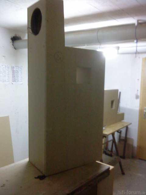

Well, to get the ball rolling, here's a Vb = Vas, Fb = Fs MLTL.
Internal dimensions = 56in x 10.5in x 14in (HxWxD). Zd = 21.125in. Zvent 54in. Vent 4in diameter x 3.5in long. Line box top, back & one sidewall with acoustic fiberglass or similar & adjust damping quantity and / or vent length to tailor to your system / room / taste requirements.

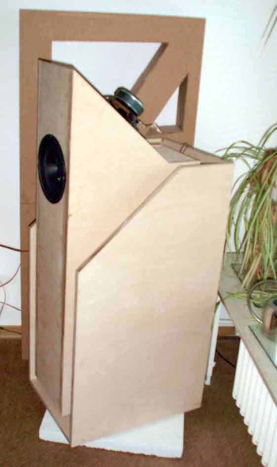

Hello,
i would prefer my double horn for that driver:
SAXOPHON, POSAUNE XL, RDH20
with a second driver e.g. Monacor SPH-210
Bass 34 Hz, lowest membran movement,
best IMP for Tubes.
Hello,
best IMP for Tubes.

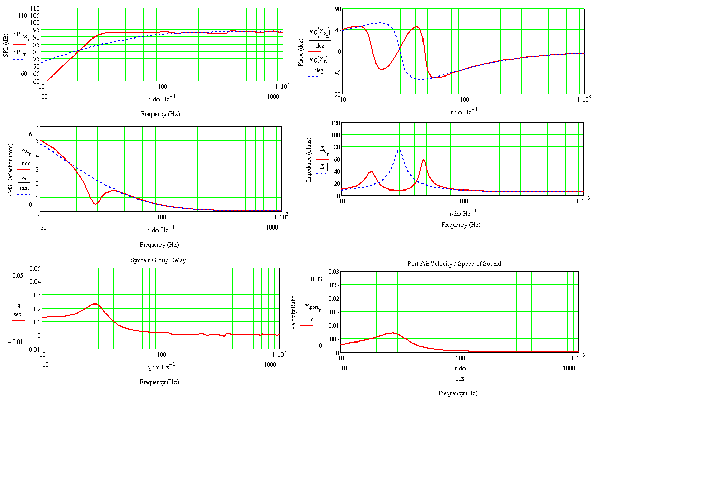

Whilst I agree with the recommended sealed box loading, I don't the vented.
Around 90L tuned to 28Hz will give ~ +6dB more bass at 30Hz and maximise
the efficiency below 100Hz, which is want you want for limited valve watts.
Unlike e.g. Lowthers or Fostex's, the excursion capabilities look quite
good, so a vented box may be all you need to use the driver very well.
Due to the low tuning above, IMO nothing more exotic will be needed.
Note the response shown includes the BSC effects of 60L closed box.
I severely recommend EQing at line level rather than an inductor and
resistor at speaker level, this will rob you of precious valve watts,
(to a degree, it also gives a very easy midrange and treble load).
Build something like this into the end of the power amplifier lead :
Baffle Step Compensation
http://www.diyaudio.com/forums/multi-way/89428-fixed-line-level-bsc-based-rod-elliots-circuit.html
It will be far more effective, Any EQing will increase the dynamic range.
