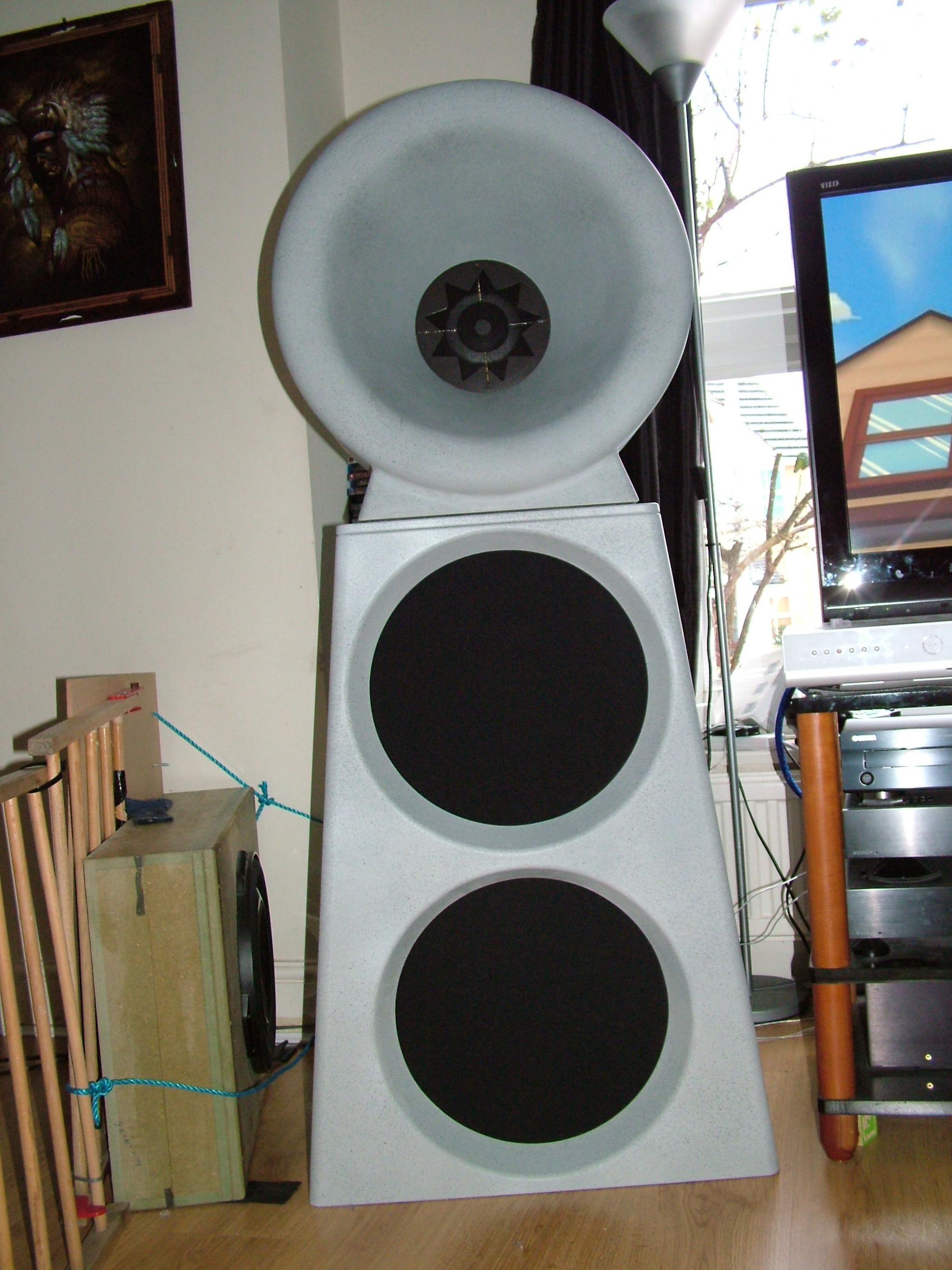

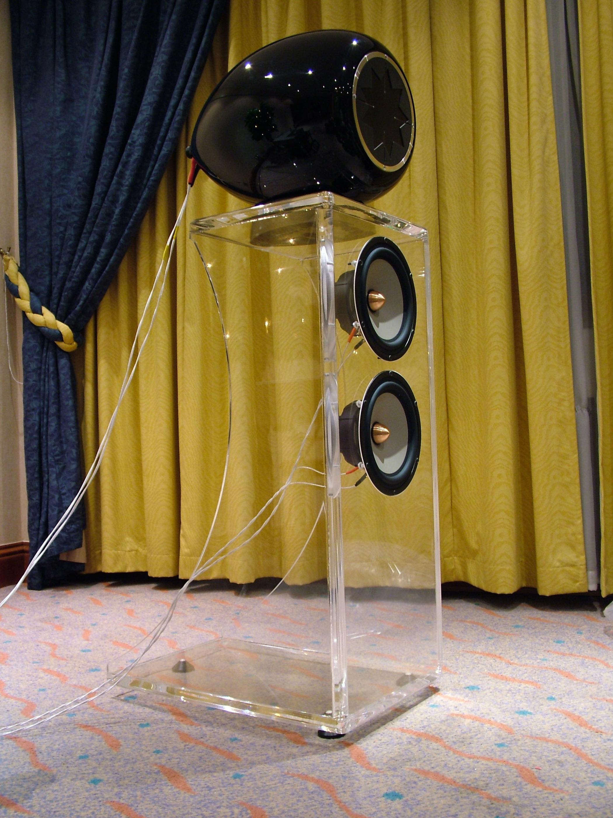

Hi Architect,
Congratulations, nice system!
I also really like the 8 inch Seas Excel W22 driver in open baffle.
I got great results with a Variable Path Length ( sadly VPL !) which added slam, depth, texture, detail, extension....You name it if its good you got it with the extended side cheeks with " Shark Bites" taken out of them.
Basically you get all of the advantages of an extended rear H frame with none of the disadvantages ie all tghe good stuff above without any cuppy male vocals and muddy bass.
The " Angels " pictured in Acrylic and Corian were only 365mm wide but the 500mm to 220mm variable depth gave an average effective baffle width of nearly 1 meter. They went all the way down to 34 Hz, flat, and sounded really great.
The last pic was a Volt 2500.4 in a small VPL baffle, from 100Hz to 500 Hz...Wow!
Hope this helps and all the best
Derek.
PS Just a suggestion, how about 4 W22 per side in a VPL open baffle and crossover at 50Hz to your big AE drivers...You might even find you dont need the big AE drivers anymore and can sell them, pocket some cash and save space in your room? Just a thought!

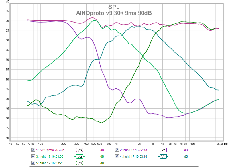

architect7,
if I can look right at the scale in the picture, my slopes are close to LR2 (12db/octave) acoustically.
I am using minidsp, the software (electrical) slopes are far from these, because dipole transducers have -6db/oct attenuation in the low end of range. HP slopes in minidsp can be 6dB/oct for dipoles!
Some other people have noticed that mild slopes work better, the transition from a driver to another is "softer", which helps to get dispersion changes softer too. And yes, you can kind of hear that.
You must check for phase too for each xo! Invert phase and run test, adjust delay. Also please measure at 30¤ and 60¤ angles too! I have used 30¤ for reference standard.
See my post #162 http://www.diyaudio.com/forums/multi-way/231353-aino-gradient-collaborative-speaker-project-17.html and so on! the xo at post #162 is not final, I made slopes even less steep, post #165

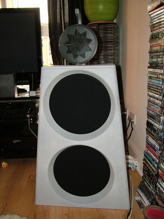

Interesting and a nice aesthetic too Overkill. On the Volt, was eq used for the low end? Any bracing in the Volt VPL? I have a BM251.3 that this arrangement might work well on.

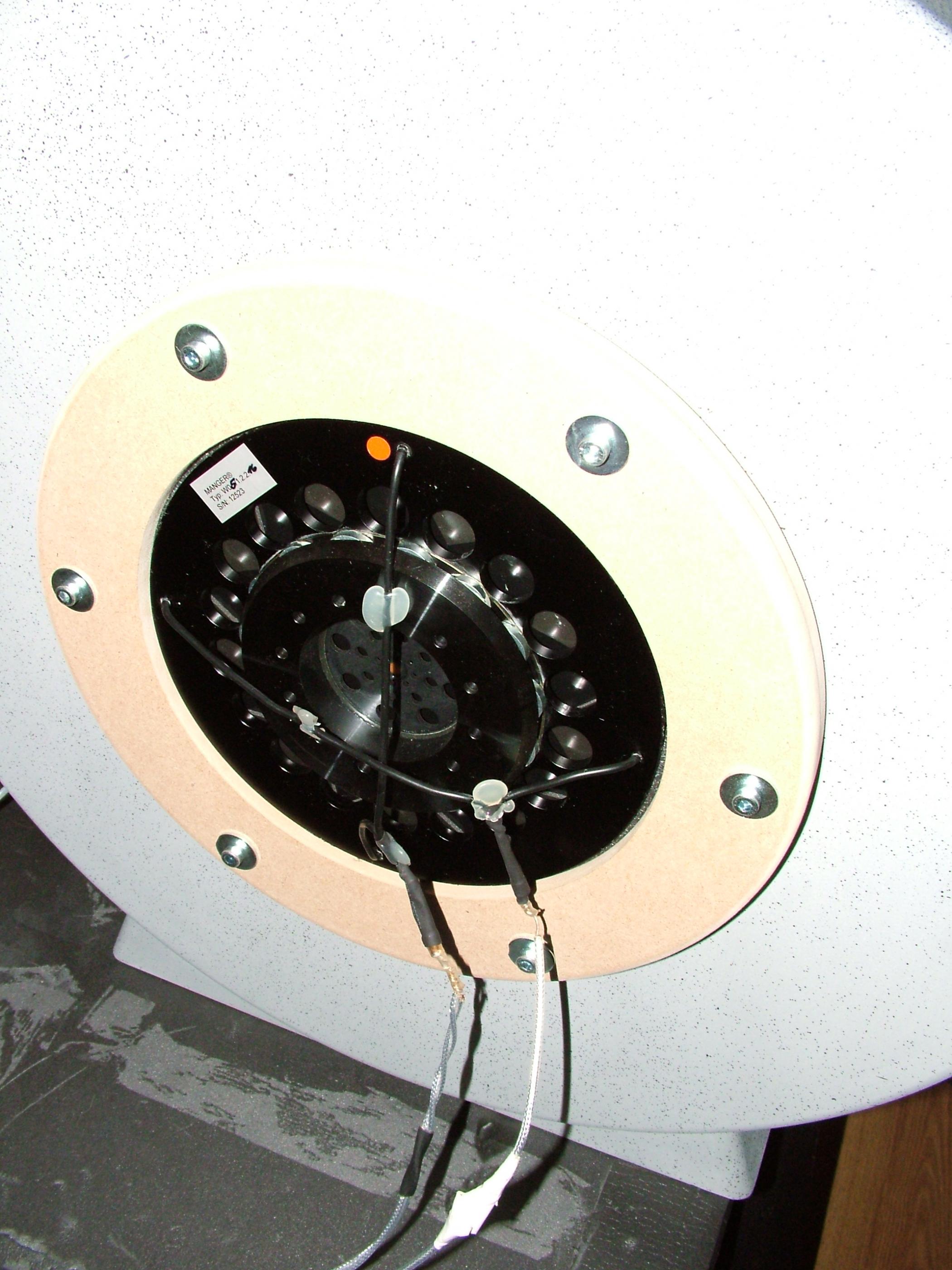

Volt in VPL

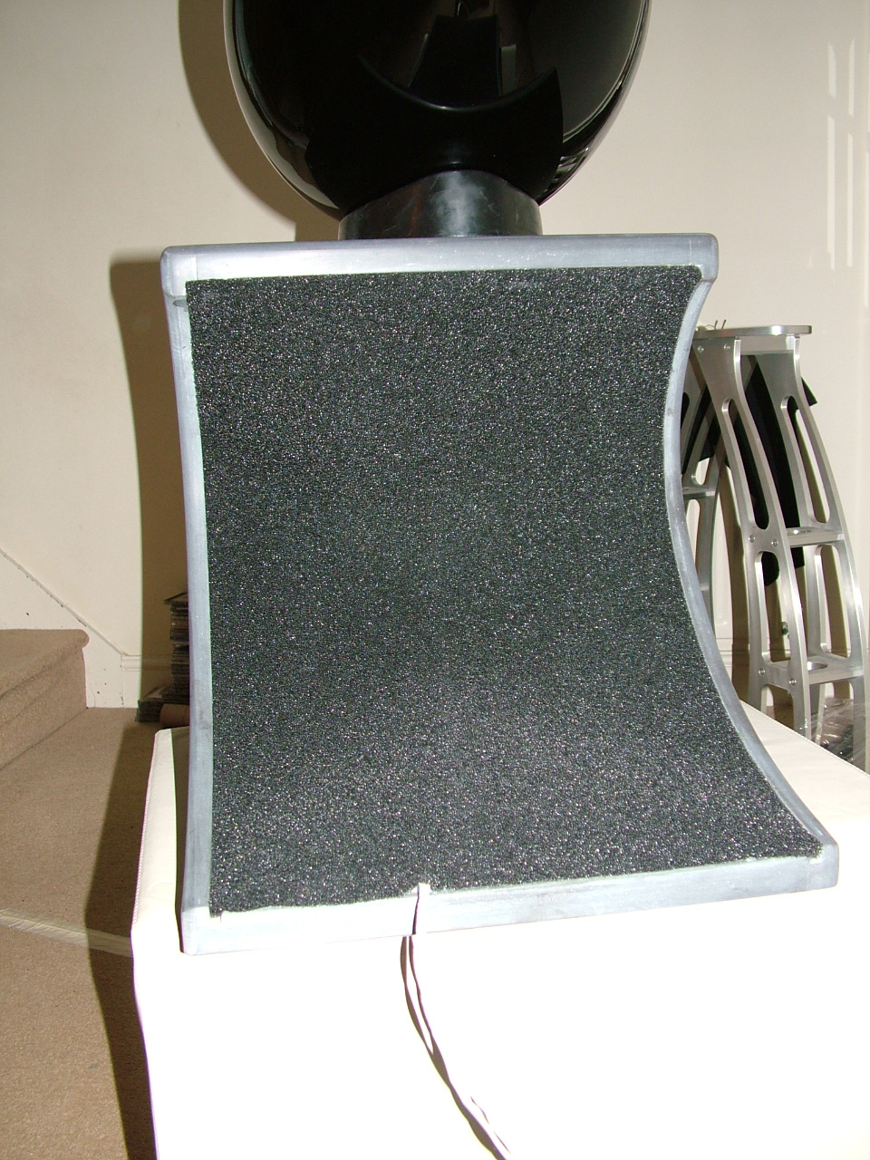

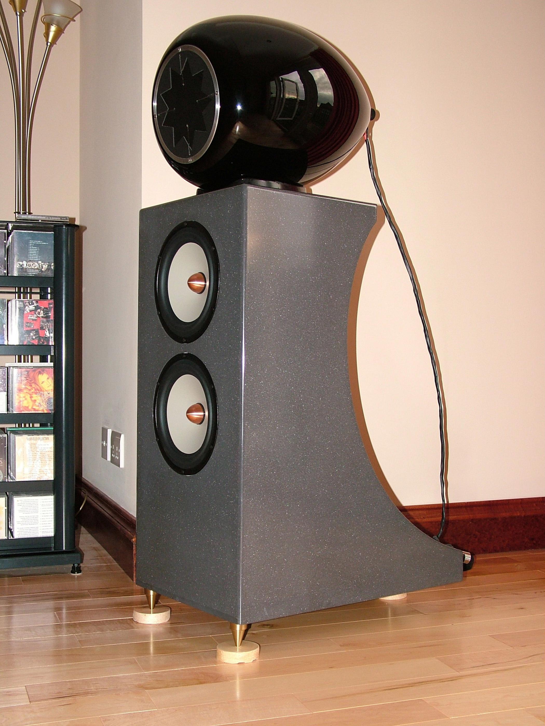

Hi Toaster,
Thanks, glad you like the asthetics, I think speakers need to look good as we spend a lot of time with them...Just like wives really!!
The Volt BM 251.3 is a slightly more sensitive version of the BM2500.4 ( where does he get those model numbers from?) with a higher Fs.
It should still sound great in a VPL style open baffle.
It all depends on the size of baffle / depth of the side cheeks but you can get good response down to around 100Hz with no Eq and a similar size of baffle to the attached.
You can then add some Eq but I advise caution ie not more than around 5dB to 6dB boost at around 70Hz to 80Hz as you will run out of Xmax quickly.
The real advantage of this VPL is that it gives you lightening fast transiets and super clean low midrange, this VPL and Volt combo is not designed to do bass.
I'll post a couple of other pics of a 15 inch Beyma and Precision Devices for sub 100Hz.
Derek.

Bracing
Almost forgot, no bracing required, the cabinet was 20mm thick Velstone, synthetic marble like stuff similar to Corian...It weighed 28Kg before the 8 Kilo Driver!
Cheers
D.

Thanks Derek. The application is similar to yours, midbass from 100Hz or so up. Just prototyped a fairly shallow stuffed box for the Volt. FR is good but it still sounds 'boxy'. Don't want to drag this OT, but this info should be useful for the OP too.

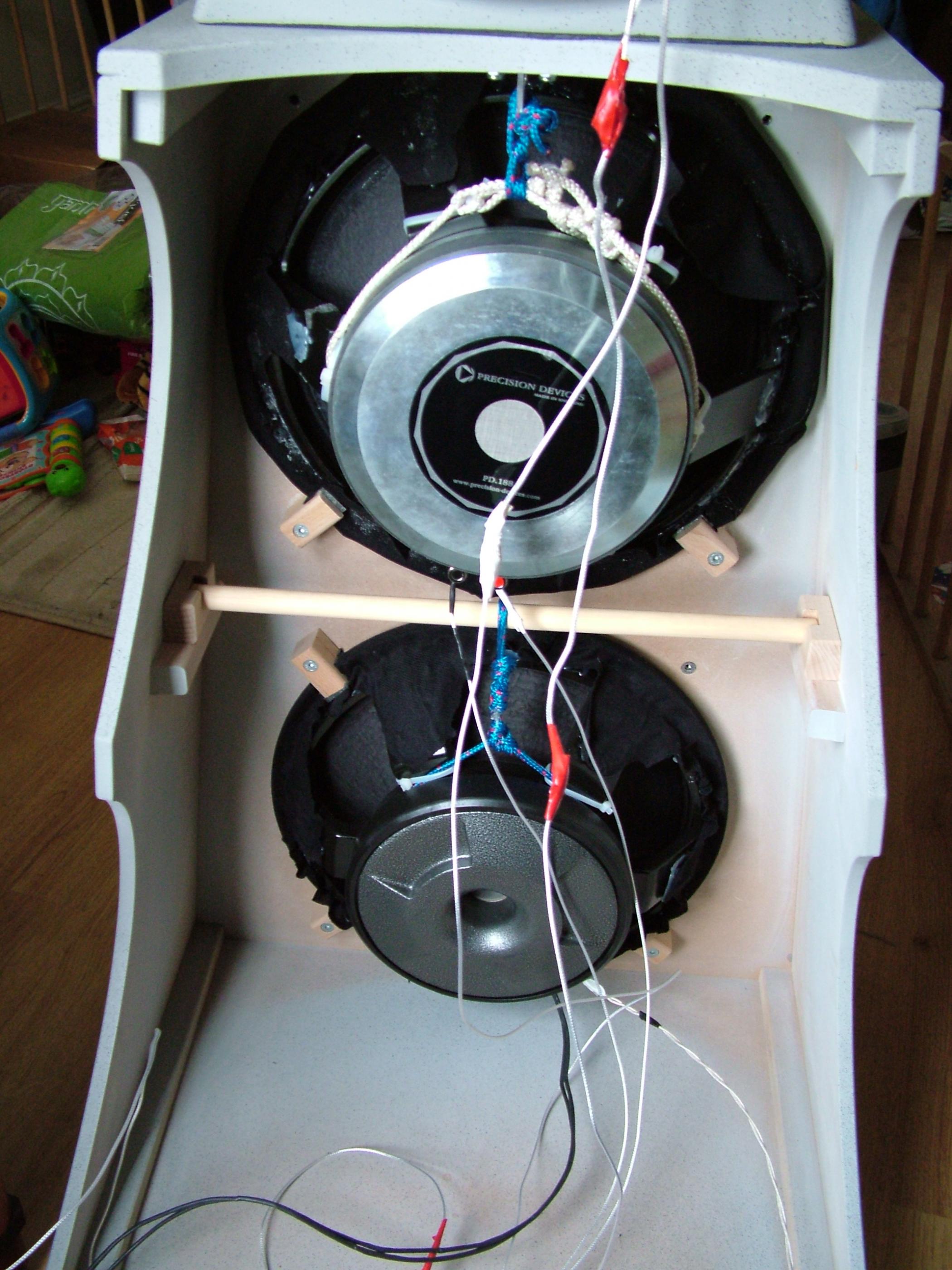

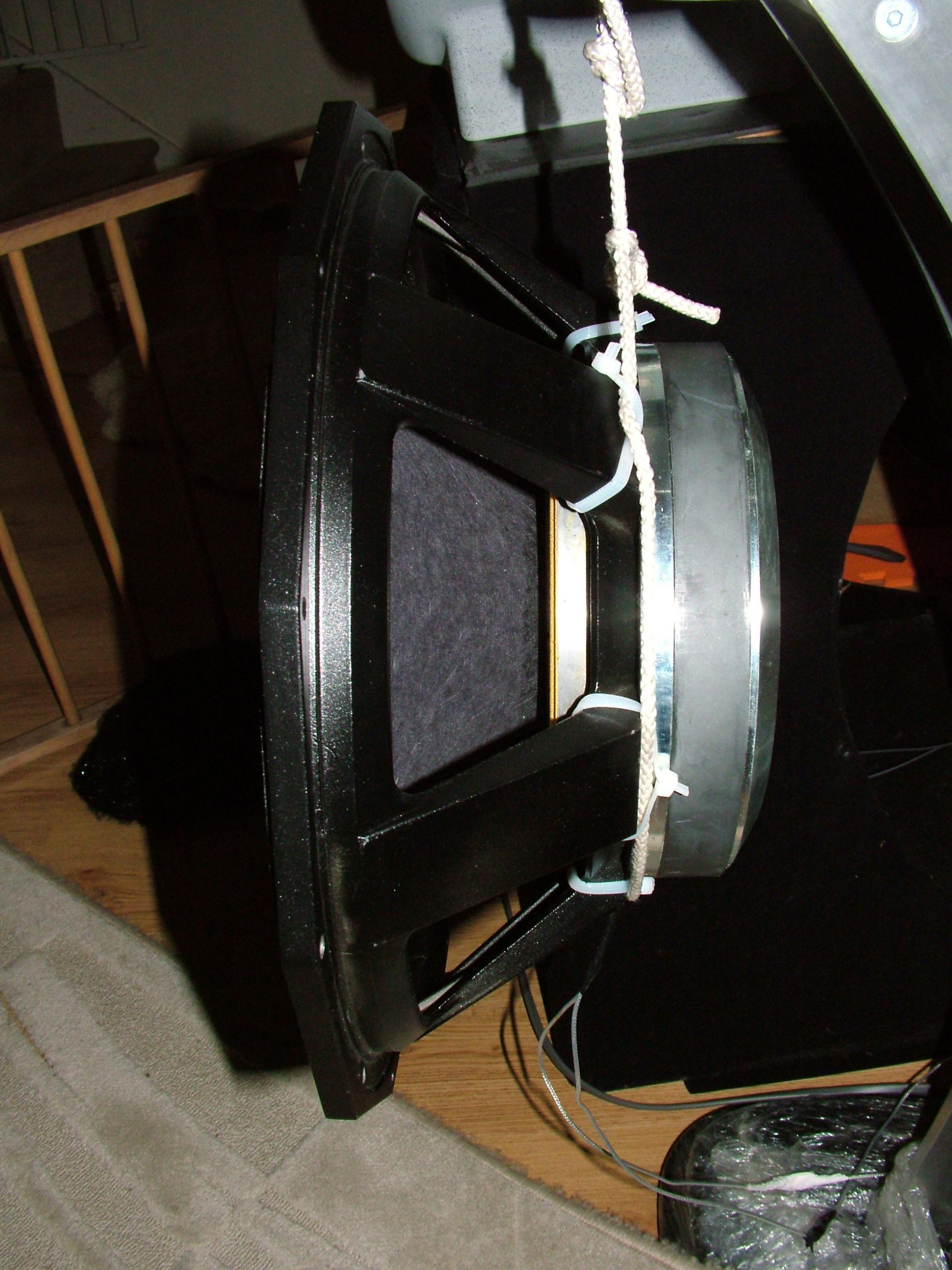

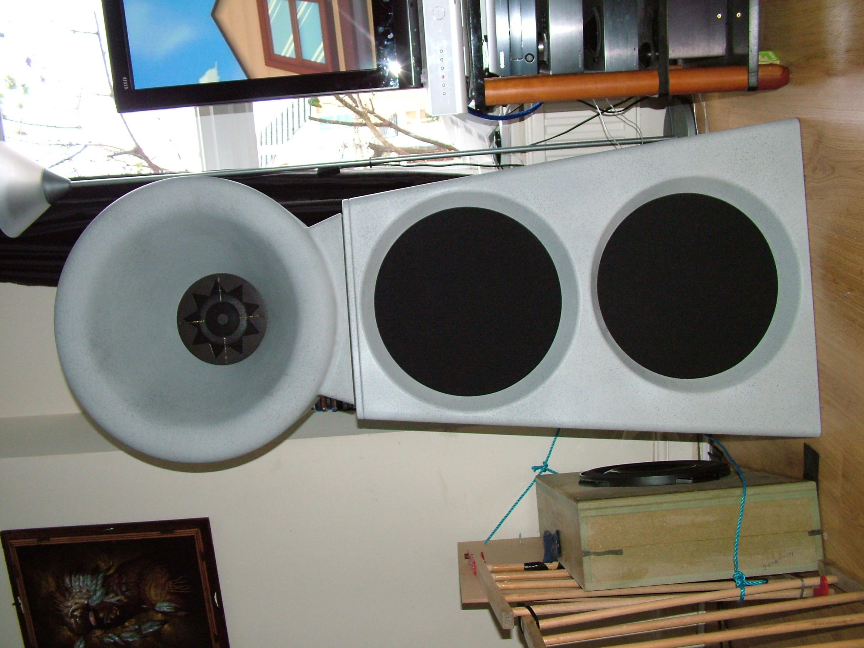

VPL bass
Here are some pics of a VPL bass system using two 15 inch pro drivers, a Beyma 115K and a Presision Devices 158 bass mid.
I run the Beyma from 80Hz to 25 Hz with some Eq boost and the Precision Devices from 80Hz to 400Hz then the Manger driver up to 20KHz.
The cabinets were light weight, only 18mm MDF, but the big drivers were not bolted to the cabinets and they did not actually touch the cabinets. I suspended the drivers ( not very pretty, but it was later covered with grill foam) using soft polyprop cord and used 10mm thick sorbothane gaskets around the drivers front and rear edges ( the driver were rear mounted) and small beech wood blocks to guide the drivers into place.
The Manger was also suspended and also ran open baffle, later used a giant horn to add about 6dB sensitivity to the Manger.
Even at very high SPL there was no cabinet vibration...really great way to go.
Cheers
D.
