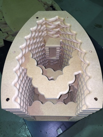

But it's actually not the only game in Town. Harbeth hardly ever use a brace!
YouTube
This is light box construction with damped panels. 50 litres at 2:1 ratio. It works! Alan Shaw explains it.

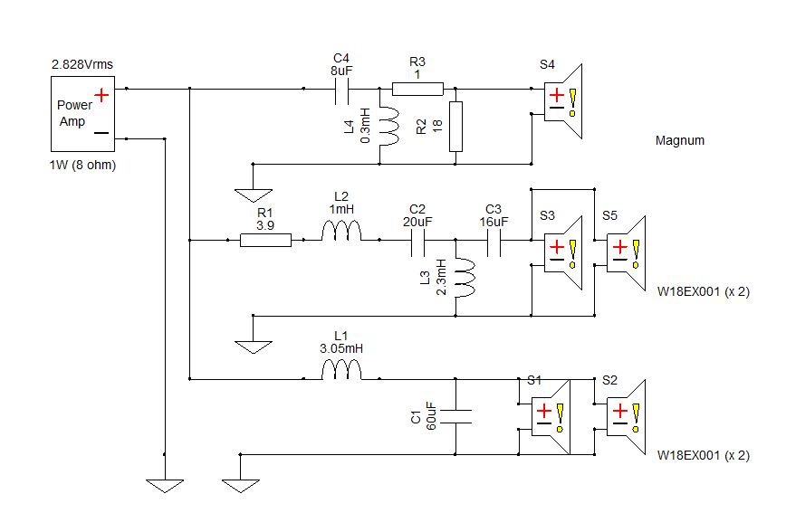

A short presentation, our ongoing project w/ Seas driver in question:
Preliminary crossover,to be verified. Mids closed, Qtc 0.71. Woofers BR at 38 hz

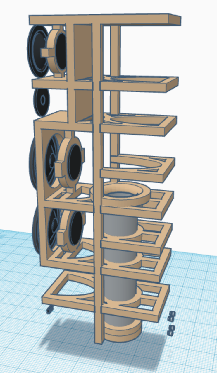

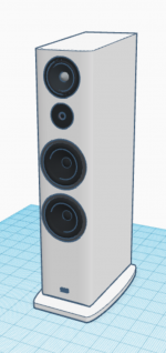

Yes I do have the skills to build that enclosure and I'm not working on own my as well. I'm building the cabs at the workshop of a friend of my dad, he's a very good woodworker. I've made some speakers with him before and I didn't even have to fill up the edges because they were so tight.
I know there's other way to construct a cabinet but all of those special techniques to build a cabinet like that what Harbeth uses are "special techniques" and I would also love to use the tech Magico or Kroma uses but they require a hell of a lot of measurements and tweaks to be made which is kinda hard you're 15 y/o diy who doesn't have a test facility to his disposal so the way I want to do it right now is the make-it-as-stif-as-possible-way. Everything is constructed from 25mm MDF with obviously the heavy bracing.
They subwoofers are mounted to the baffle and with a brace around the magnets (but not decoupled!) to couple them to the entire cabinet more evenly, spread out the vibrations and minimize baffle radiations.
The midrange will be mounted in a similar way but softly mounted using the construction on the picture below which I designed myself.
The tweeter will mounted to the baffle the same way but without the brace around the magnet obviously.
It's a bottom port because a slot port without to many bends in it didn't fit (just believe me) and because two 7,5 cm ports were too small, one 10 cm port was too small and one 15 cm port was wayyy too big and expensive I had to use pvc pipes from the hardware store, this one has an ID of 11,8 cm, which is perfect, and I could have mounted the port on the back but the fitting PVC elbows which are ment for water and don't really care about aerodynamics to much had some pretty harsh corners in them and if I were to do it with the end on the rear it had to come in the top (so the inside end would be in the bottom) because if I were to end it at the bottom (with the inside end in the top) the coming air would go up and down again into the cab AND if the port would come out that high it would blow straight into a very tight corner because I'm in the attic and the front walls are tilted which didn't seem that good to me either.
So then a bottom port would be the best decision. It's the simplest and a straight, non-turbulent pipe, it comes out the bottom where there is more room for it to breathe and because the air is coming in and out in every direction it can breathe even more freely.
