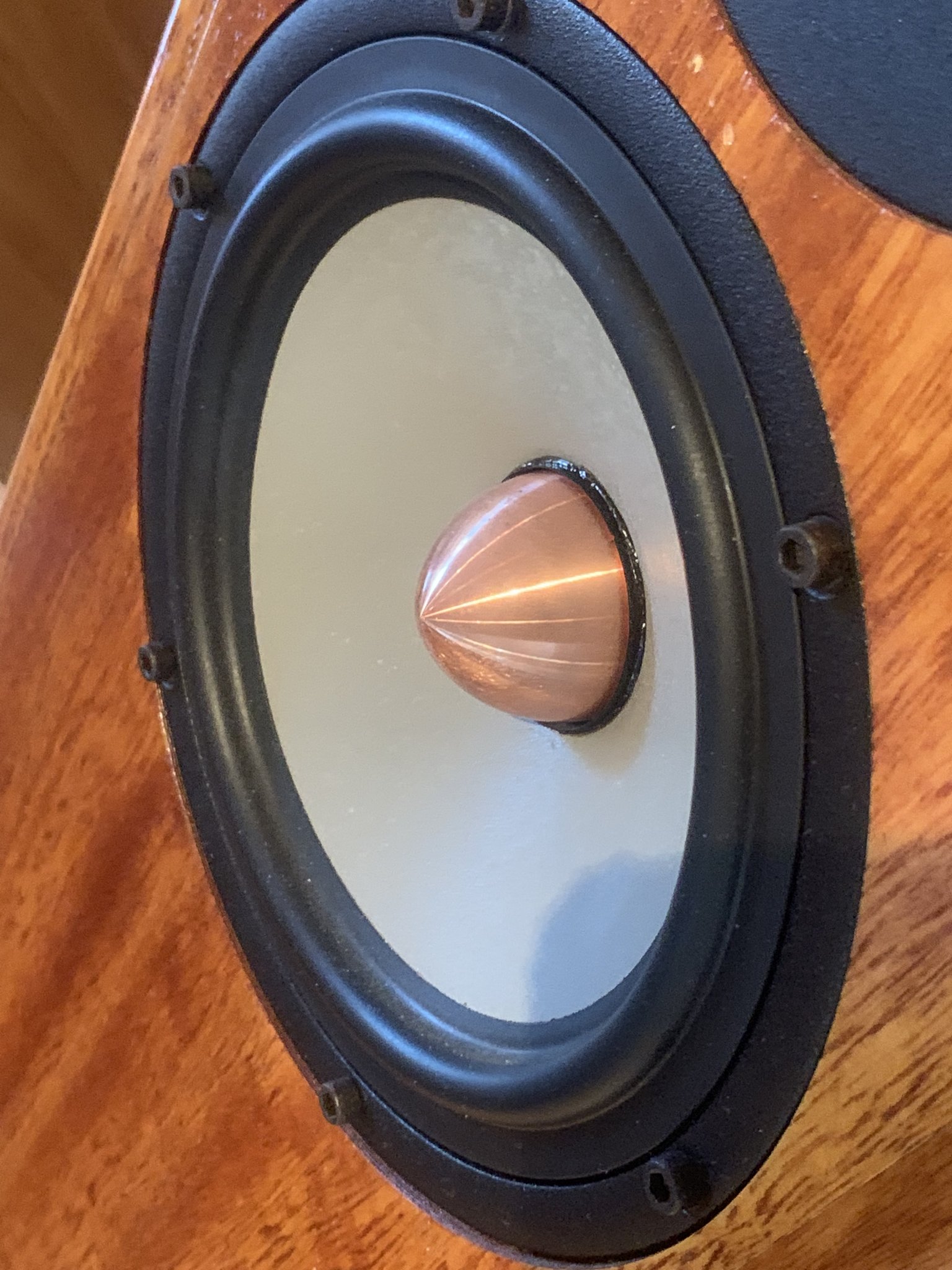

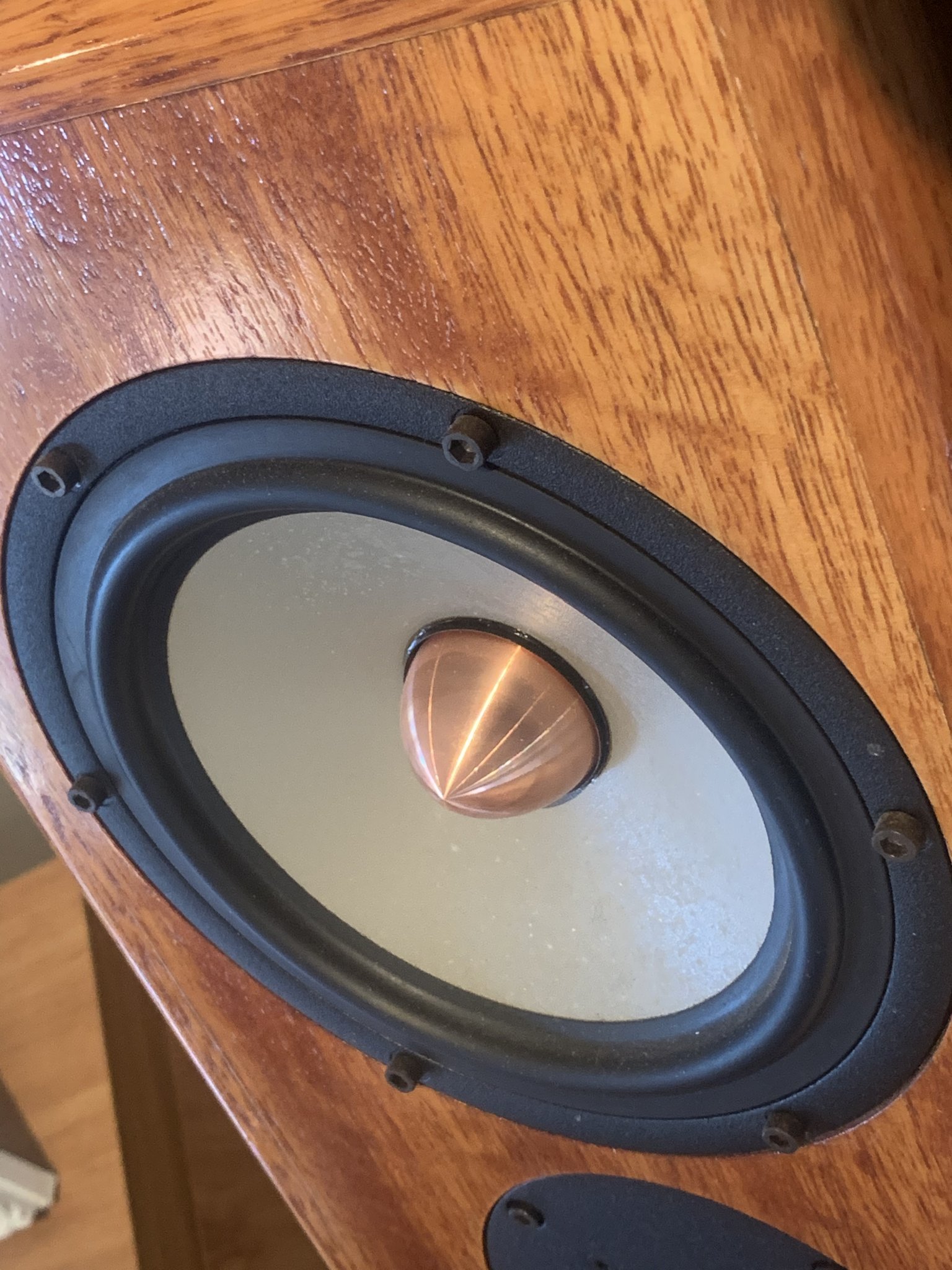

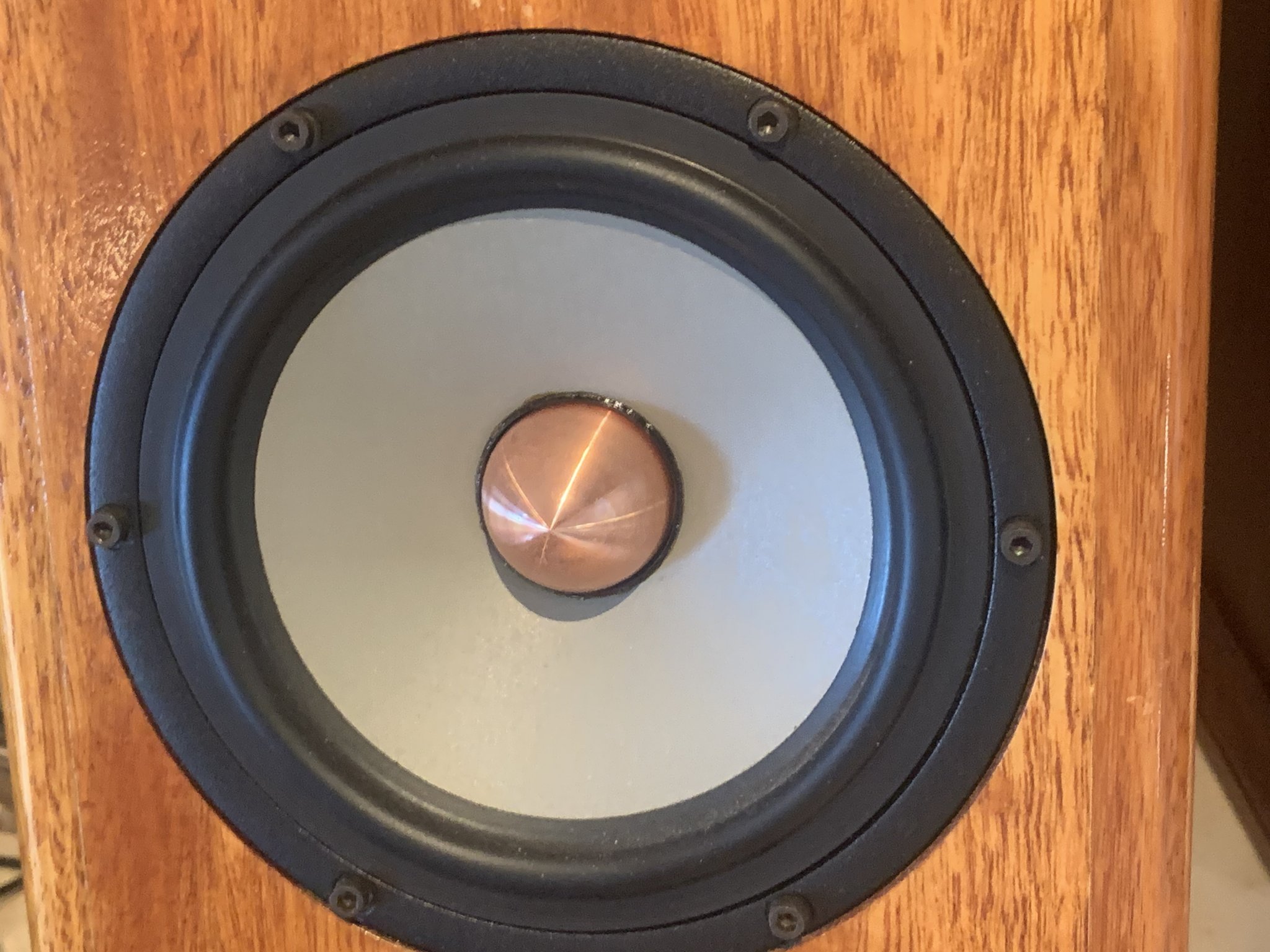

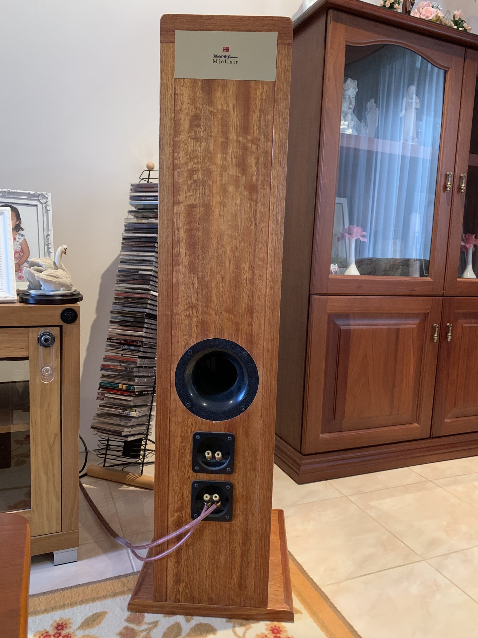

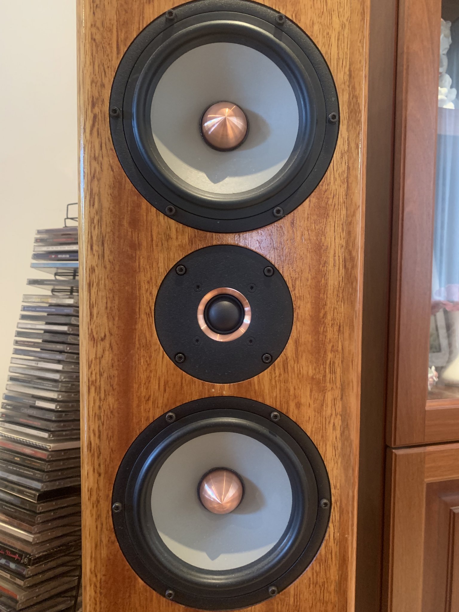

Visiting my parents during vacation and listening to some music on their speakers.
(modified Thor based speaker with reworked crossover courtesy of Jim Mitchell and my own bass reflex tuning about 15 years ago)

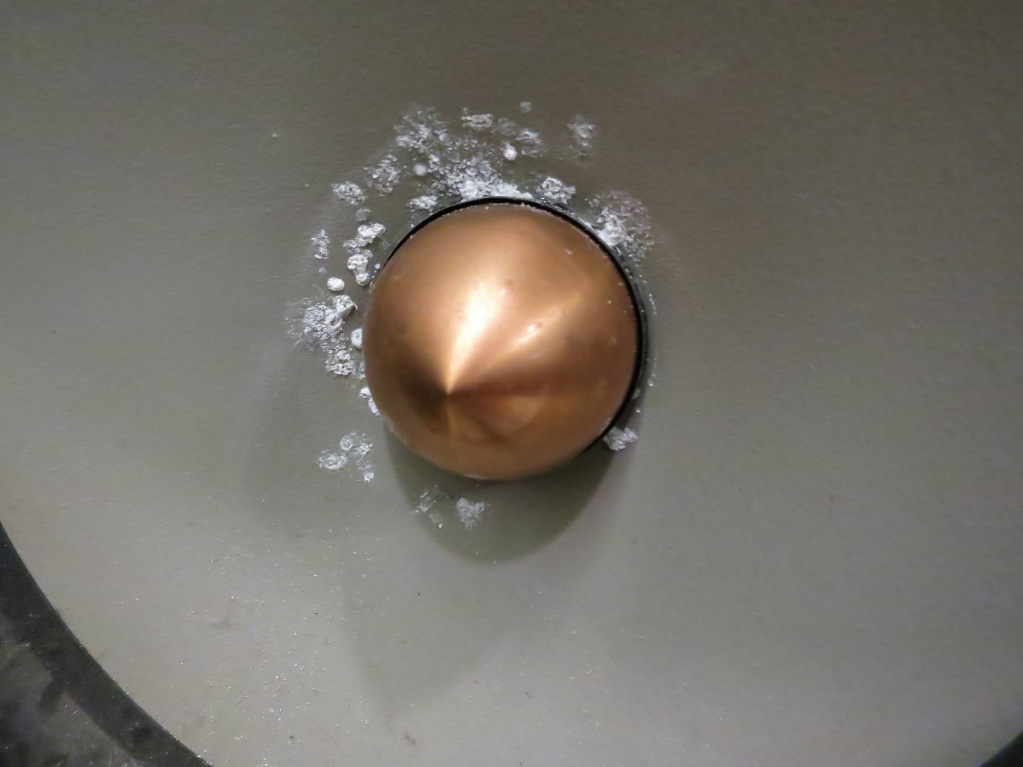

It has spent the last 2 decades in a very temperate environment in the south west corner of the world (Perth, Western Australia). The climate here is characterised as typically Mediterranean- dry hot summers and mildly cold, only mildly wet winters). It is NOT a humid climate.
Yet the degradation started on the rear of the cone about 10 years into life, now the front of the cone looks like this:
Although 20 years is a fair lifespan for transducers, cone deterioration when the rest of the driver is fine is probably not satisfactory for OEMs.
One would have to wonder how much of the graphene coating has to do with improving longevity, if nothing else.
Sooner or later these drivers will need replacement, and cost of these 176mm OD drivers is a pretty penny.

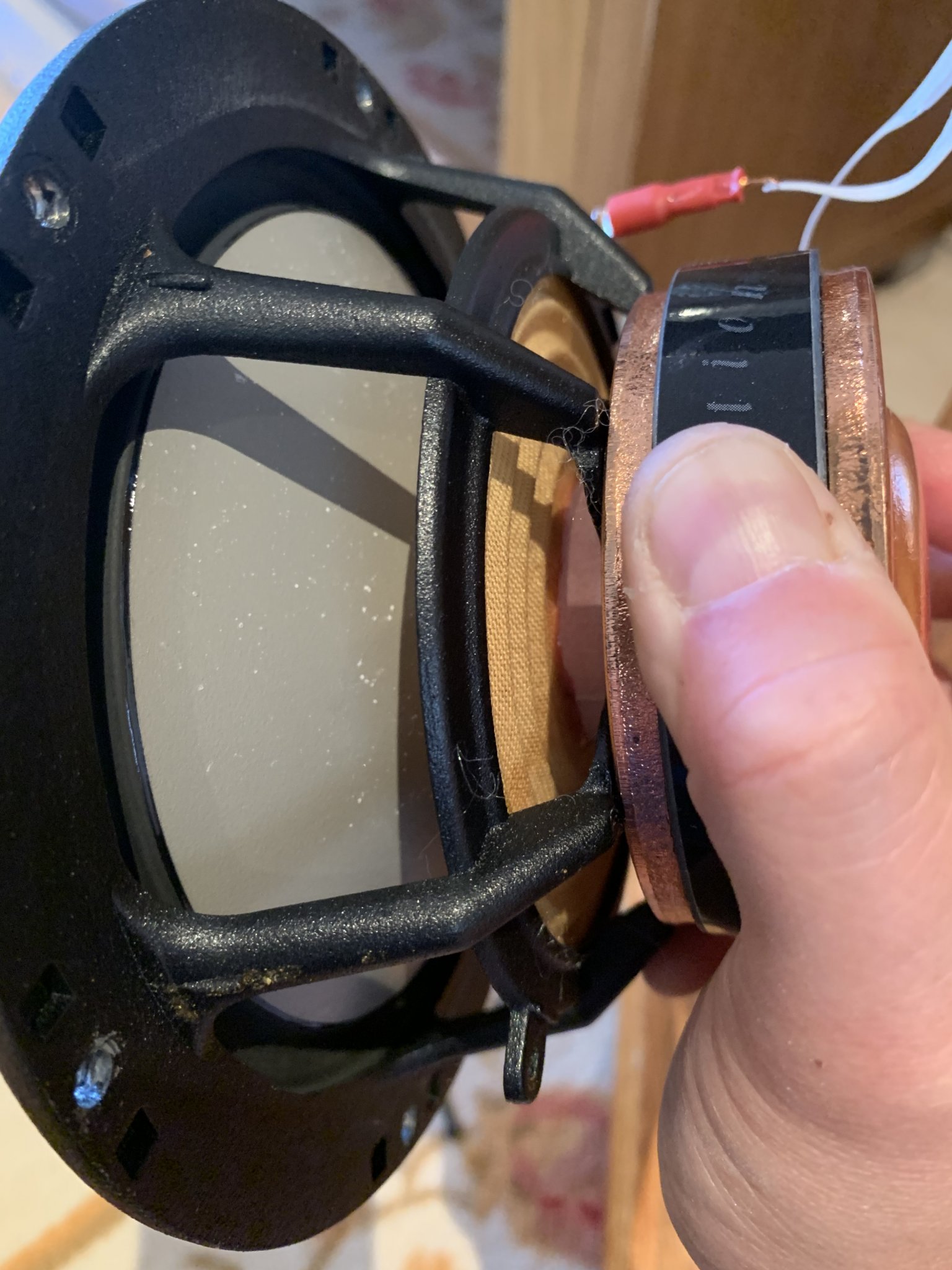

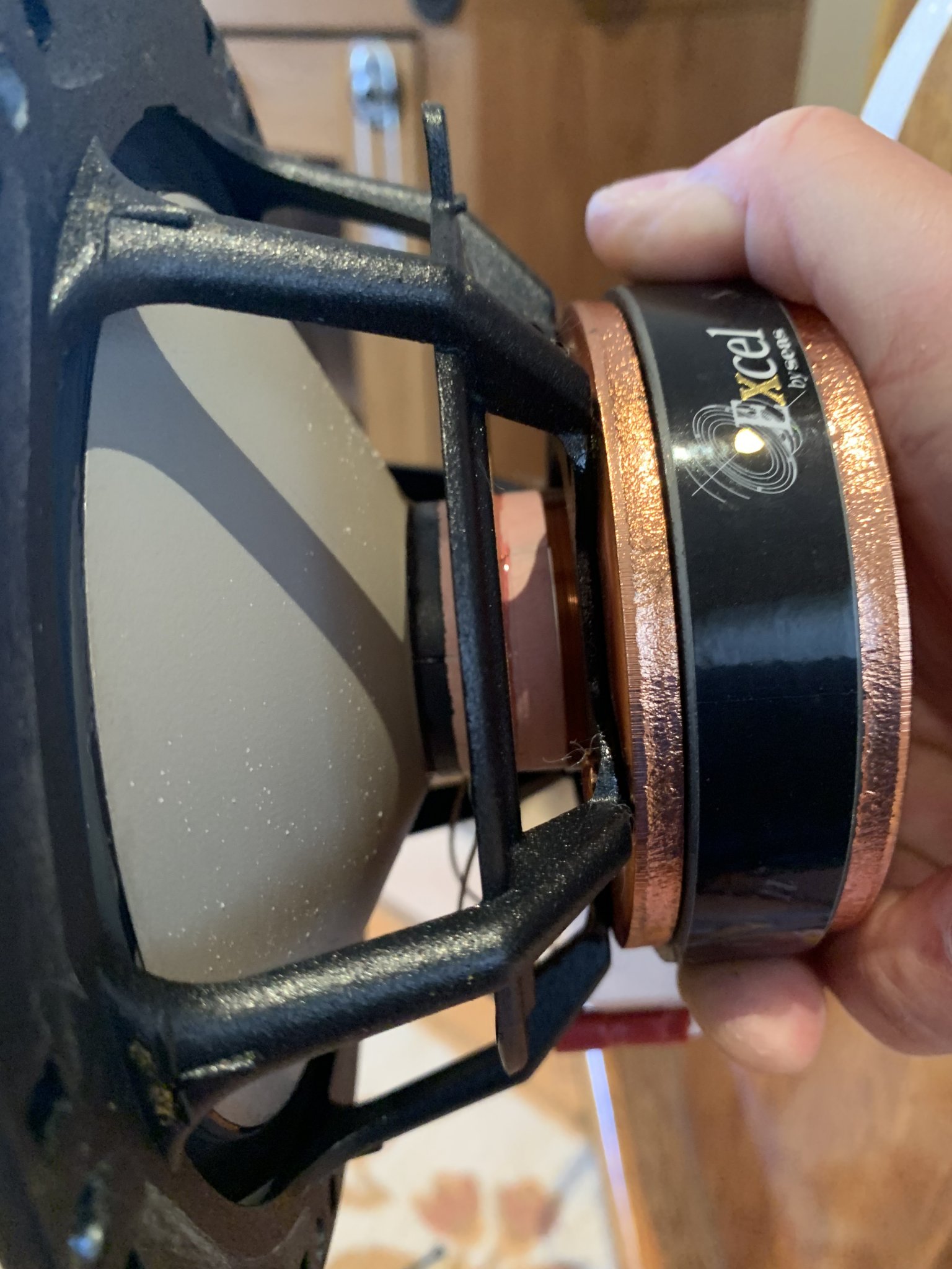

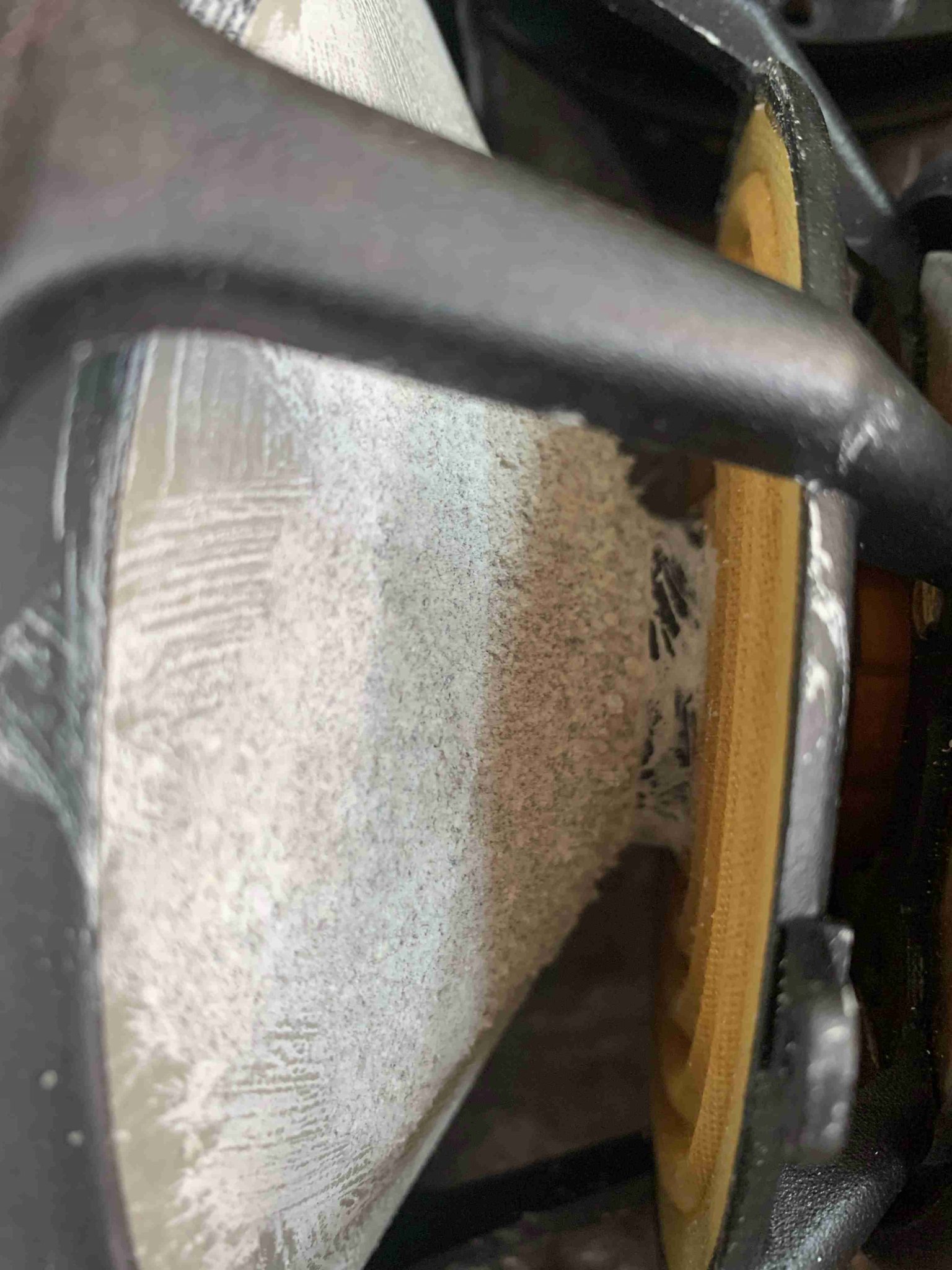

And now the rear of the cone looks like this:
Taking apart these things, handling them, from the solid copper phase plug to copper plated motor, they are the most gorgeous “high end” drivers I have had, bar none.
They probably have another 10 years of life left. Substitution cost for (more corrosion resistant) W18EX003 is higher, topping out at is €350 for the W19NX001

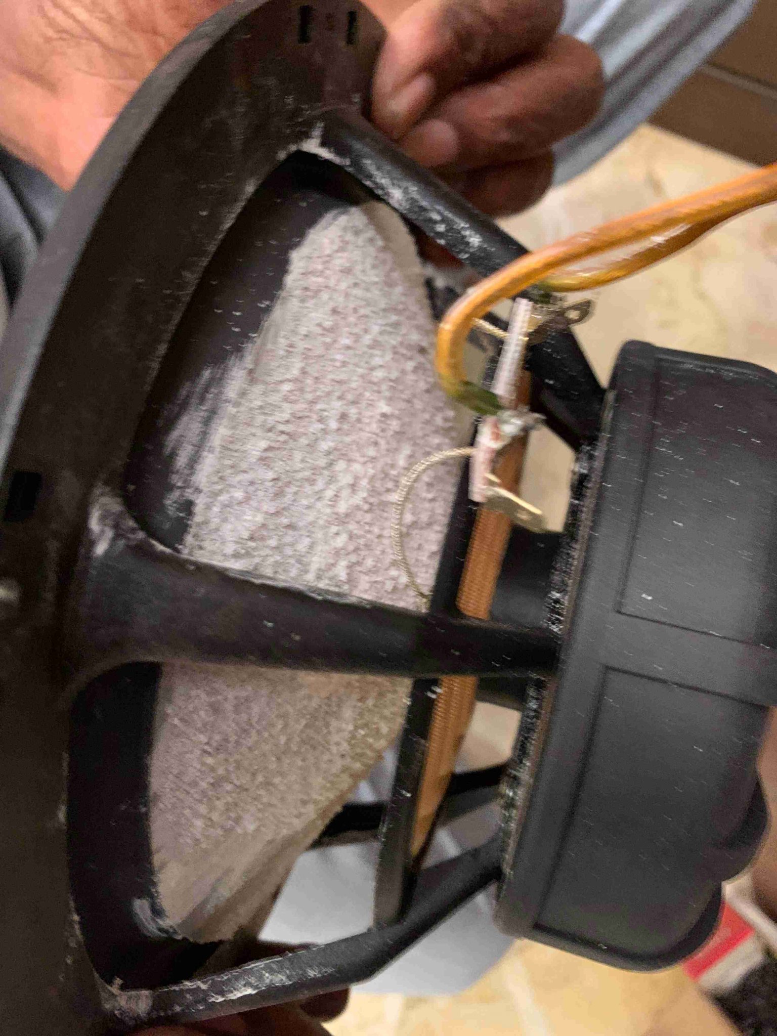

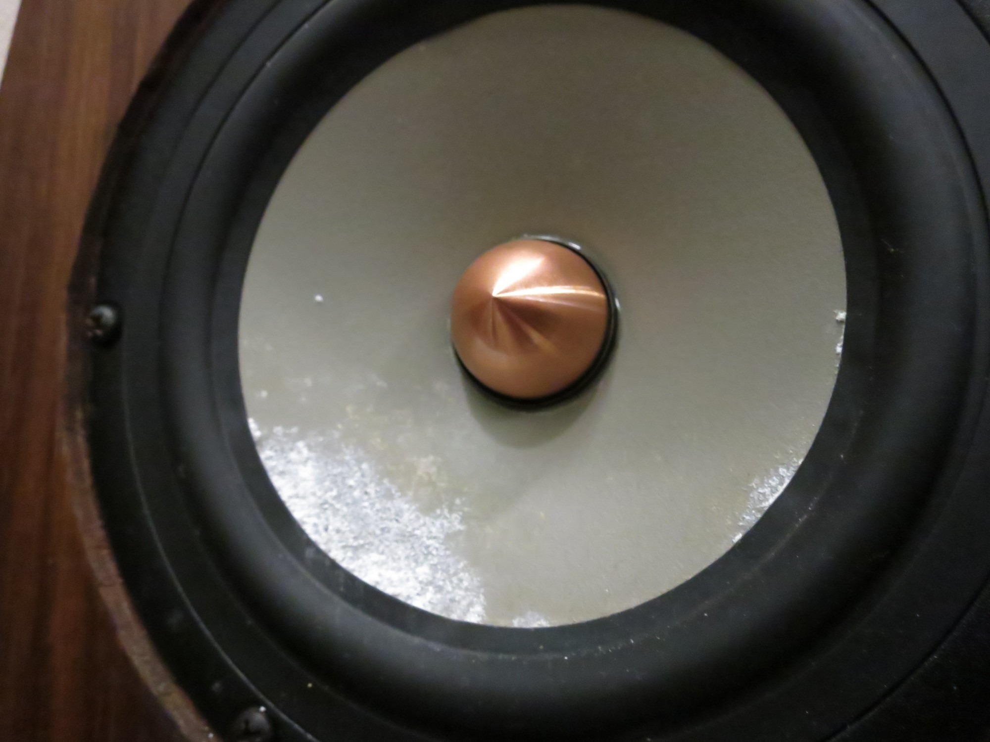

I live in Mumbai, India and my Excel cones (circa 2012) are much worse. I am importing a new set from Madisound to replace these drivers. SEAS claims that the new coating (post-2019) is better. Please pray.Visiting my parents during vacation and listening to some music on their speakers.

That's what SEAS told me too. Let's hope they are right. I live in a tropical country about 500m (1500 ft) from the Arabian sea.Yes, the surface treatment components mix are changed since then, you should have no worries buying Seas.
Its a worth tradeoff for exchanging dive units every few years 🙂about 500m (1500 ft) from the Arabian sea.

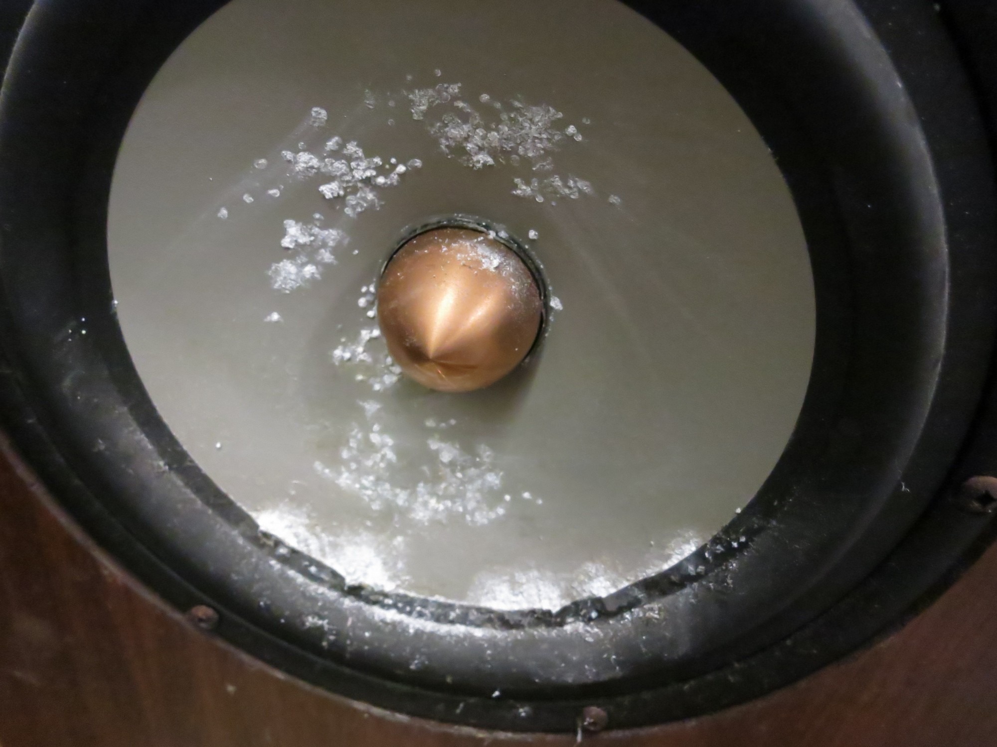

I, too, wonder why the rear of the cone is worse. I noticed initial degradation about four years ago (2017-18). I carefully brushed it off and lightly applied automotive protection costing on the front and rear of the cones.Ouch, I still have a pair of pre-2019 W22EX001 sitting around in box.
@navin, how many years did it take to begin showing visible corrosion?
Seems always worse at the back of cone. I wonder if sealed/passive radiator speaker(with some silica bags inside) will be better.

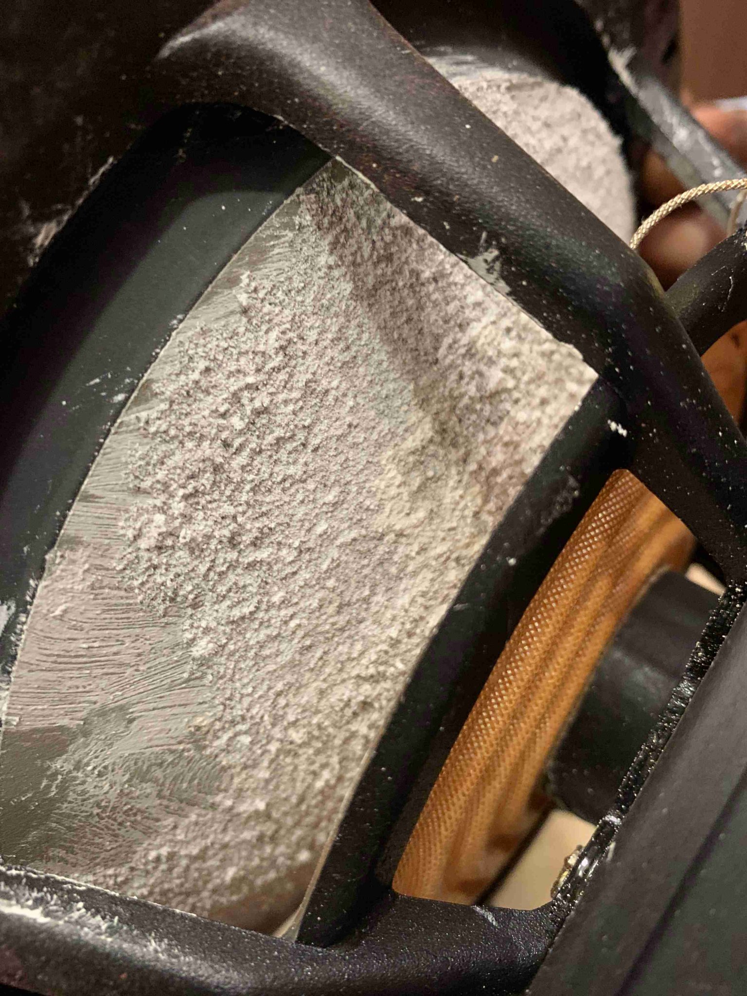

Goodness I’ve never seen it that bad.
The corrosion has totally destroyed the cone!
I currently live in a tropical city- the minimum temperature being 19 degrees C during the dry "winter" months, the maximum is 31.5 to 33.5 on any given day, and the humidity reaches 60-80% during the humid "buildup" and "wet monsoonal" , which is ~6-9 months of the year. In short, it's HOT and HUMID.
Storms, lightning and thunder are all spectacular, but interruption in electricity supply, risk of tropical cyclones, not so much 🤣
I left those speakers at my parents house, which is drier in humidity, cooler in climate and much less prone to rainfall. And that's made all the difference. That was the early 2000s.
I guess I should count my lucky stars that my drivers have lasted 20 years.

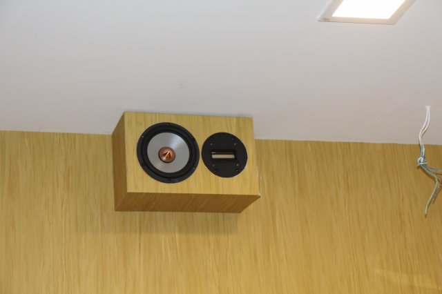

Weirdly the rear speakers that use the W16NX (surface-treated magnesium cone) aren't affected at all.Goodness I’ve never seen it that bad.

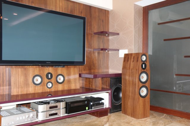

This was my front system in 2012. Every component in that system has since changed (TV, AVR, Front channel amplifier, etc...).
Changed due to the corrosion issue?
Have you checked KLANG+TON 4/2020?Perhaps its time to order the W19NX001 and take some measurements for the benefit of the DIY community- has anyone seen independent measurements?
1. The HDMI chip in the AVR failedChanged due to the corrosion issue?
2. The CD player drive died due to age
3. No one uses a Blu Ray Player anymore, so that was removed too
