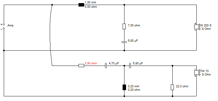

I am using the filter suggestion from Solen for the top end. The bottom is simply 1mh 15uf plus the series filter .33mh 8.2 ohms 22mf.

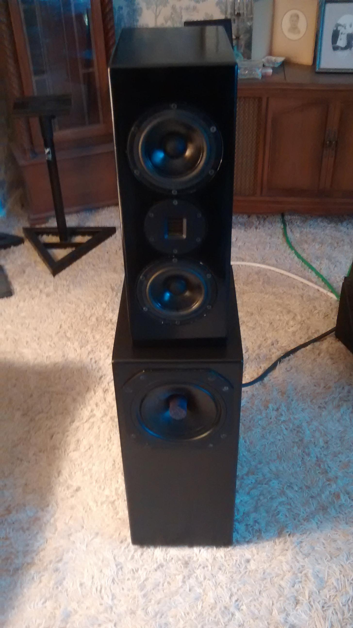

As they're burning in, the drums are really alive! It cost me a thousand bucks to hear a snare drum and ride cymbal 😀

It has improved the midrange a bit. TBH, not much of a difference. I am going to make a small PC board and try the Zoebel Solen suggested too. I can switch them out... see if it makes any likeable difference.
The filter I added is simply sitting on my desktop wired to the binding posts around back of the cabinet.
You're wasting time with this RLC and it's doing nothing
to the midrange SPL while it's drawing current for nothing.
Don't take my word for it. Ask any expert speaker designer.
Those kind of filters minimize SPL fluctuations when you use
aplifiers with high output impedance, like tube amps.

Yes, it does that with tube amps, that is not disputed. It works exactly as you say. But there are a number of 'expert speaker designers' that still use RLC and for reasons that is not about the amplifier Z modulating the FR.
I even use RLC on the bass. In a reflex EQ the upper peak, above the saddle (some of the lower peak will be lowered too, but not flat) and in a sealed box, it is often possible to make it entirely flat, like this 2-way design I did about six years ago:
Note what happens to both impedance and electrical phase. The above is an actual measurement, not modeling.
And you are right, it makes the speaker very immune to FR fluctuations - but a lot work for just that?

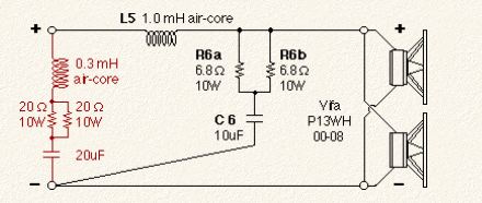

Even though the Vifa midbass units measured beautifully flat with a textbook 2nd-order Bessel rolloff, something wasn't quite right. The mids were too aggressive, smooth MLSSA curves notwithstanding. When you set down the microphone and actually listened to music and pink-noise, it was quite obvious. So I took the path of least resistance, thought a little while, and picked a multi-tapped inductor (L5) from North Creek Music Systems so I could play around with the woofer rolloff.
I shut off the tweeters and just listened to the midbass units, adjusting the tapped inductor as I walked around the room. Much better, but not home free yet. I picked out several different capacitors and increased the rate to 2nd-order, starting with a low-Q Bessel slope. The original midrange coloration disappeared, replaced by a new one about an octave or two higher, near the corner of the crossover slope. Hmm, what's going on here? Adjusting the filter Q by changing the C/L ratio didn't fix the problem, so I took the direct approach and added an R in series with the C6 capacitor. Ah. That sounded good. The MTM coloration was gone for the first time. How interesting.
Now it was time to have a little fun. I wired a L-pad to 15 feet of cable, connected it in series with the C, and walked around the room while I turned the pot. There was a critical value at about 1/3 of the rotation; below that, MTM coloration, above that, all gone. Turn the pot all the way up, and the mids reverted to the L-only sound. I repeated this several times, marked the value on the pot, and measured the resistance. It turned out that 3 ohms was the critical threshold, so I wired two 6.8 ohm resistors in parallel and left it at that.

I think Lynn's bass filter is worth a go. I really don't know why it might work better with valves than solid-state, but I find these near Zobel bass shunts sound very musical. It may be that a 6 or 7.5R bass shunt on a 8 ohm driver is some sort of optimal voice-coil damping.

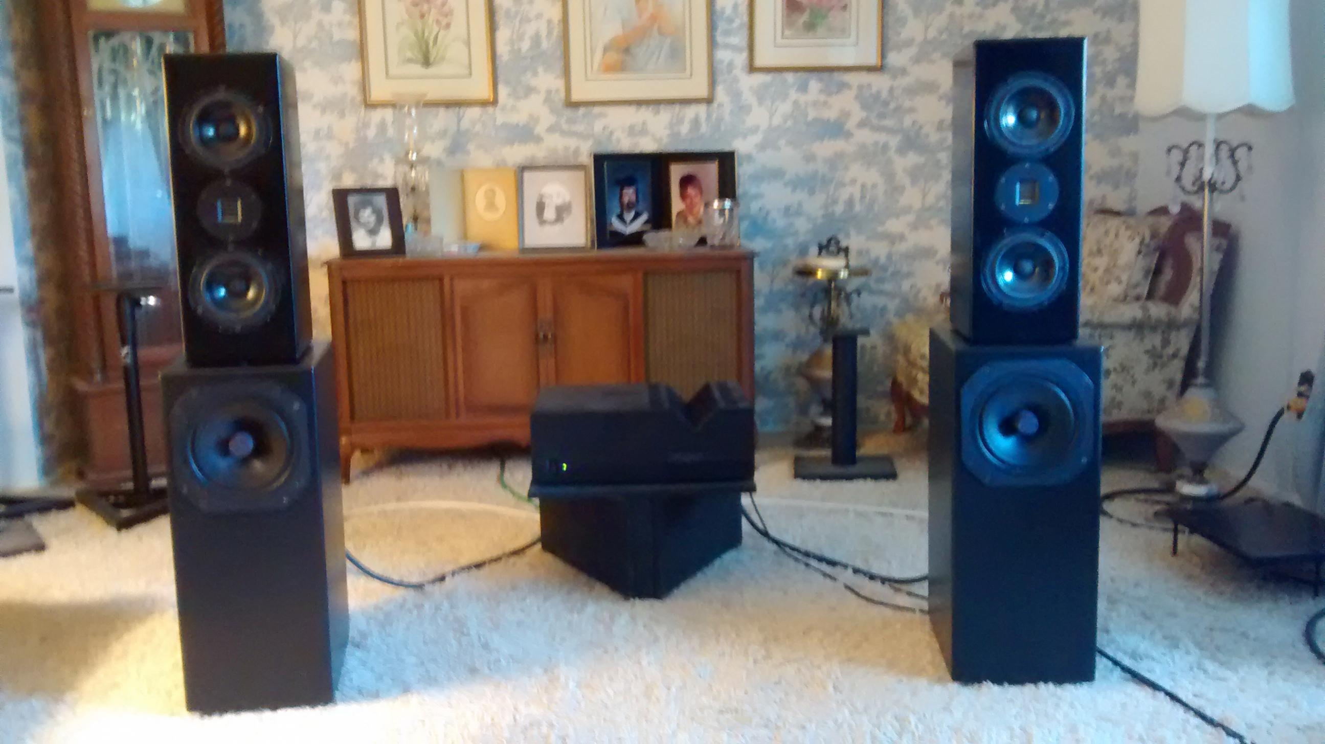

I have now added a low frequency cabinet below. I wouldn't call this a "sub". It's simply crossed-over where the 5 inch Seas rolls off. It might overlap "slightly" but I will know more as they burn in, and make adjustments. I've built a basic BW 3 @125hz
8mh, 411mfd, 2.5mh were the parts I had in stock. I built these for 50 bucks so I am not complaining.
