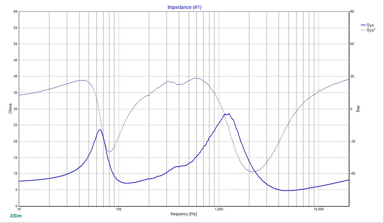

I started playing a bit with XSim, using datas for my speakers to see how they compare with the stock A26 kit.
I found out that one can achieve a very close match, side apart from the impedance (which stays anyway above 6 Ohms):
In light blue, the commercial kit with T35, in dark blue with the 27TBFC/G:
But actually in my original design I used a 4.7uF Mundorf Supreme Cap in series with a 9.5 Ohms resistor on the tweeter (still no filtering on the A26RE4).
What is strange is that the frequency response is very far away from linear :
Though to my ears it is very well balanced.

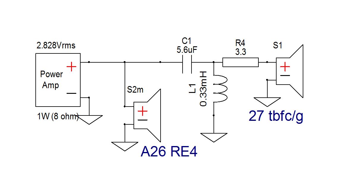

Phase correction!
Ok so I meanwhile understood the point of phase shifting.
Just modified the filter taking into account this aspect.
It now presents a perfect phase match at 1.8 kHz thanks to the inductor!
The filter now uses a 5.6uF cap, a 2.2 Ohms resistor and a 0.39mH inductor (with 510 mOhms ESR).

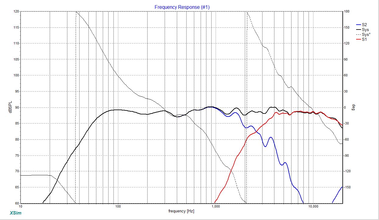

The frequency response is even better than the kit with the T35 (below in light gray in comparaison with the build with 27TBFCG in black): more mid ranges, between 400 Hz and 1300 Hz - though high frequencies above 18 000 Hz are reduced.
Impedance is reduced but still above 4 Ohms:
I am about to order new components ;-)
