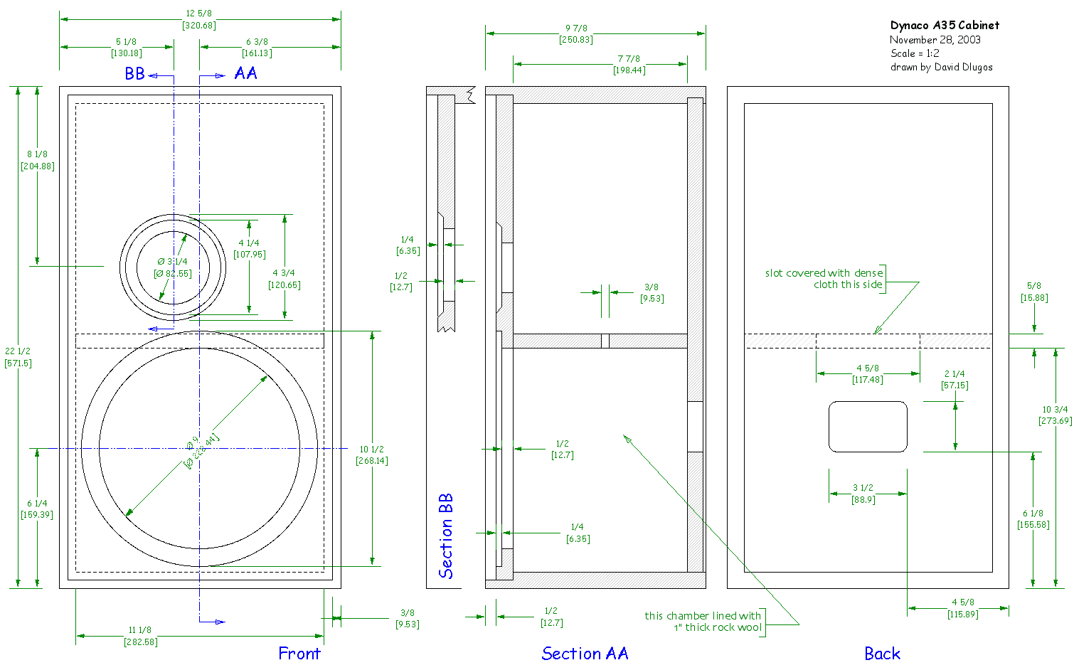

I'm really interested in building a clone or at least a speaker inspired by the Devore Fidelity Orangutan o/93. Has anyone tried this before? I'd be using the Seas A26 kit from madisound presumably, though I'm open to buying each part separately. I've never built a non-kit speaker so I'm a bit over my head but have the woodworking and electronics skills just not the speaker design skills. Any recommendations on how to approach this? I see that several others here have tried something similar so hoping to hear some expertise or experience. Specifically I'm also interested in how to adapt the kit I referenced into a larger cabinet. Can that be accomplished with changing the crossover? Does it stay the same? Any advice is greatly appreciated.
The Dynaco A35 had a larger cabinet than the A25, with the resistive vent on a baffle inside.
The Dynaco A50 had an even larger cabinet with an internal vent, and used two woofers.

This is not what you're asking, but I've been eyeing the SEAS A26 on it's own for quite a while now. Wish I could hear some in person first.
I am currently working on a re-envison of the A26 enclosure.
If you do not have the volume constraints, moving from the 35 litres in the A26 to something as large as 70 litres.
The deVore is pretty close to a golden ratio. Plus adequate bracing.

Will it still be aperiodic with an internal vent?
Not in the same sense.

Redesign
I have been looking at this woofer for quite some time to use in an active system (First Watt B4 X-over) bass enclosure underneath a variety of tweeters (compression drivers, Heils, Raal etc.) and would be very interested to see your box design.
I am currently workin gon a re-envison of the A26 enclosure.

The planset is coming. I have 2 more cut plans to do, finish the what’s this box section with brief history and discussion of the box and why you would want to use the ”optional” aperiodic vent. And then a section on the actual damping, and visualizations.
I also say that i have been planning on taking the A26 a step further, but it was deep in the queu and you have a fellow member for pushing it to the top :^) So he will deserve a thank you.

75ltr with a 2" diameter x 5" to 7" long port will give you more bass, and with such a low tuning frequency it shouldn't sound like a ported speaker can.
