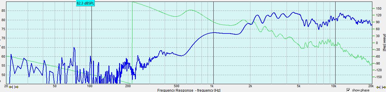

Okay, I don't have the data-sheet from Seas, so there must not have been one in the buyout process.

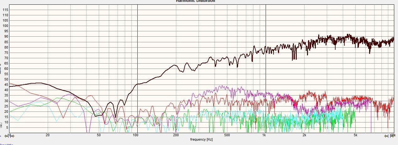

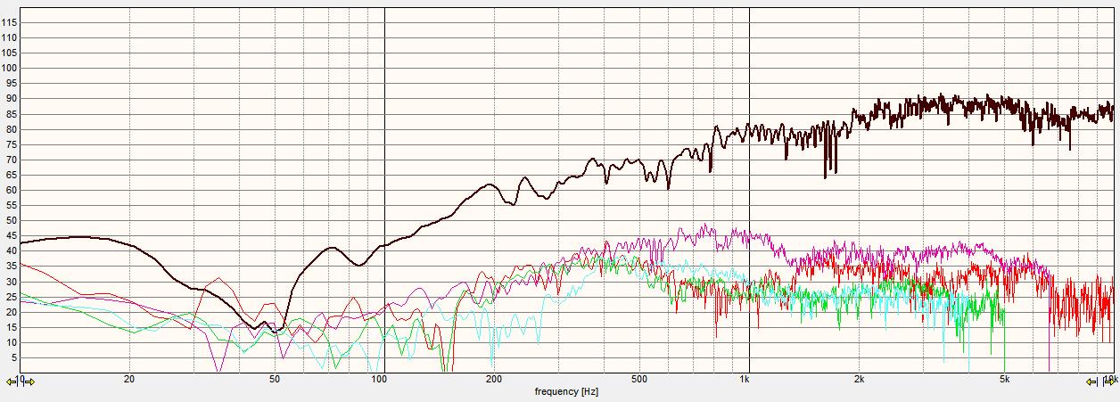

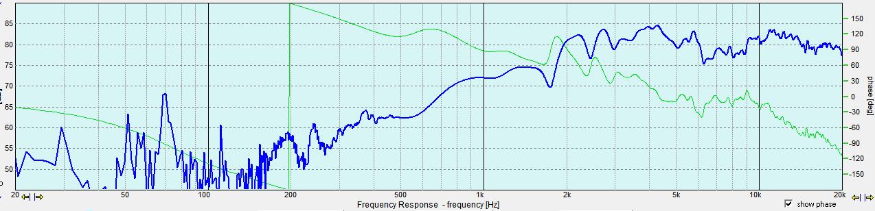

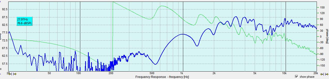

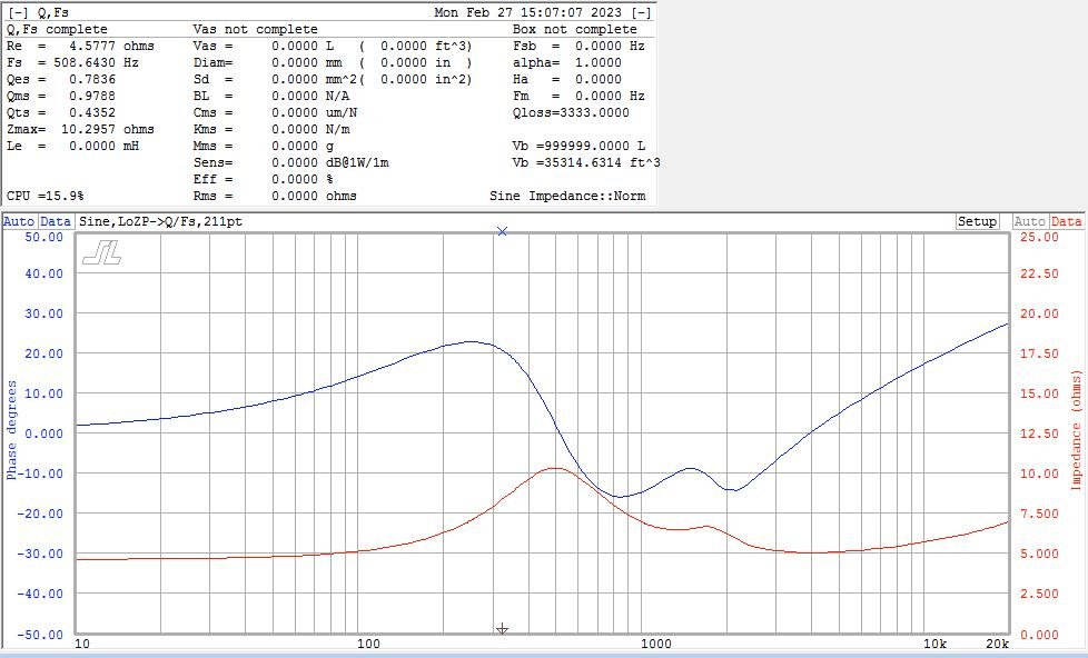

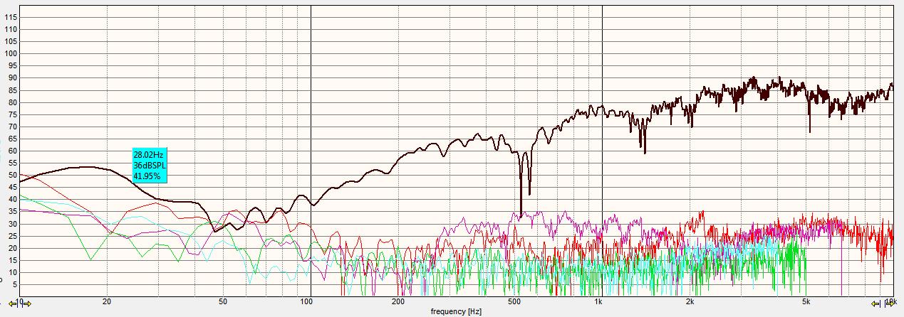

For those who bought them and want to know information, here is what I have attached. I ended up with 3 units, PE replaced one, as one had a rub in the voice coil upon arrival. Aside from that, it looked very similar to that of Sample 1. I have not yet taken an impedance of Sample 3. I would say that 1.8kHz is not out of the question, however, the frequency response I measured for these in this session is not the flattest, and they roll off pretty quickly. Since these were measured on the floor quasi-IB facing up with dense felt obscuring the transition from faceplate to floor, the FR will change a bit in a baffle, but it should not be drastically different.
The HD sweep is still valid relative to the fundamental as measured, but I would not compare them to other sweeps in different situations.
I hope it is useful for you.
Note- Sample 2 had the rub, but otherwise looked very similar. The measured HD is obviously much worse on that unit.

So, I've ran the pair I have through DATS v3 and they show the following parameters
R(e) 4.404 and 4.563
Fs 484.5 and 480
Qts 0.407 and 0.3896
Qes 0.7671 and 0.7107
Qms 0.8672 and 0.8623
Now to find a design where someone have used these in a two way, I have Peerless HDS 830883 that I am considering using. Found a design with that HDS woofer that someone used with the older no longer available Dayton RS28A.
Need to find the RS28A spec sheet and see if the two tweeters are anywhere close...
