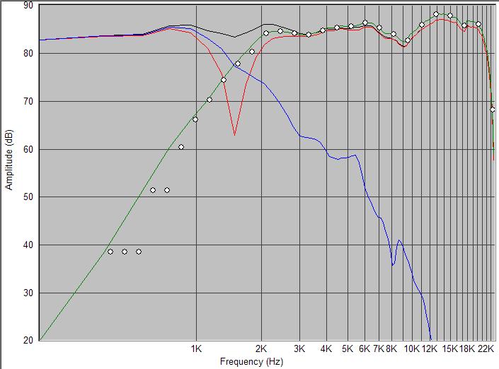

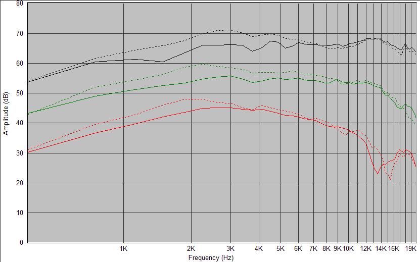

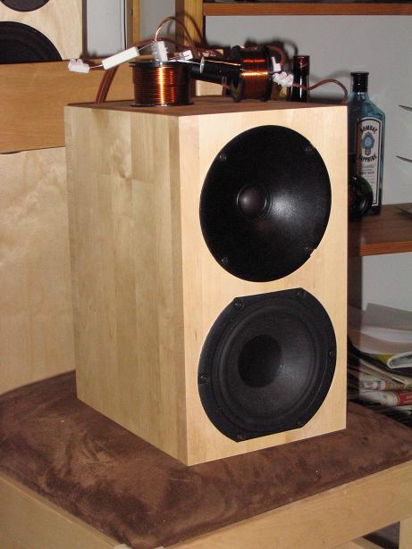

This is my first self-designed loudspeaker project. It uses Seas 27tdfc tweeter with a waveguide bought from finnish loudspeaker supplier. Tweeter's fr with and without waveguide on axis, 30 and 60 degrees off axis is attached as an image.
The woofer is the successor of the well known 850488, 830870.
The enclosure is 7,7 l ported made of 18mm birch board. The external dimensions are 31*23,6*17,6 cm. The port is 50x150 mm and fb is somewhere near 60 hz.
I am very pleased with the results, the sound is balanced and neutral.

Looks as lovely as the city in which it was made...😉

The waveguide is from hifitalo (www.hifitalo.fi). They use it in their kit aw-10hqi with an aluminum tweeter. It is made of plastic and it's about 22mm deep. The throat opening fits the 27tdfc perfectly.
John Krutke has also made some measurements with the same tweeter but a different waveguide.

1) Great looking speaker, great choice of drivers, with resultant great sound I'm sure.
2) How did you finish the cabinets pajazo? Very nice woodwork!
