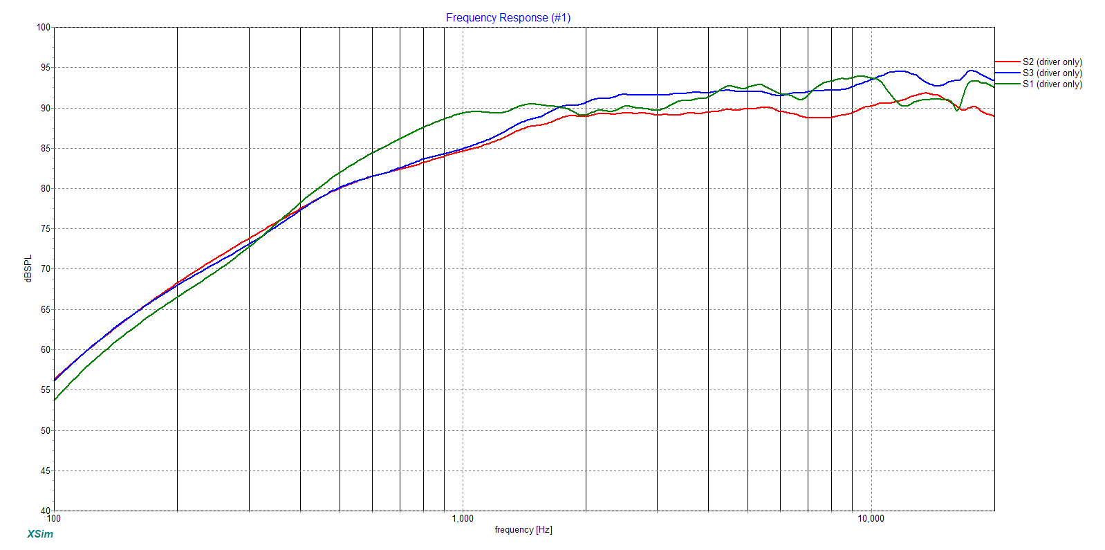

The DT-254 measurements have 1 off-axis response only instead of 2 like with the Seas units. Yes the Monacor dispersion at the top end seems wider but that doesn't mean it's better. Same dome size and almost same faceplate but wider top octave dispersion usually means that the dome are less likely pistonic which means it's working more in break-up mode.
The waterfall is clearly worse than all the three mentioned Seas unit. I bet the spectrogram would be even more revealing but that's missing with the Monacor unit.
I went to this page, downloaded the FRD and ZMA. Loaded to Xsim.
- Green Monacor DT-254
- Blue, Seas 27TFFC
- Red, Seas 27TDFC
The Monacor is very strong, even at 1Khz almost 90db!
Question is who measured, how and when?
But of course the 6 Ohm impedance can be lifted to 8 Ohm with a series resistor after the L-pad. This way the 27TFFC's higher sensitivity can be an advantage and privides more flexibility.

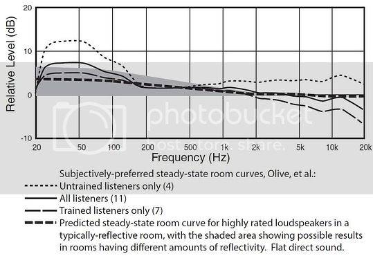

Why? For me the rising top-end response is not natural, too much. At strong transient female voices it is like screaming/shouting at the upper tones and hurt the ears. I also tried the 27tdfc and here slightly missing the "airy" feeling that the 27tffc has. None of them is perfect for my ears.

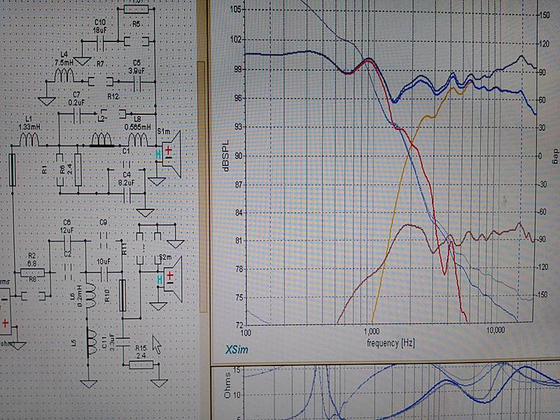

I played with 27TDFC a little this week - clean but bright, comparing at least to 'my pair' of SB29RDNC. I put Zobel parallel with the tweeter, 3.0-3.3 uF and 2.4-3.0 ohm, the lower resistor value attenuates very top more. Zaph, J. Krutke used similar trick in his SR-71 Seas based kit.

Ignore the peak-dip around 800 - 1.5kHz which is a surround/cone resonance, and MLS artifact.

Yes, I also tried it with a 4.7ohm+2uF but the edgy spectrum is always there only dampened.

Yeah it's even more with 2uF, actually 2uF with 4.7ohm did nothing to my ears, had to go more radical with 3.3uF-2.4ohm to cut the 'zing' - I get it why my friend complained, that 27TDFC is a horrible tweeter.
