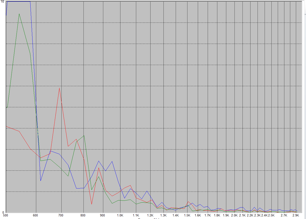

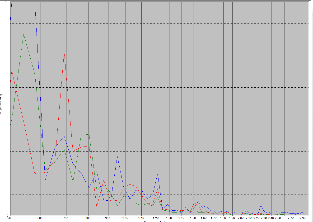

Harmonic distortion measurements. I'm not confident in these. I was more interested in the relative differences. but I don't trust I have the levels / setup right at all.
First up is the B tweeter (with a 0.7v sine wave output). I couldn't go higher or was clipping on the soundcard input/output reference loop. Will investigate.
I forgot to mention. Blue line = 2nd order, Red = 3rd order and green = 4th order HD.
If 3rd order is the most relevant for nastiness, then the B has a noticeable spike around 1200Hz. That was the only consistent one over 3 measurements (anything below about 1Khz was volatile).

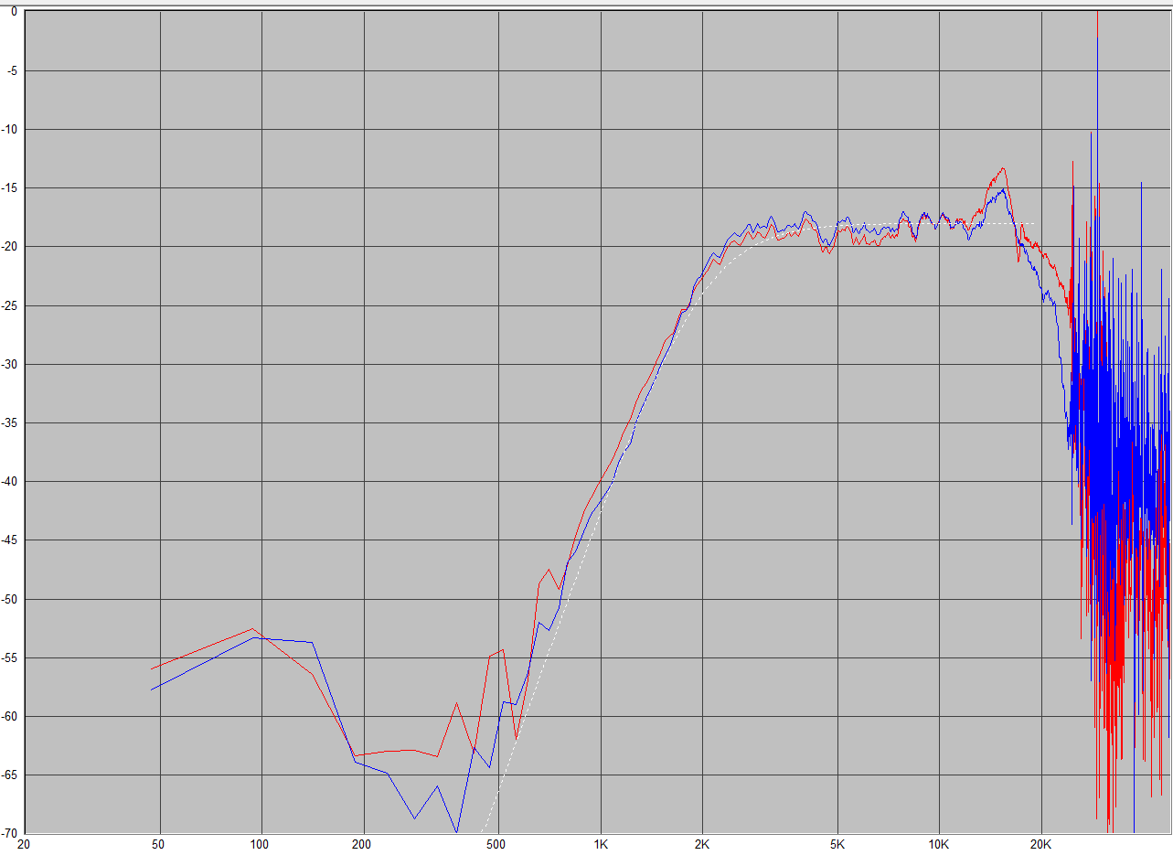

And now for the measurements.... First up - the on-axis response with crossover in place. The blue = 27TBFC/G and red = 27TDFC/G. White was my LR4 target.
Give us 1dB grid, please and spread it 1-20KHz - showing from 20Hz-40KHz just collapses the grid.

I'm not sure what to think of your measurements though as that peak at around 16kHz shouldn't be there.
As to the distortion measurements, the fabric dome has the smoother distortion profile. Where the distortion peaks up for the metal dome though is well below the tweeters passband and where the signal to noise ratio is falling. Given the drive level neither tweeter should be displaying peaks/spikes and these could just be measurement artefacts. Did you repeat the distortion measurements to confirm that the spikes at 1.2kHz were really there?

The 16KHz peak is due to my poor calibration I think. I'd ignore it but I think as the artefact appears on both measurements, it shows consistency and if that was a real peak and manifested itself, my little listening dislike would appear with both drivers.
The harmonic distortion measurements are not consistent with the 3 indoor runs I've done (again gated). I really don't know what I am doing in the non-linear measurement department. So I fully expect my measurements could be crap allowing no meaningful interpretation. They were taken using speaker workshop using the 1 power vs frequency, with 80 samples between I think 500Hz and 3KHz (as I don't believe my problem is higher in frequency...., and lower in frequency shows distortion I just don't think is there!) meaning suspect measurements.
I can do- but I don't think this will show anything meaningful. Was there a part of the spectrum your wanted to zoom in on?
PS: I posted the full measurement, incase any of the 20KHz+ junk had any bearing. The full measurement so to speak. I realise it could be limitations of my measurement system, but thought it best for others to decide rather than filter out data.
