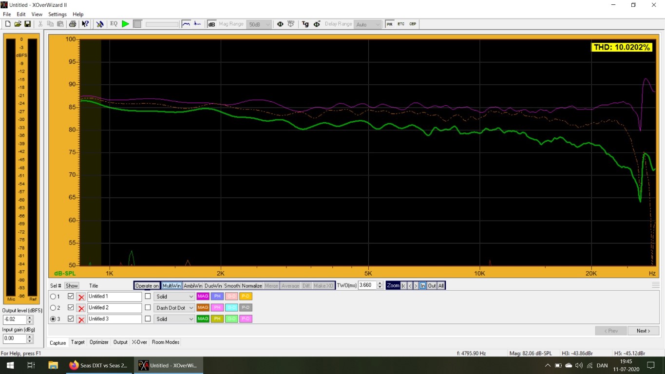

From what I could quickly copy from Heissmann Acoustics, in my test-box. The baffle and the driver, is for sure in a unique unity.
Measurements are done roughly on-axis, 15 and 40 degrees - simply to see if it worked in any way with my choice of filter - LR4 at 2kHz.
It’s not high-dispersion. It only looks that way because of the breakup right past 20 kHz. From about 15-18 kHz (I’m not looking at the graph right now) the off-axis response is trending downward substantially.
You see the same effect on many rigid domes, such as the SB26ADC (though that one isn’t quite apples-to-apples since there’s a phase shield - but augerpro has good measurements of the unit without a shield)
My H1212's do -8dB on 60 degrees (flat baffle 24cm wide) at 10kHz. It's not the breakup actually (27kHz), but the pathway difference that causes cancellation. At 10k wavelength is 3,4cm and half wavelength (i.e. out of phase) 1,7cm. That off axis behavior pretty much has to be expected from any 1" tweeter, even those with a flat dome profile.
