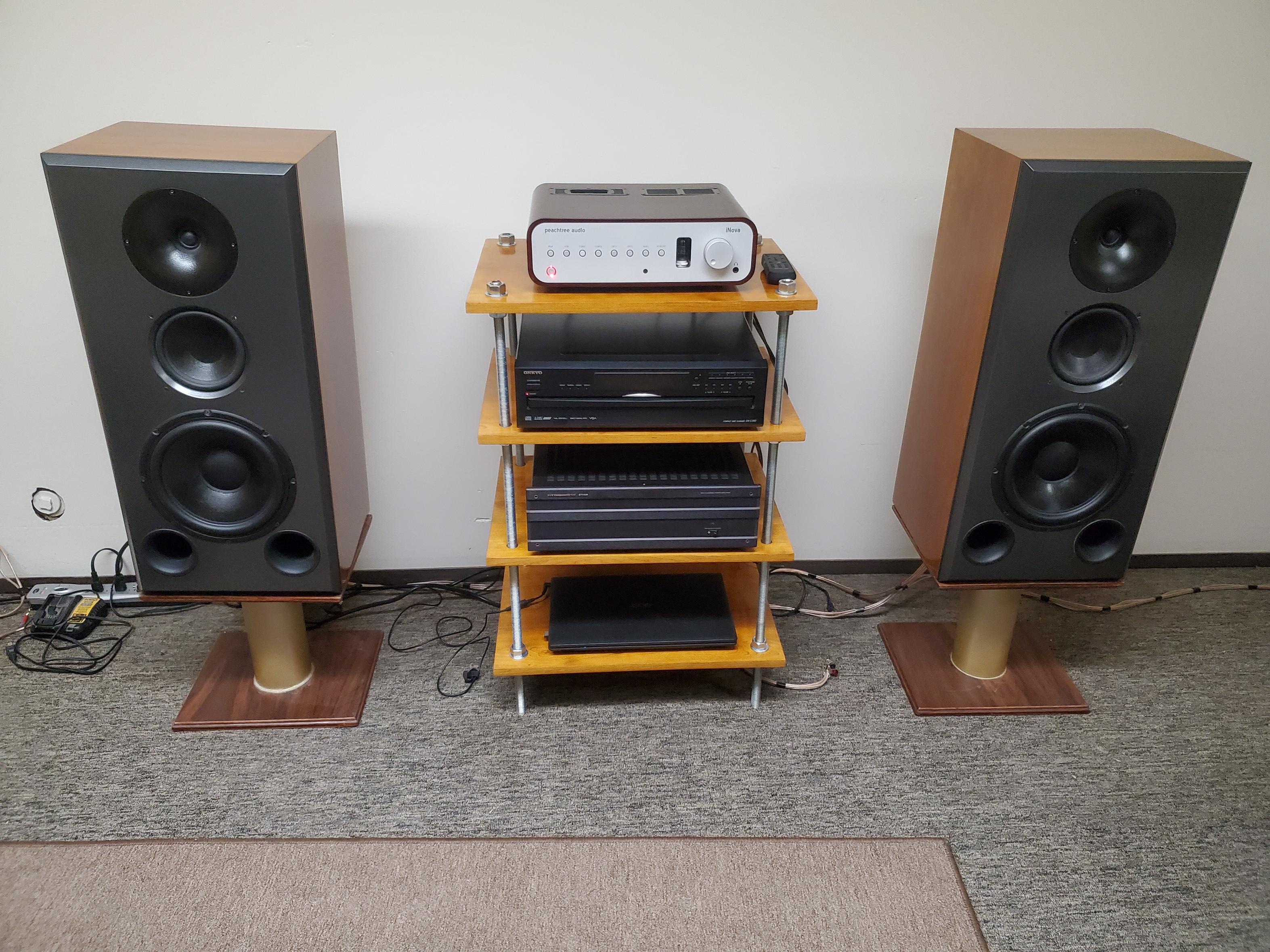

Hi Darakon,
You could roll your own in regards to a small waveguide like tweeter. I recently completed a large standmount that was patterned in the Harbeth/BBC approach. The tweeter I used (although one could do better) is the Scanspeak D2604/ 833000 in a Monacor waveguide that was improved by filling the rear cavity with epoxy.
Best,
Rich

Hello Rich,
wow, great work! How do they sound?
Scan-Speak is a good idea. High quality, fair prices.
I will have a look through the scan speak tweeter range.
