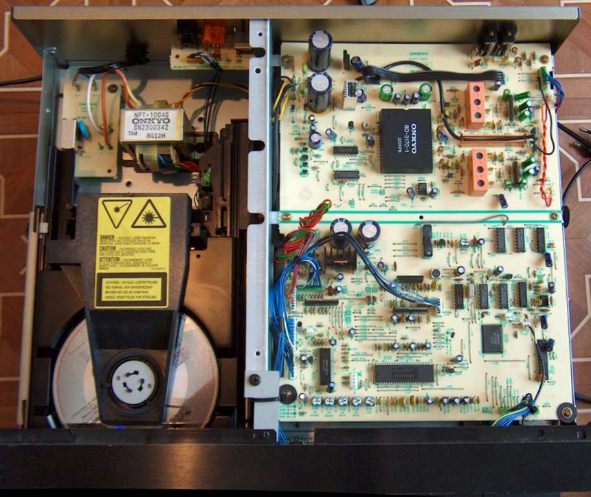

Does anyone has somewhere Onkyo's Integra DX-6550 CD players internal view, especially - i need clear view of the originally regulated laser offset, gain - all the five's settings seen in the picture:
Thank You very much for helping this nice player to become alive again
Model DX-6550 is completely identical with Onkyo C-701XD
Look here and you will find all what you need :
http://kazur-web.hp.infoseek.co.jp/130.source/ONKYO C-701XD.htm
And other variant of adjustment (little different) :
