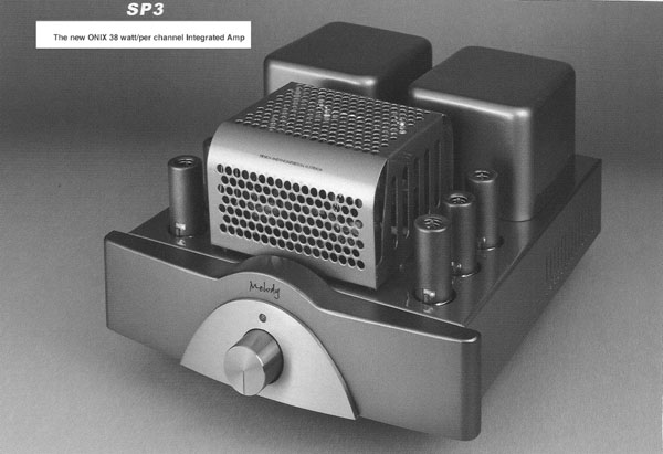

If cosidering going for the non-DIY route...there is an incredible deal going on these days at www.av123.com , it involves an integrated tube amp.
I'm not at all associated with them, but I've bought some speakers and amps in the past from them and the service and quality are excellent :)
All their products are made in China, designed in the USA and sold only direct.
The amp is this one:
I'd like to do some DIY stuff or have the ability to fix simple problems. One of my reasons for the Heathkit is my fathers history with them. He has been an HAM operator since before I was born. He has pictures of me on his lap over 30 years ago talking on his Heathkit radios. I'm sure he'd enjoy helping me fix an old amp up not to mention my kid helping also. I might eventually build one from scratch as there seems to be many simple projects with good results.
Thanks for the link.
