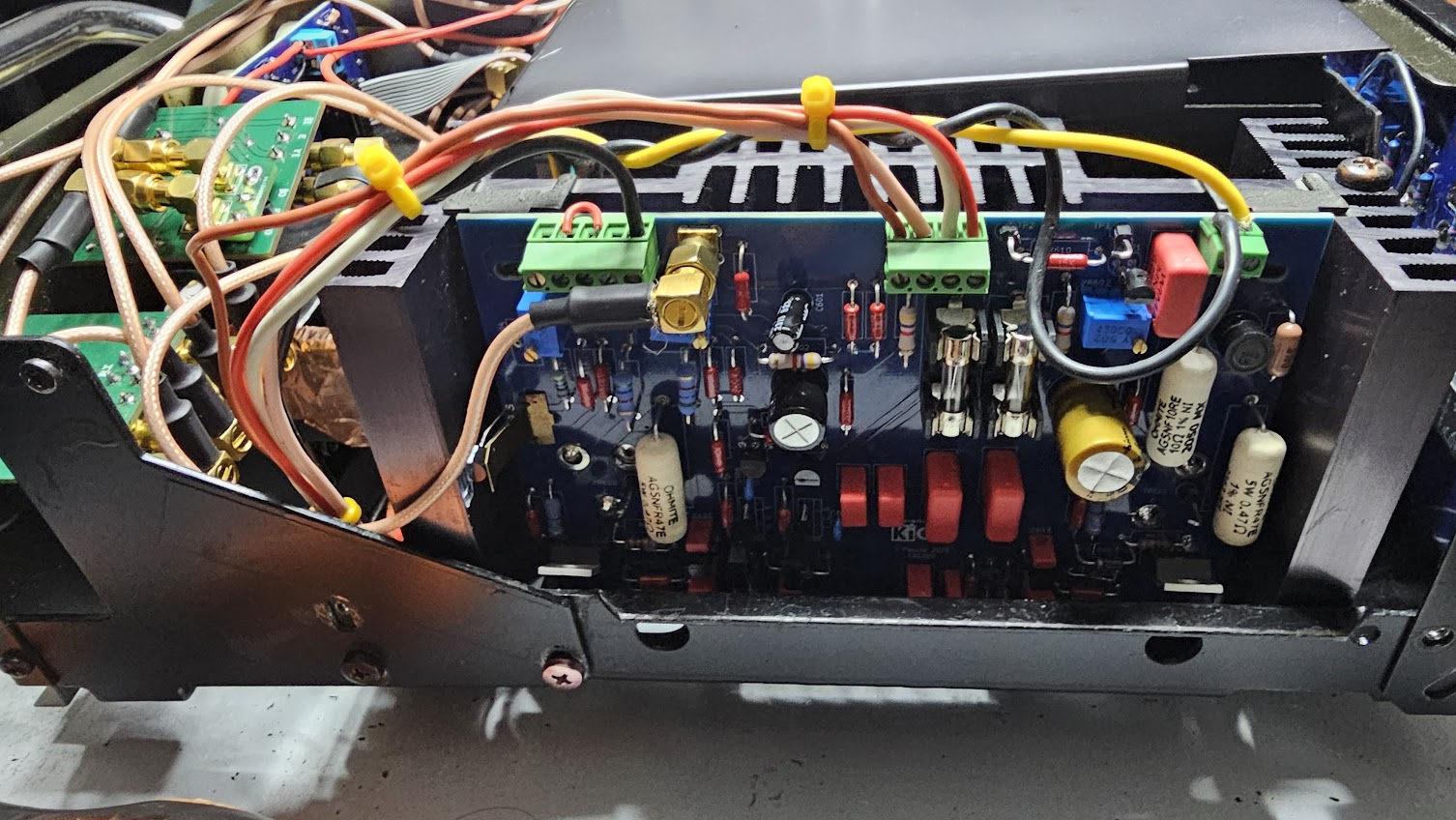

Okay, I serviced these amplifiers and all their products for years. I was authorized warranty for Yamaha among others. Their power supply designs were pretty decent. The biggest problem was heat some times.
So, the first thing you do is vary some parameters in the power supply to observe and measure the effect on output and noise. So noise and ripple levels to see what shows up in the audio output. This determines the level of performance you need. You may find that the original supply design was good enough, or merely needs a bit of a performance boost.
Measure an original unit, then measure your boards and installation in another. Make sure your design is at least as good as the original.
Finally, UL and CSA may dash your excellent design. But don't waste money, time and effort designing a supply so far beyond what you need that it becomes less reliable.

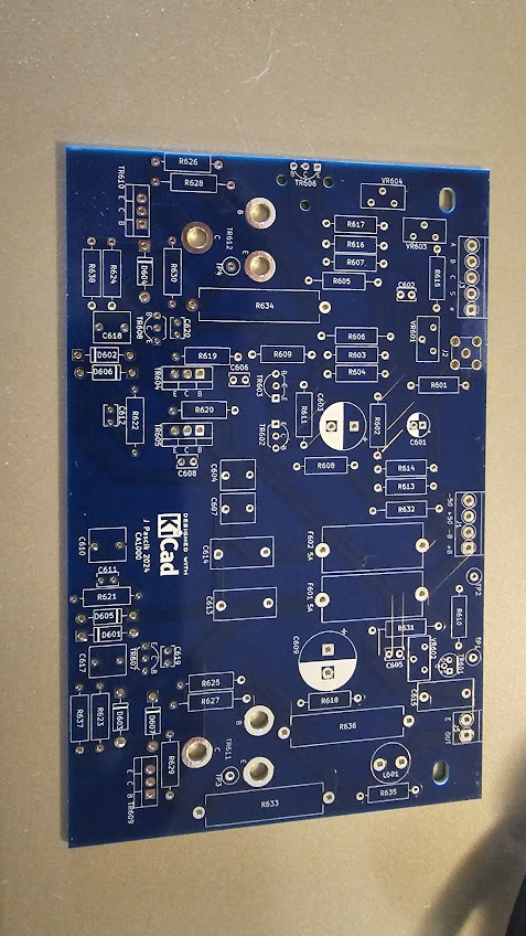

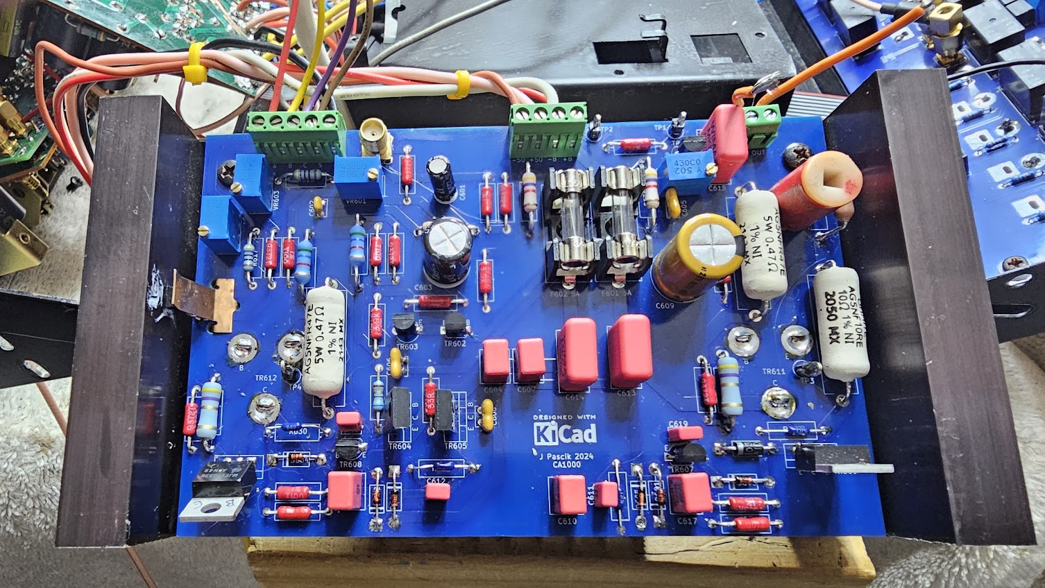

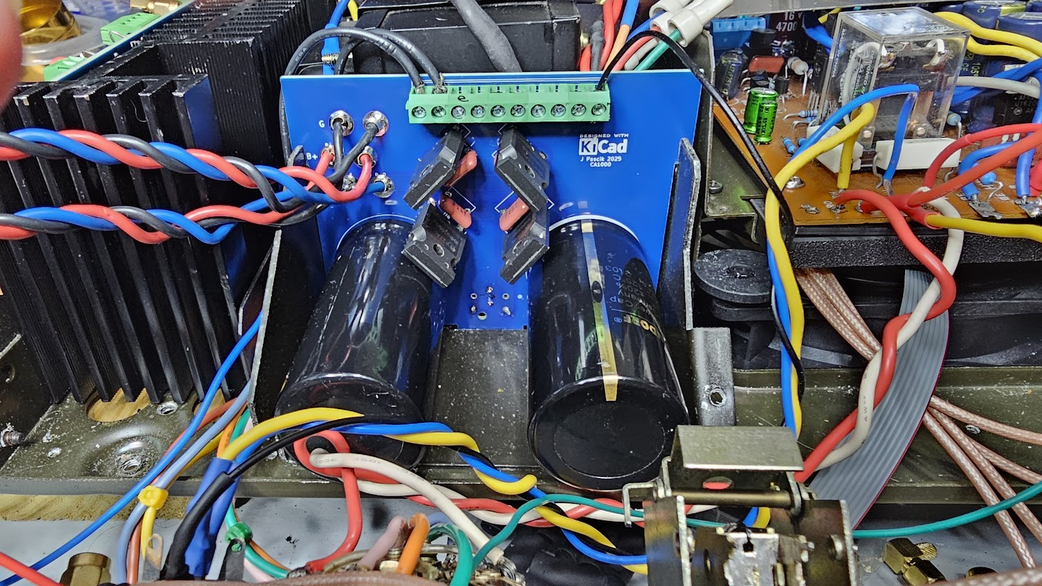

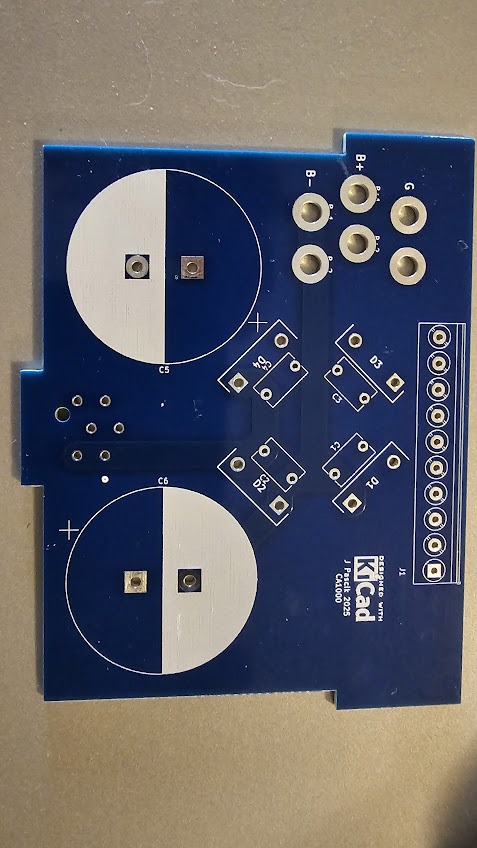

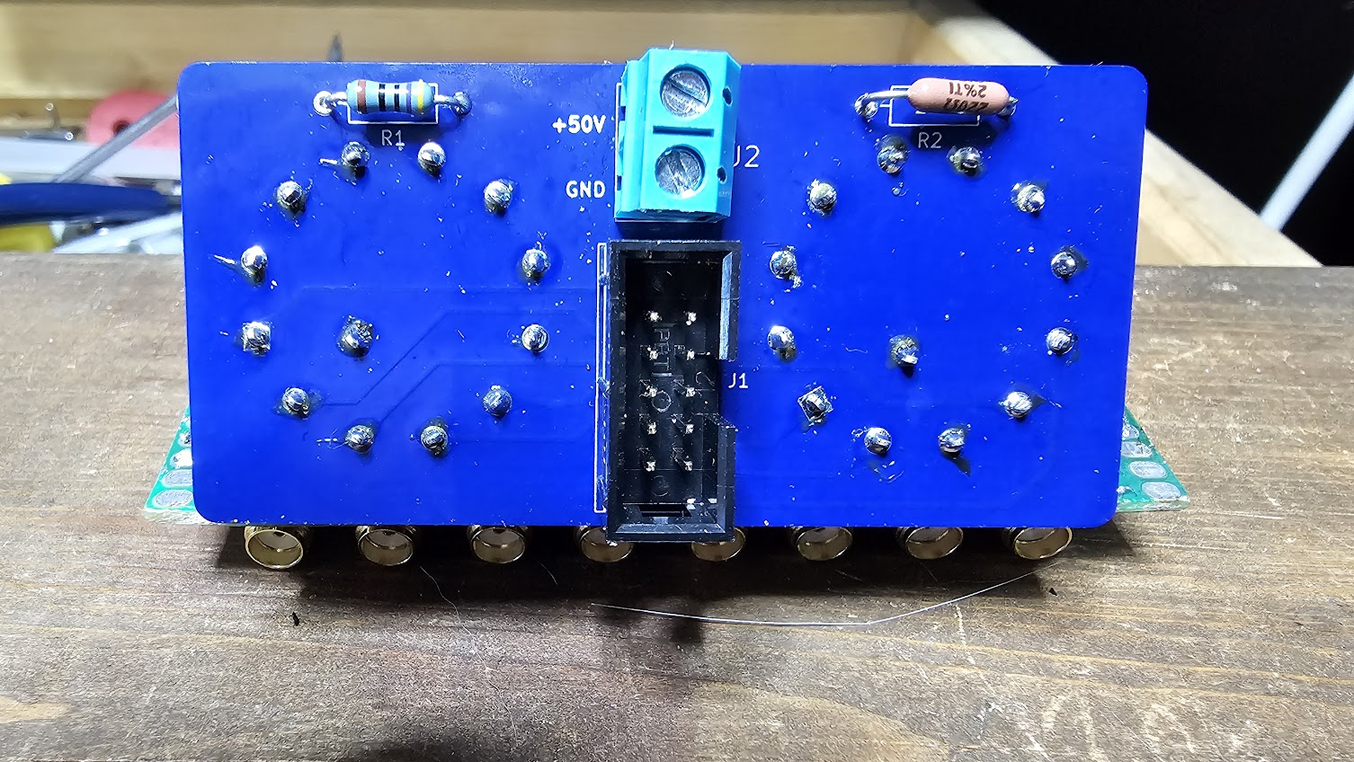

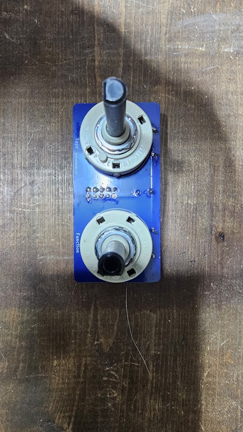

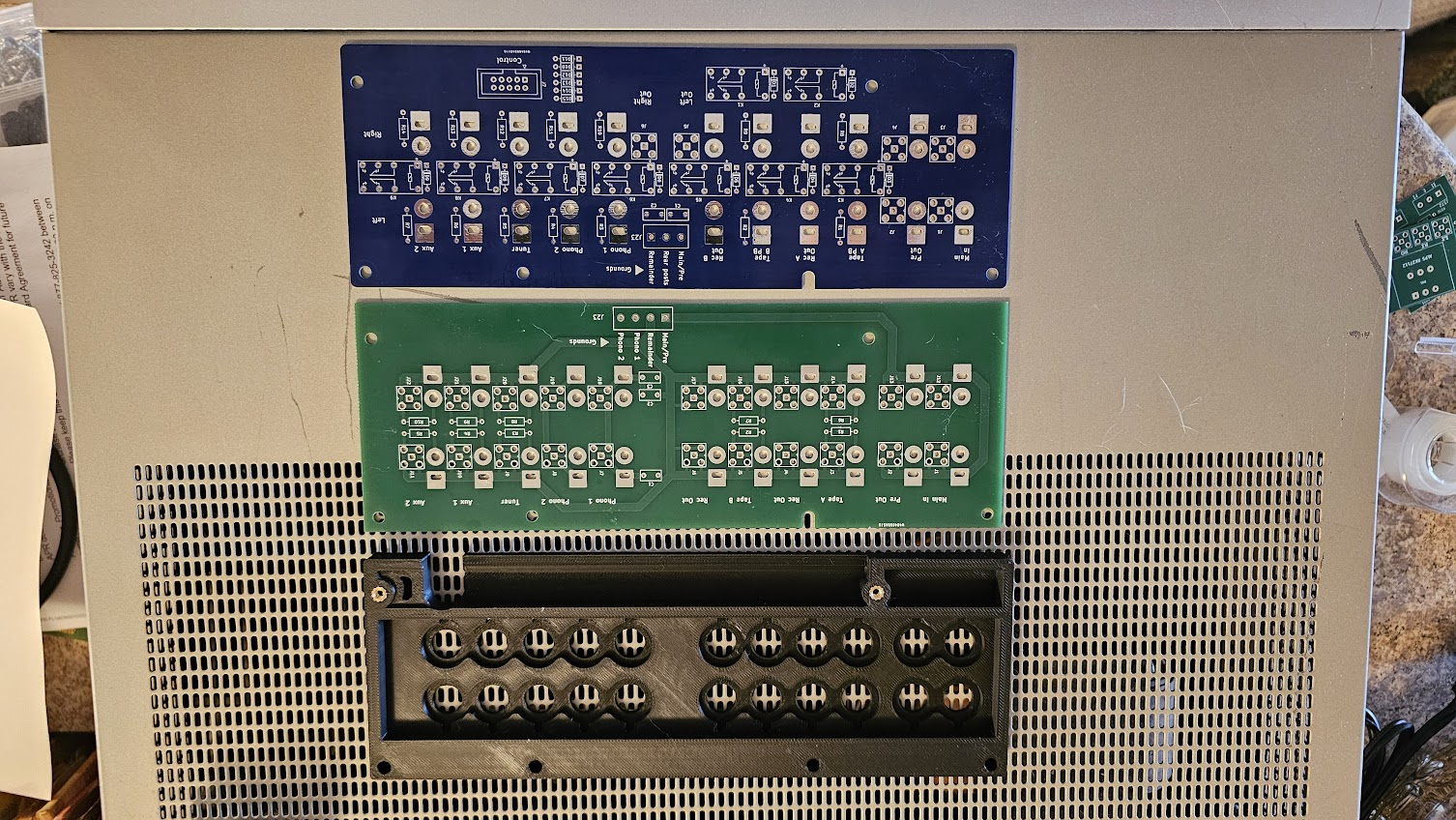

We have created copies of the existing Main Amp and Electrolytic PCB's and have available.
The rear panel interface board is new design and available.
The preamp Tone and Filter is still work in progress.

All original PCB were tested and deeply analysed thus leading to the process currently underway.
At this point in time the new PCB's have been simulated in spice and the performance look very good.
If you have suggestions on these designs, I would like to hear them.
Once you know what you need, you can go a little beyond that (prudent). Each supply will probably have vastly differing noise and ripple requirements. Figure it out.
I am presently maxed out with my knowledge, thus the request for assistance. My prayer is that someone is able to evaluate the posted schematics and determine what is required for excellent performance.
