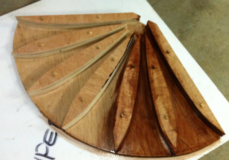

SemperFi,
1) A larger, lower cut-off horn will generally also have pattern control to a lower frequency.
2) Desired pattern would be helpful for suggestions.
3) The "Smith" DSH (Distributed Source Horn) is an easy to build DIY project, and also easy to convert to different horizontal angles and low frequency cut-off. It can be made to any finish you want, using aluminum fins with dark or hardwood or black paint top and bottom can really make a visual statement, or the horn can be hidden behind a grill.
Although some don't care for a diffraction based horn's sonic purity, the DSH does produce good sound, and was very popular in many homes and studio monitors from the 1950s through the 1970s.
It will also will make a JBL 2425 output near flat from cut-off to around 16kHz with little or no EQ required, simplifying crossover design.
Art

The Smith horn sure looks like a fun project. Any known good plans out there?
This one looks pretty close to the original:
Reconstructed Smith Horn Plans
Just don't put the "plug" in, which was just an alignment in the original "Popular Mechanics" DSH plans.
Having used many variations of the Smith and the JBL 2370 and other bi-radials, not sure I'd have a decided preference for either, though building the Smith from wood is a lot (like four times) easier than a bi-radial.
Art
thanks. I will try and build the Smith Horn as the fins are similar to the ribs I used to make when I build model airplanes, way back. Should be easy enough.

The feature of the Smith is the mouth. The fins are found on horns with one fixed dimension and they create a narrow but expanding throat.
What you have there is a small Yuichi. It is a Hyp/Ex horn that has been held at 90 degrees horizontal.
