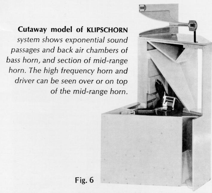

Isn't the KH front folded horn too?
If you have the ability to position in pi/4 (corner) or pi/2 (wall/floor boundary) then do so. It helps quite a lot in the bottom end. My new rig will use a large hypex midbass loaded in quarter space and the LABhorns will be loaded the same way.
I forgot you can't deep link into geocities. Go to http://www.geocities.com/loudspeakerguru/ . It's a drawing in the middle on the right.
Yes the Khorn is a folded front horn. See pic below for a cutaway.
