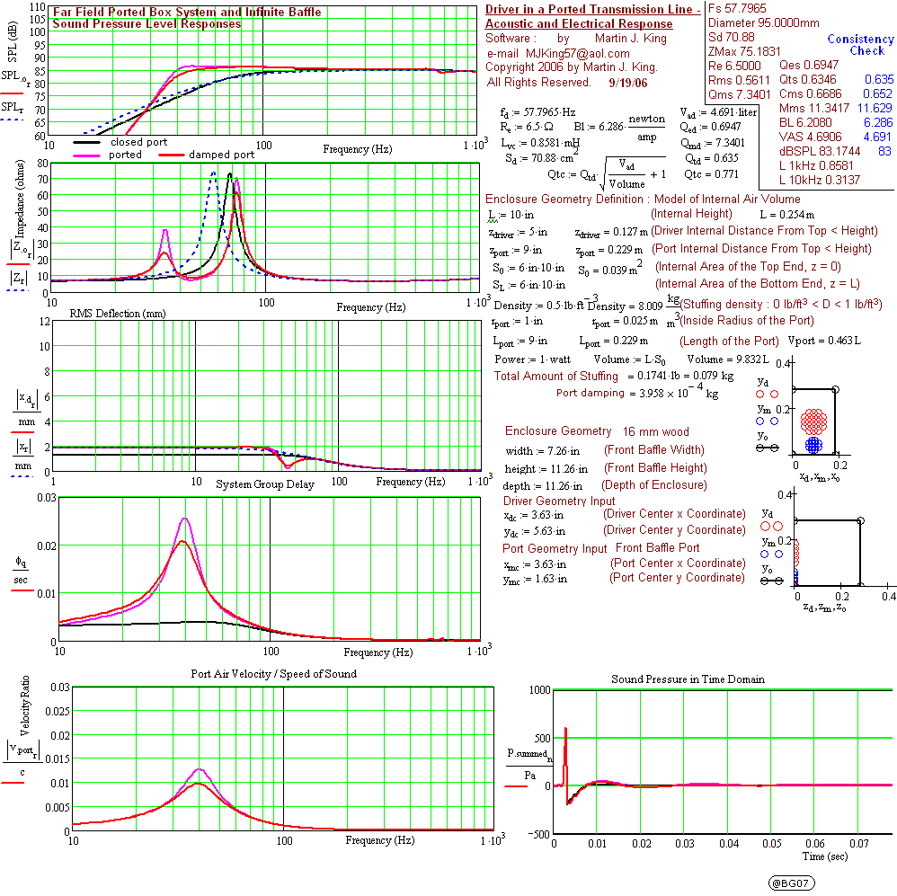

Now coming to my real problem, I want a good driver to use in my tower project which I've been planning for years now but cannot start due various reasons which most of us in india have. my main problem is I cannot spend 8000 Rs on an single 6" driver from seas nor can spend half of it on an dayton.
I've talked to these vifa people but of no use thier pricing is simply impossible and also they only stock some models which again are too damn expensive for me,so whats the alternate ???
I've tried to talk to couple of manufacturer's here in bangalore and two companies had promised me some gud stuff. one of the companies 5.25" drivers parameters are as follows.
Fs 57.7965
Diameter 95.0000mm
ZMax 75.1831
Re 6.5000
Rms 0.5611
Qms 7.3401
Qes 0.6947
Qts 0.6346
Cms 0.6686
Mms 11.3417
BL 6.2080
VAS 4.6906
dBSPL 83.1744
L 1kHz 0.8581
L 10kHz 0.3137
now could please any one tell whats your opinion on the above TSP.
if any one lend me an helping hand it would be really appriciated.
Thanks,

From Qts, b/l & spl,
Qts seems little high,
B/l is ok if linearity is good. U hv to check frequency response curve + impedance curve.
Spl is low but this happens for good linearity in high quality drivers.
Thiel small is more important for woofer cabinet design then in midrange.

bjorno,
Nice to see ur graph.
with this graphs of box design no one can guarantee the linearity of driver.
This is a ideal condition frequency response which in practice not possible.
No driver ever made is 100% linear as predicted in box designing software.
Hope this clarifies what i want to say.
We r not discussing about box design but a good driver.
He was asking about the driver quality compared to seas etc.
