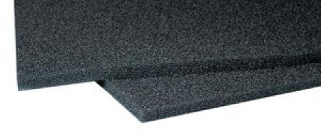

Hi, Calvin. MCM Electronics has two sizes of 1mm foam listed as speaker grilles. The material type is not listed, but I assume from its intended use that it is open cell. 31" x 17" and 26" x 23". How much foam do you need?
