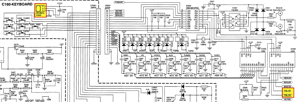

Hi there,
I woul be very thankfull if someone could help me with C160 schematic also.
I just got a problem with the remote controlled volume. It stops sometimes and I cannot figure out if theres a faulty stop command coming back from the servo/motor driver section. All other remote controlled functions works ok.
Your help is very much appreciated.
Br. Andy
Pre-amp remote giving me a hard time
I did some measurements, but cannot figure it out 😕
I measured +/- appr. 4 volts going to the motor as I push and hold down the up/down vol key on the remote controller, but it just suddently cuts the feed to the motor. Letting go and pressing the up/down key on the remote controller once again, it starts turning the motor again. Sometimes it can do a complete turn, but most often it stops several times during a complete revolution.
I re-soldered as much as I could accoording to the signal path.
I have two remotes that usually workes with the C160, and still works fine on my other NAD amp. (checking the vol up/down).
I've enclosed some screen shots of parts of the schematics, in case someone has a little spare time 🙄
Thank you fellow DIY.
Best regards,
Andy
