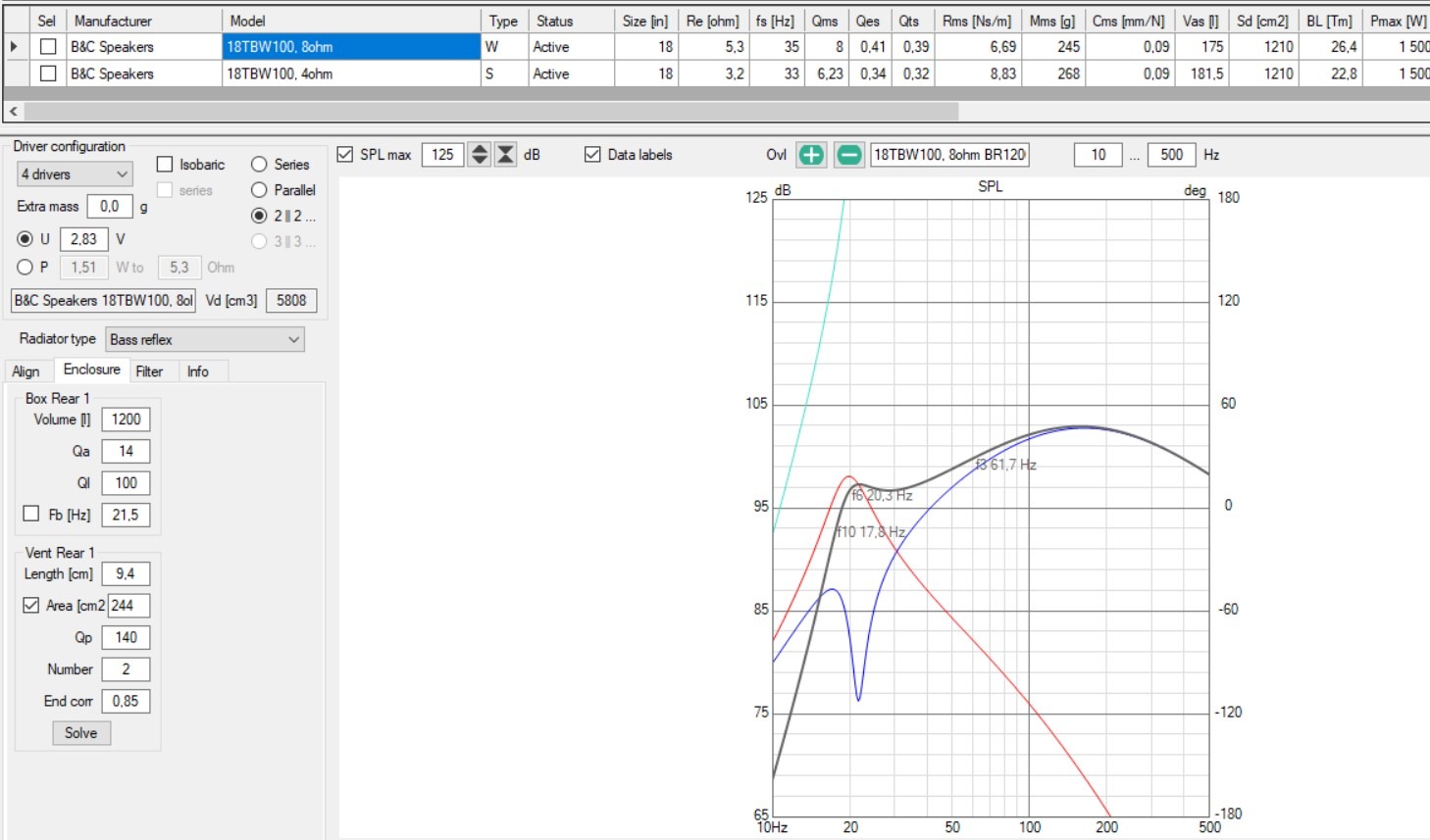

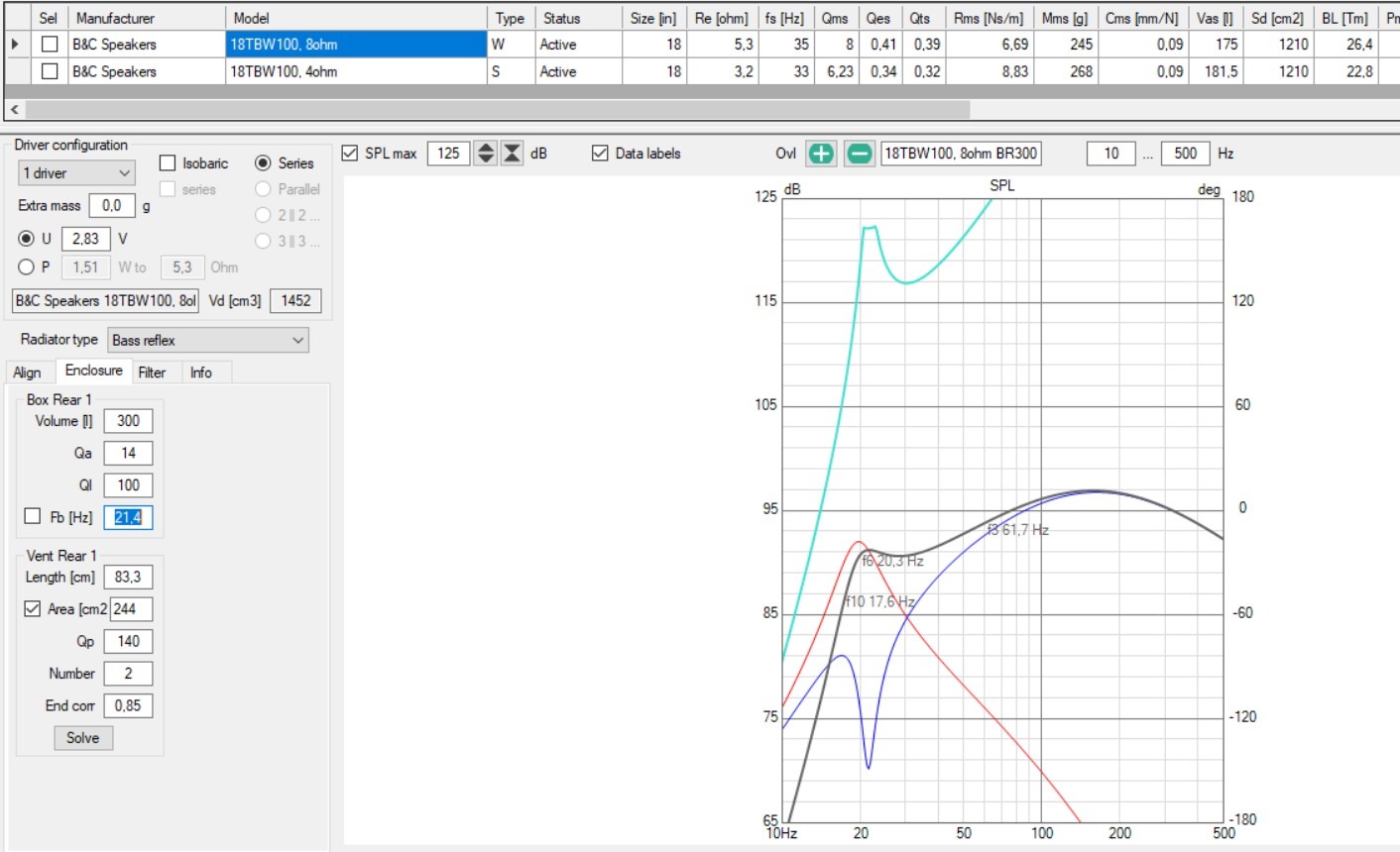

Yep, to maintain sensitivity you have at 100Hz all the way down to 20Hz, assuming direct radiating system, you'd need (100/20)^2 of volume displacement, 25x what you have now. So if you have 15" low mid, it's got about 850cm2 cone area, so you'd need about 21000cm2 worth subs assuming it has to be same excursion. If you can double excursion on subs you could slash cone area in half to maintain volume displacement, ~10000cm2. Perhaps you can slash it further by bass reflex or some other resonator. Nevertheless the system gets quite big, 10000cm2 is about 8x 18", so perhaps you can relax on the sensitivity requirement to keep it manageable size and cost, and use power and long excursion drivers to get some output at 20Hz, perhaps just one good 18" in big box and amp.
Example using relatively cheap B&C 18TBW100 in 300litre reflex box could give about 90db / 1W / 1m sensitivity and max about ~110db at 20Hz before excursion limit. If you need more max output you must use driver with more xmax, or multiple drivers to keep on increasing the volume displacement. To make a ~96db / 1W / 1m system you need four drivers and 1200litre enclosure. To get 99db would need few more and bit more size.
But, if you have enough power available perhaps the sensitivity doesn't matter that much and if the driver can take some power, you could reduce box size. Or, perhaps you don't actually need 20Hz extension but 25Hz, or 30Hz, and the system gets even smaller and cheaper.
So, be sure what your requirements actually have to be and then try to find a way that is suitable compromise to with your expectations, between output capacity, extension, size and cost.
