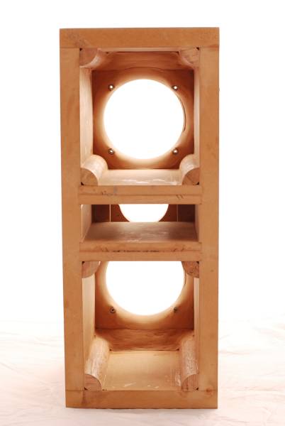

Hi Moondog, I did it too. But my build was an MTM so it was easy to make three separate compartments, one for each driver. I figured that splitting the box in three was good from a bracing point of view as well. I haven't even screwed the tweeters in they are just a press fit.... I must get around to doing that one day 🙄
Tony.

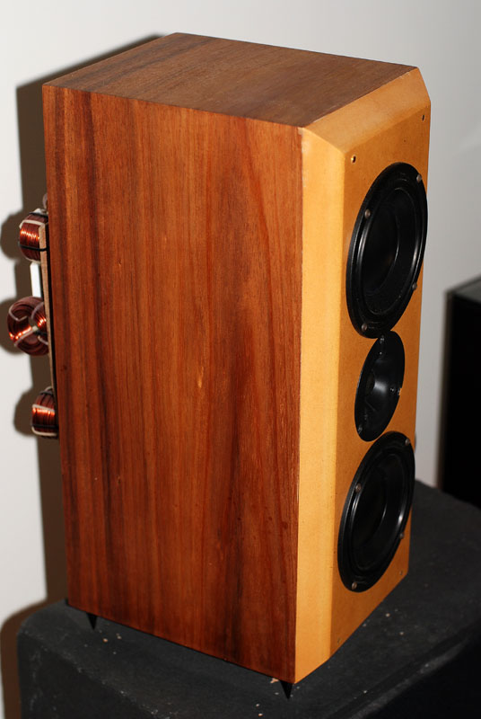

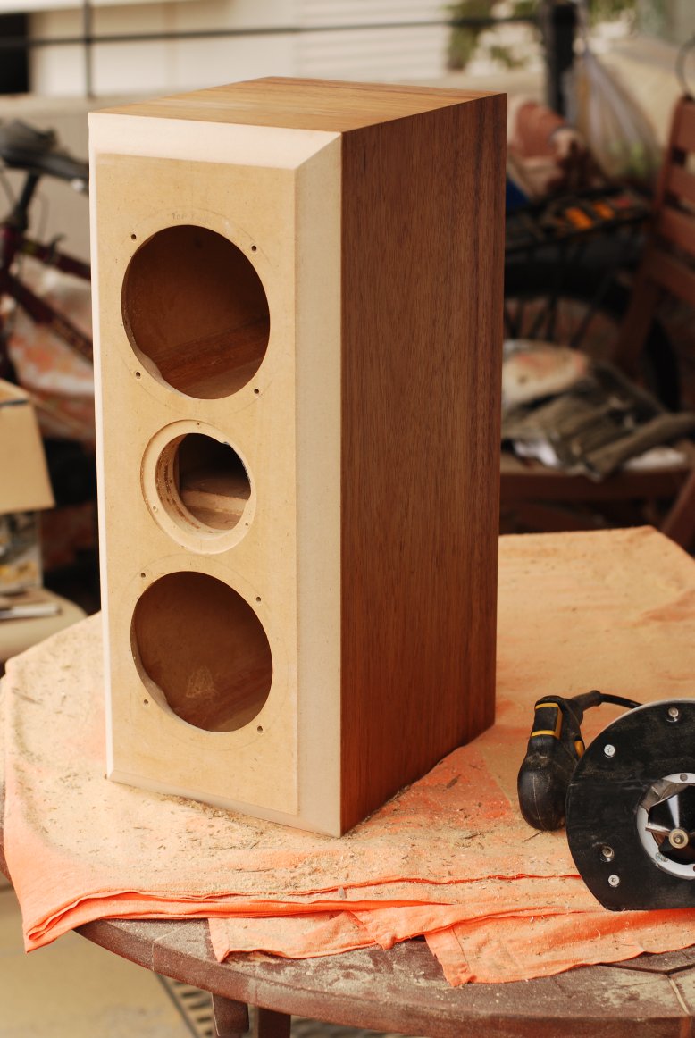

Nice grain in the wood sides Tony, veneer?
I used hardwood marine ply for the baffle and plain MDF for the sides, they will be painted to match the walls in the bedroom and so almost disappear.
