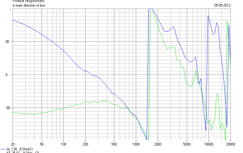

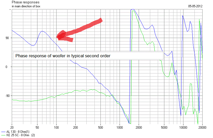

"Reversal of phase" (+90º) at tuning frequency can be observed on a typical vented enclosure (BR) and phase linearity with the closed enclosure. (Vented in red.)
