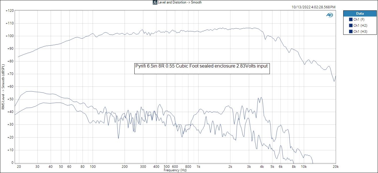

Are you using active crossovers? If not , very low crossover points become difficult and impractical if passive filters are used. There are a lot of design considerations here like diffraction step correction. A 2.5 way can be tricky, it's easy to end up with too much bass output. Generally speaking, a sealed box will ( in theory) give more clarity in the midrange than letting it reproduce low bass.
FR graph looks great! (So does the THD) 👍🏻My preference is a sealed 2-way pair of speakers with a shared subwoofer. AKA 2.1
Yes it’s a 3 channel hypex. I suspect without DSP it’s not easy. I don’t know where the addition of second woofer will take F3 or overall bass below 100-120 Hz, but I’m sure, with 4 x 12 inch sealed woofer playing in this room will be bombastic (pun intended…). I’ll have the deal down a lot off bass below 50-120 I assume…Are you using active crossovers?
Okay, you will have a lot of control over slope rate, XP points and overall freq response, so it really comes down to your 1st question which was if a sealed enclosure would be better for a clearer midrange. So if you have 3 channels, why not treat your " upper " woofers like a proper midrange in a sealed cavity and crossover at 250 or so. Am I correct in assuming you have 3 channels to play with?
