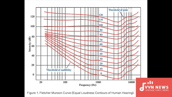

You throw out Fletcher Munson with no rational for what you're trying to say. The lowest note on a six string bass guitar is 31 Hz, so it's the reason people tune ports that low. It would appear to me that according to that curve the ear would be more sensitive to a drop in bass level than it is in the midrange. According to Fletcher Munson, see the graph below, a 30 Hz tone at 90 dB only has to drop 25 dB down to 65 dB to become inaudible. So the modulation of the note amplitude by a ported speaker should be obvious. Thanks for finding evidence to support my position. Bass guitar notes are percussive plucked note with an instant attack and an exponential decay. The tone burst like attack, the first most impactful cycles, get crushed by a ported speaker that takes several cycles to come up to level.

Equal loudness contours show how people of average hearing respond to continuous sine waves, they do not show how long it takes to perceive them.According to Fletcher Munson, see the graph below, a 30 Hz tone at 90 dB only has to drop 25 dB down to 65 dB to become inaudible. So the modulation of the note amplitude by a ported speaker should be obvious.
They do show that at ~30Hz, a difference of only 5dB sounds twice as loud, the port response can easily increase level by that or more around Fb.

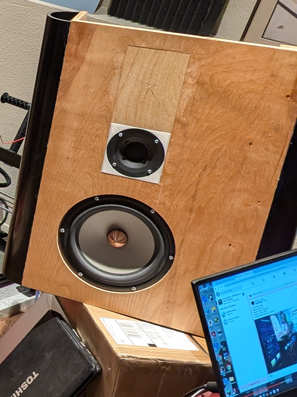

Grimm Audio builds technically advanced and highly regarded studio monitors. As I can't afford a pair of the LS1 speakers, I recently mocked them up using a baffle with similar dimensions loaded with the commercially available versions of the SEAS drivers they use. While my prototype is an ugly hack jobs based on the left overs from a previous build, they sound amazing. The woofer is in a sealed box.
