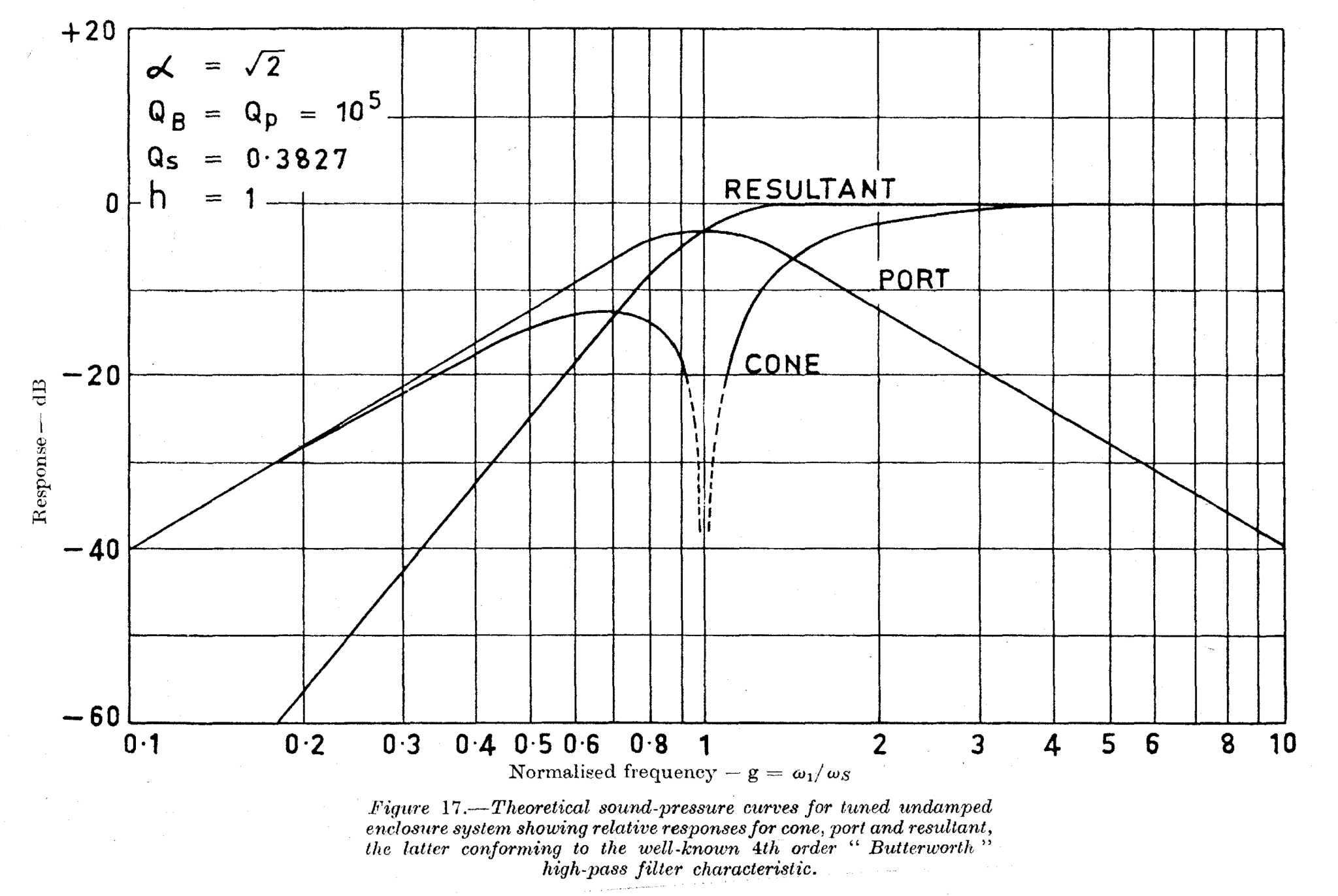

The following plot, taken from Small (1973), shows the step response of many different vented-box low-frequency alignments. For the popular QB3 and B4 alignments, the sound pressure response of the system dies away very quickly, even though it "doesn't stop immediately".
If the woofer is not moving much at the box tuning frequency, Fb, then how can the woofer contribute much at all to the sound pressure output?So the initial transient output from a ported speaker is only what the woofer contributes.
Referring to the previous step response plots, how is it possible for the system response to rise and then decay away within about 2 cycles if it is taking the port "a few cycles to produce its full output"?The port takes a few cycles to produce its full output.
If we have an input signal whose frequency content is centred on the port tuning frequency, Fb, then how is it possible to get much sound pressure output from the woofer when its motion is at a minimum? Wouldn't it instead be the case that when there is no woofer motion, then there is no sound pressure output from the woofer? Hence, subtracting the port output from the total response would leave only a very low sound pressure output from the woofer, wouldn't it?To see the initial first cycle transient response, subtract the port output.
Benson (1969), in his journal paper Theory and Design of Loudspeaker Enclosures, has studied this and has produced the following plot of the individual contributions of the port and the driver to the total response.

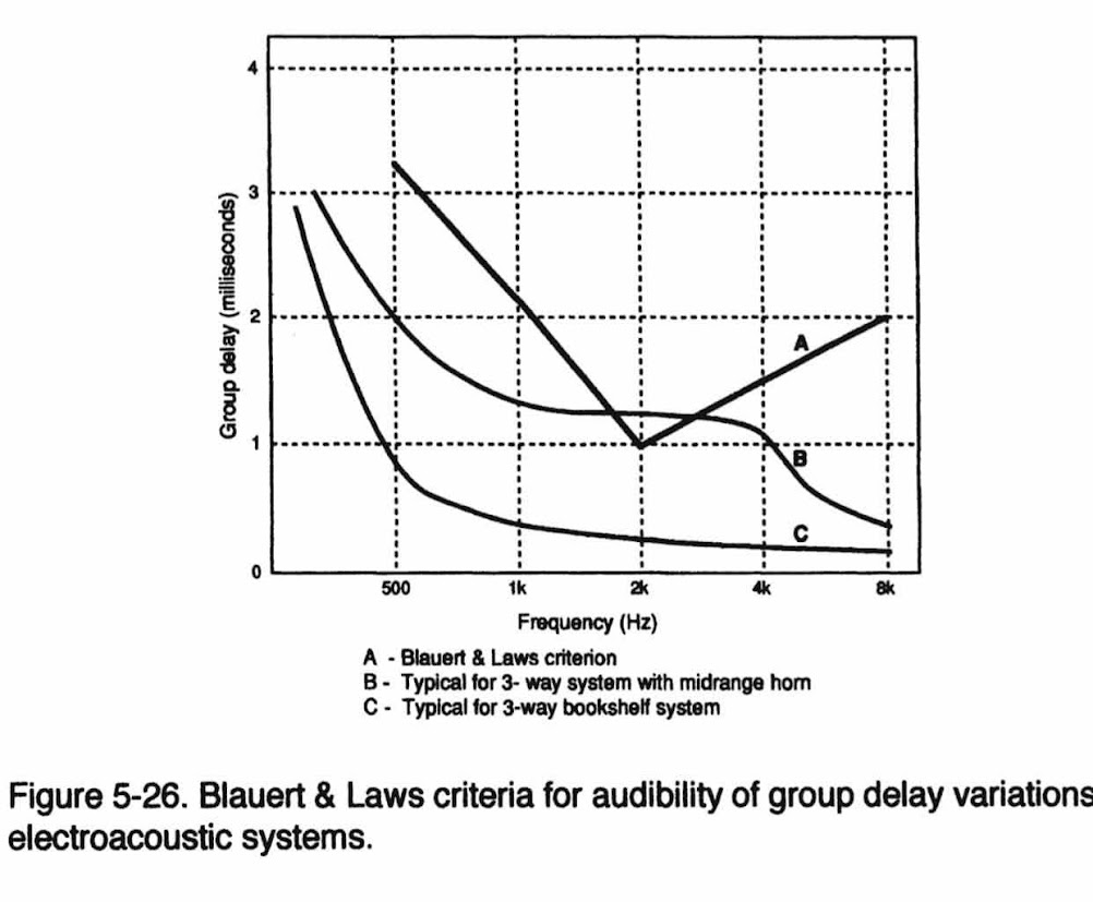

Figure 5-26 Graphs what I think is a threshold for audibility of group delay. I haven't tested if I can hear it at this level. Using WinISD I was able to produce a vented system that had group delay less than several times that threshold value. See the graph below.
Figure 2. Blue: Group delay of a 10" woofer in a ported system. Black: Blauert and Law's threshold for audibility.
I extrapolated the Blauert and Law's curve below the 300 Hz, so it's likely totally wrong. Other discussion at Audio Science Review I found discuss the audibility of a group delay equal to the time for one cycle. At 50 Hz, that would be 20 ms. I don't know what it should be. It is apparent to me that I can easily distinguish ported from sealed systems, likely due to the total absence of bass below the port frequency and likely the crushed transients in percussive or plucked rapidly decaying notes produced by the port.
Regarding the plots from the TS paper. You can see "a few cycles" of ringing in many of those. Some five cycle tone burst response plots or the response to a exponentially decaying plucked bass note would better illustrate my points. I will have to look at finding or generating those from an LTSpice model of a ported system I have someplace.
The frequency response graphs represent the output at steady state long after all the startup transients have subsided. So the system will produce that magnitude response after many cycles. The response of the first cycle doesn't look anything like that. My first description may not have been precise, saying "subtract the port output" . For the first cycle of a tone burst going to the woofer, at a frequency in the port resonance range, the woofer will essentially behave as if it were in a sealed box. The output of the port for that first cycle will be near zero. That's because the air mass in the port begins at a stand still and is coupled to the woofer by a spring. So that first cycle output will be what that woofer would produce nearly the same output as it would in a sealed box of that same size. The mass of air in the port, that has to move to produce port output is much like the mass of a passive radiator. It is coupled to the woofer by the spring formed by the air in the box between the port and the woofer. So think about two masses coupled by a spring. Move one mass slowly and the other lags and follows along in the same direction. Move the driven mass at the resonant frequency of the passive mass and spring system and after a cycle or two the masses will move in opposite directions, stretching and compressing the spring. That's what is happening in a ported or PR system. It is only after the port is resonating that it loads the woofer and impedes it's motion.

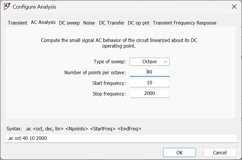

I have yet to find the actual LTSpice model, but I found notes from when I ran the model several years ago. I don't know what the the system alignment was.
LTSpice Software: M8N simulated acoustic response to 40 Hz tone. Fourth cycle is at full amplitude.
Vented Speaker Transient Response Simulation.

Please find attached a .zip file containing several LTSpice files for simulating different ported and sealed systems. There is also a .html file from the author that has descriptions of the different files. Looking through the notes on the different schematics you will find Spice directive text that you edit to change the Thiel Small parameters for the drivers, box volumes, port dimensions etc.
I added a file that models the very unique SpeakerLab 30 dual woofer design from parameters and crossover schematics I found for this speaker. It has a dual woofer, active hybrid radiator configuration, similar to a passive radiator, that was invented by Mila (Mioljub) Nestorovic. The speaker has an 8" woofer and a 10" woofer that through an novel crossover is made to operate similar to a passive radiator with customer adjustable parameters. Mila left behind no instructions, that I am aware of, for designing new speakers with his configuration, but with this model you can pretty quickly figure out what woofer parameters and crossover values are required to make it work.
I found these on the web eight years ago, posted October 12, 2005 by Ahmet Feyz Pirimoglu, pirimogl@hotmail.com I am uploading them here, as I find links found on these pages often don't work after a few years. You may be able to find the original site by searching for the authors name, that date and LTSpice yourself.
I have found that running speaker models using the freeware LTSpice is an excellent way to observe the behavior of different speaker designs. You can perform time domain simulations (Transient analysis) and frequency domain (AC analysis) with a few clicks of the mouse on your PC. It is easy to graph any value in the model: voltage, current, cone velocity, acoustic output etc.
Extrapolating Blauert's curve is not something you can do.
