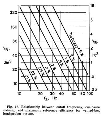

Based on Small's vented chart [attached], ~15 L is good for ~89 dB eff./~42 Hz, ~92 dB eff./~55 Hz, so will be interesting to know which you prefer 😉: Efficiency and sensitivity conversion - loudspeaker percent and dB per watt and meter loudspeaker efficiency versus sensitivity vs speaker sensitivity 1 watt = 2,83 volt box chart - sengpielaudio Sengpiel Berlin
