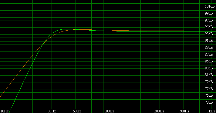

Guys
Here is the graph from WinISD...ORANGE line is with two lambda SB15 drivers, 390 liter box. (smaller box increased loss at 20hz and raised a peak in the 40-50Hz range and if I got even smaller, I lost more at 20Hz...go larger didnt do too much.
Thoughts on this graph? Figured between room gain and equalization, I can raise the 20 Hz -6dB loss. But I keep my sealed system with low group delay.
The GREEN line is a ported system using Lambda PB15, same size enclosure, tuned to 22Hz. I prefer the sealed.
you ever consdiered what you gonna do when all your room stuff resonates? bass traps and diffusers will be order of the day.
