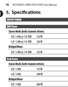

Here is a new dilemma. I was planning on using my Behringer A500 to power this sub. Unfortunately, it only offers a bridged-mono connection at 8ohms. The RSS315HF works at 4 ohms. That said, each stereo connection on the A500 outputs 230W at 4ohms. Will this be enough? Or should I just get a whole separate amp like the EP1500 (1400W at 4ohms) to power the sub?

The difference in peak output between the A500 power at 4 ohm stereo and bridged mono is only 3 dB (usually "kinda" noticeable), and may be less if only one side is used, as the power supply may deliver a bit more juice to one side driven FTB (technical term, full tilt boogie) than both sides FTB.The two separate subs also allows me to build only one right now and then build the other another time.
If you add a second sub with the amp you have, you will gain another 6 dB output over one, which is quite noticeably louder.
Build one sub, if that is not enough, build the second, if that is not enough , get a real sub amp 😉.
